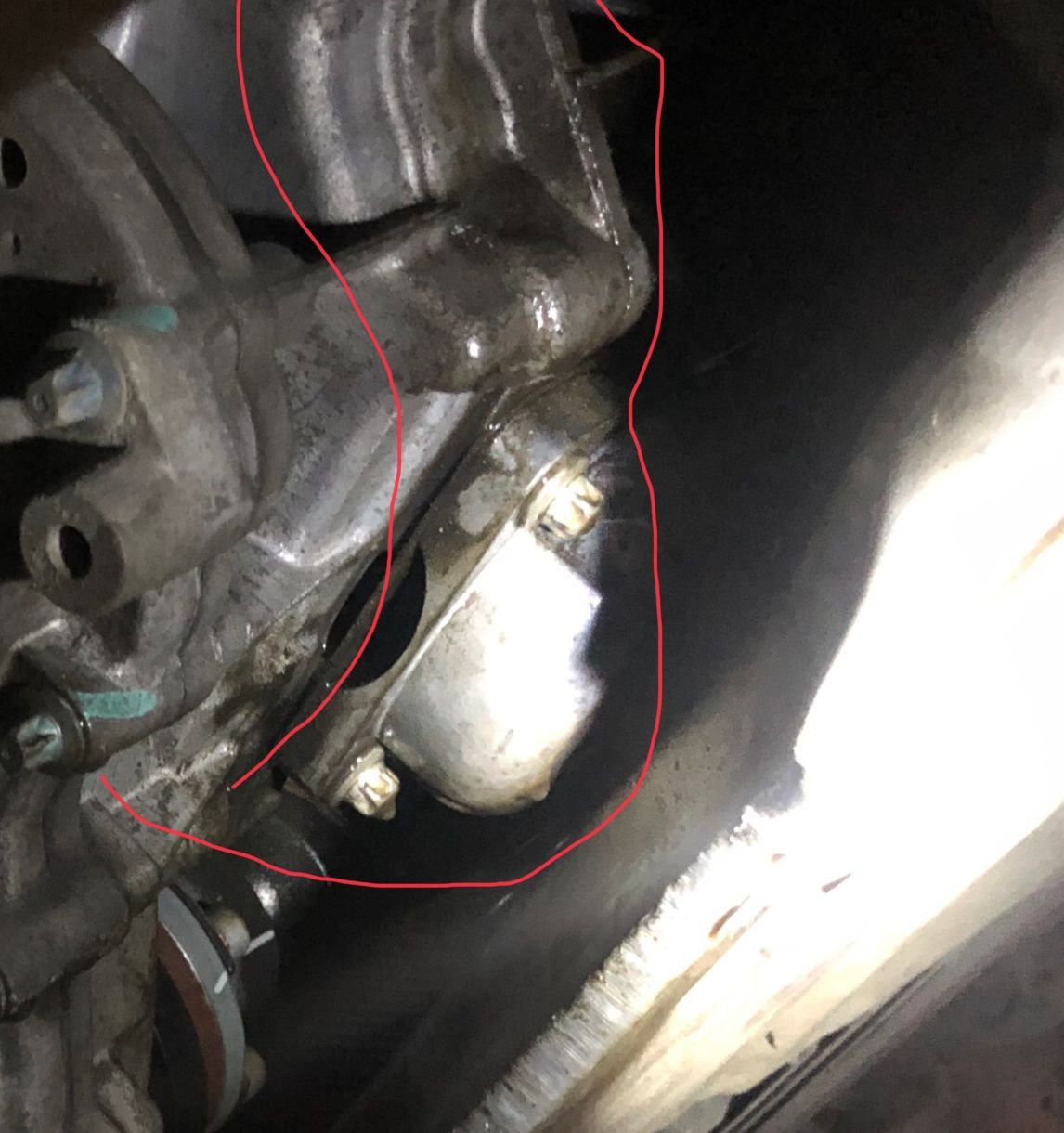

Hello again, and sorry for the late answare. Yes i post i picture of the leak.
Regards
Kim

Because the oil is clear color, it looks like driveline oil to me. Did you smell the oil? It seems like a large leak. What happened to the vehicle?

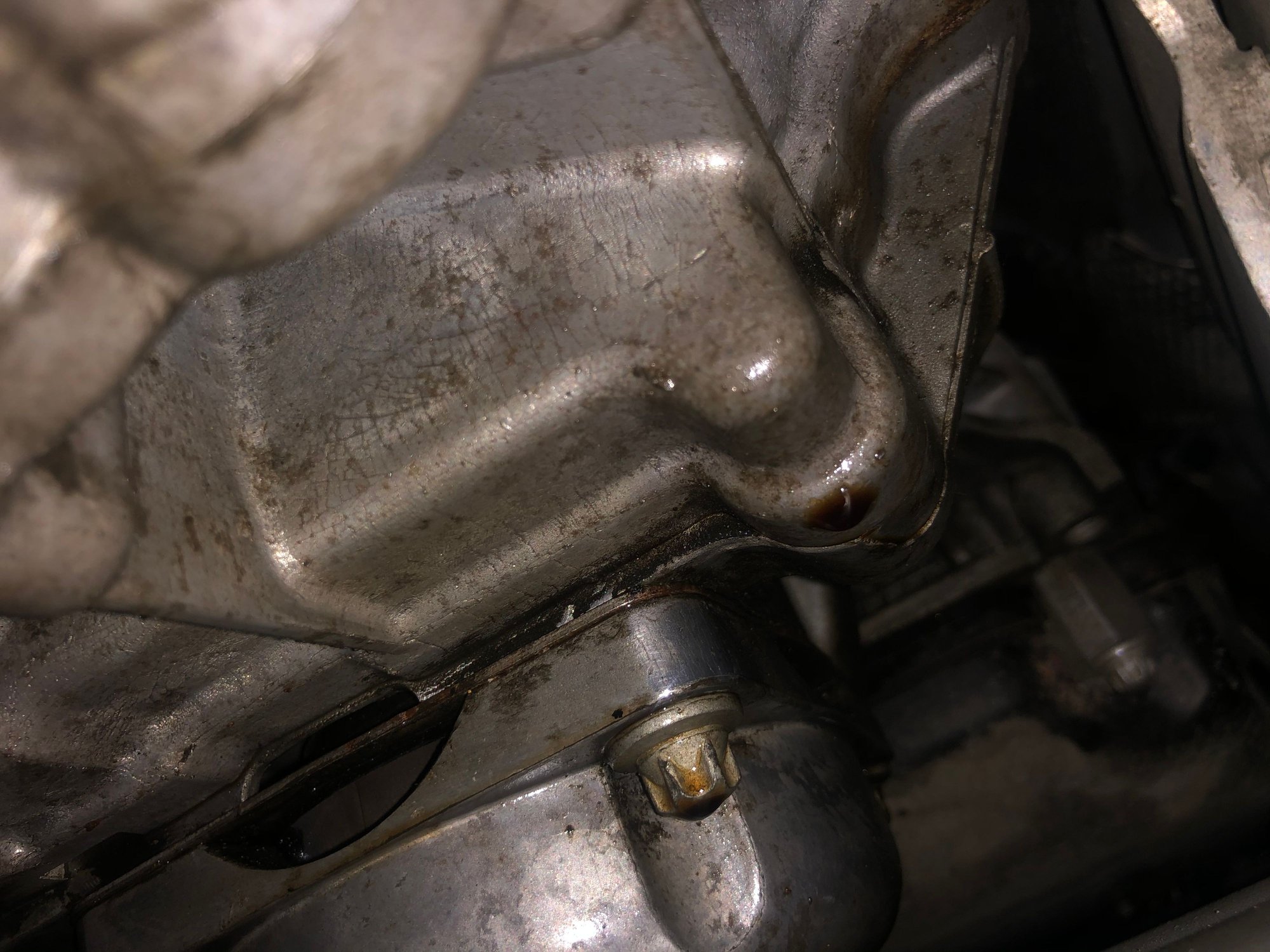

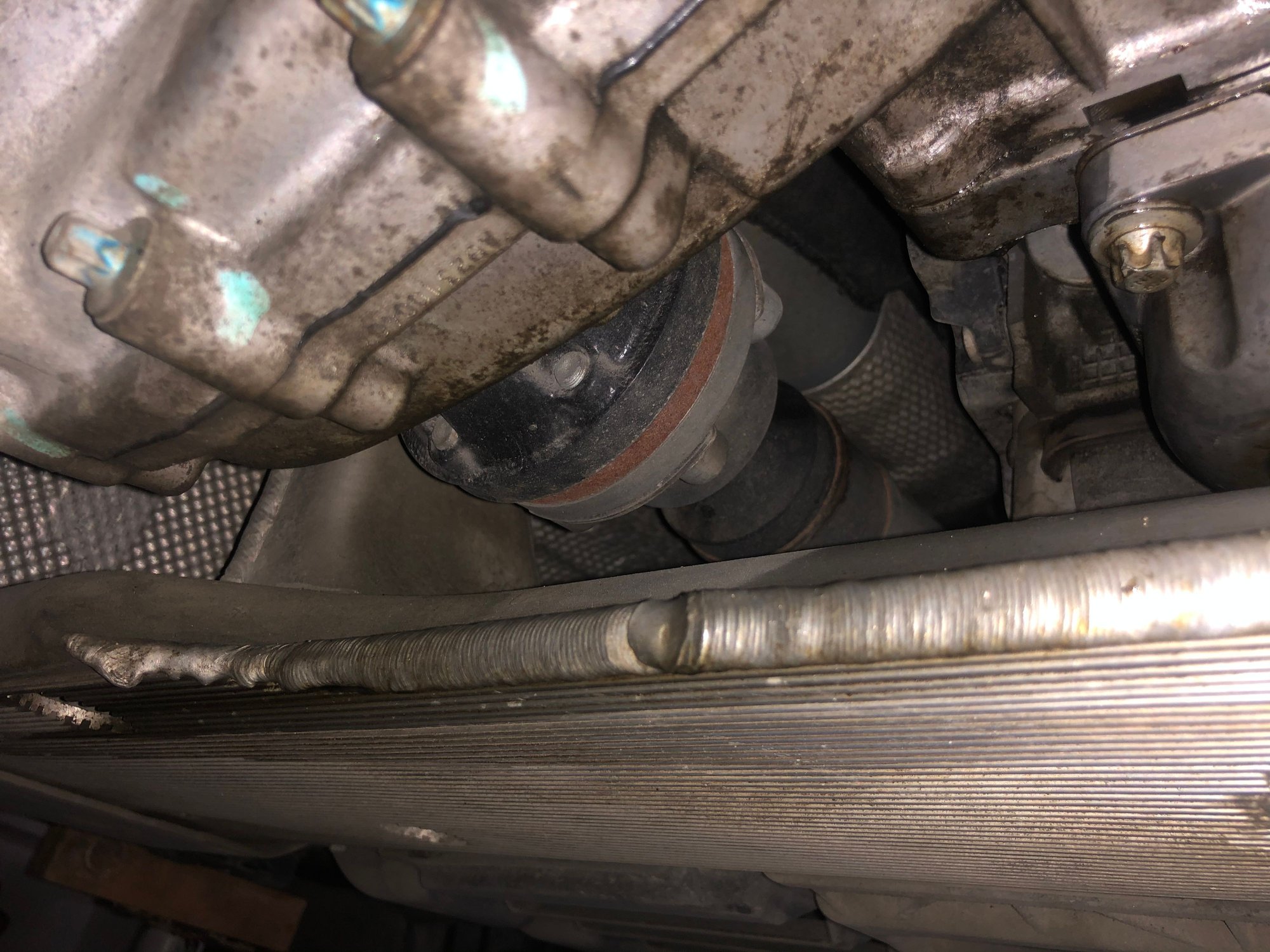

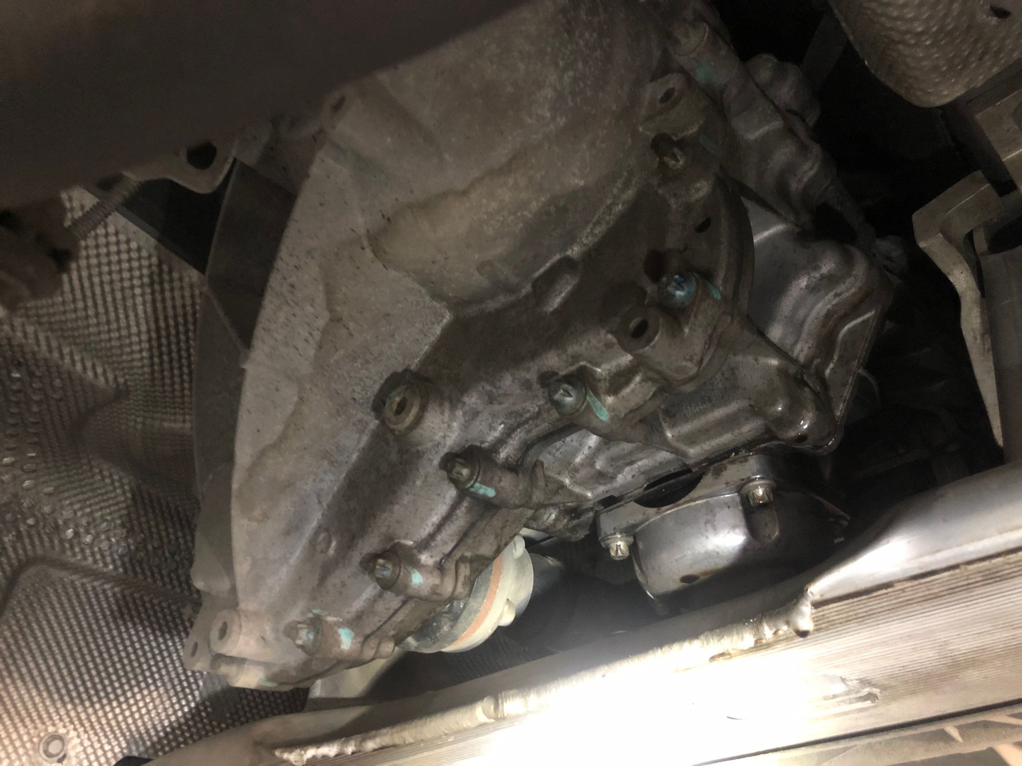

No, i dont think its simular to the other thread. My leak is at right side of transfer case, and 10 cm longer against front of the car, than that one in the other thread. My area around the driveshafts is completely dry, both rear going shaft, and front going shaft. I took some new pictures today. My meaning is that the oil seem to come from the rear of the automatic transmission oil pan.
Old Jun 14, 2020 | 09:44 AM
chassis's Avatar
Joined: Sep 2018
Posts: 14,679
Likes: 4,578
From: unbegrenzt
2017 GLE350 4MATIC
The photos are hard to interpret.
To me it looks like the oil is coming from the front propshaft seal.
If the fluid is clear, and does not have a strong smell, it is transfer case oil. Do you agree? What is your next step to confirm the diagnosis?
Addressing a leaking transfer case can be done by replacing the case with a rebuilt one, or resealing the unit you have. In both options, the transfer case needs to be removed.

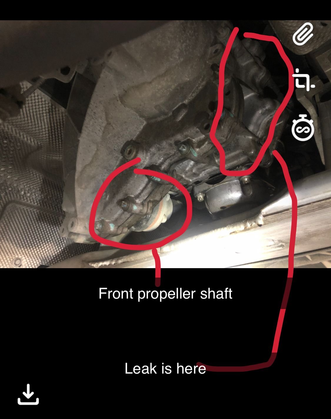

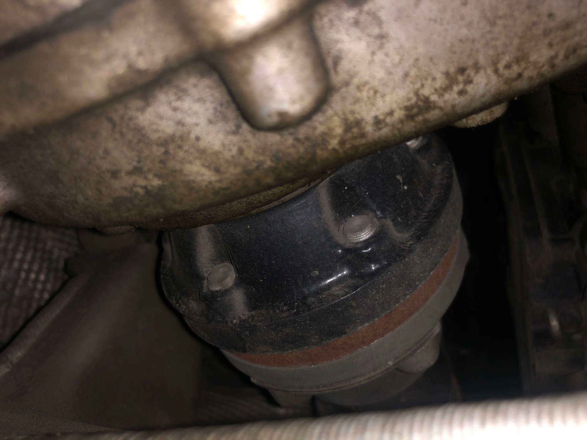

But the front propeller shaft is at the left side of the transfer case, the leak er at de other side of the case. I will drive to workshop, and let the find out what it is. I will update the thread when i got the answare😜 Anyway, here is a picture of the outgoing front propeller shaft from transfer case, no sign off leak her.

Old Jun 14, 2020 | 12:51 PM
chassis's Avatar
Joined: Sep 2018
Posts: 14,679
Likes: 4,578
From: unbegrenzt
2017 GLE350 4MATIC
OK, it's more clear after the last photo. Possible leak points are the dividing line between the transfer case castings, or the input shaft seal. Can you post a photo from the front of the transfer case showing the leak?
Old Jun 14, 2020 | 01:51 PM
kkarb's Avatar
Joined: Jan 2016
Posts: 121
Likes: 31
w164
Its hard to get a good photo from front, because the aluminium travers is covering it. But the input shaft seal, is a good sucpect👍 But erlier this year i serviced my automatic transmission. New oil, new filter, flushing and cleaning. Thats why i had misstake to the transmission.
