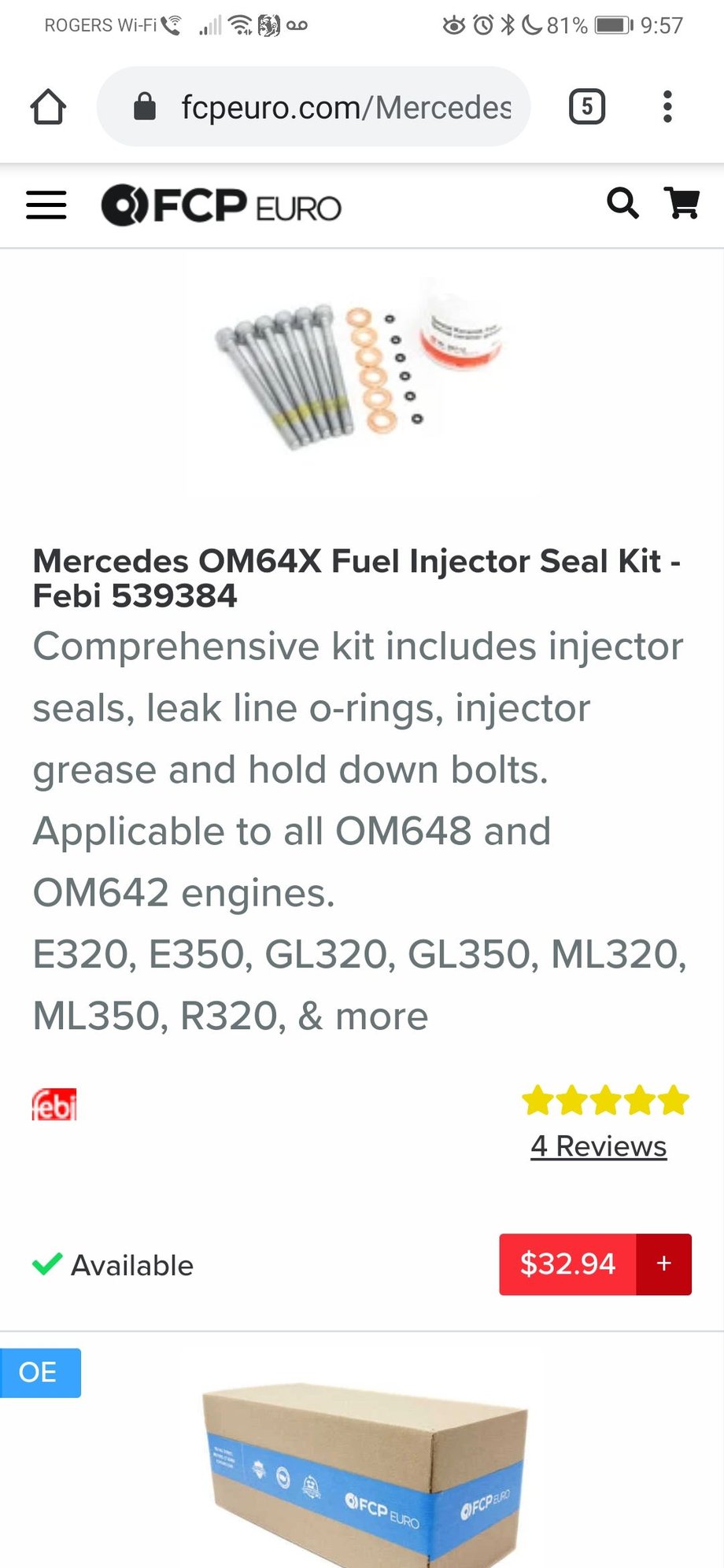

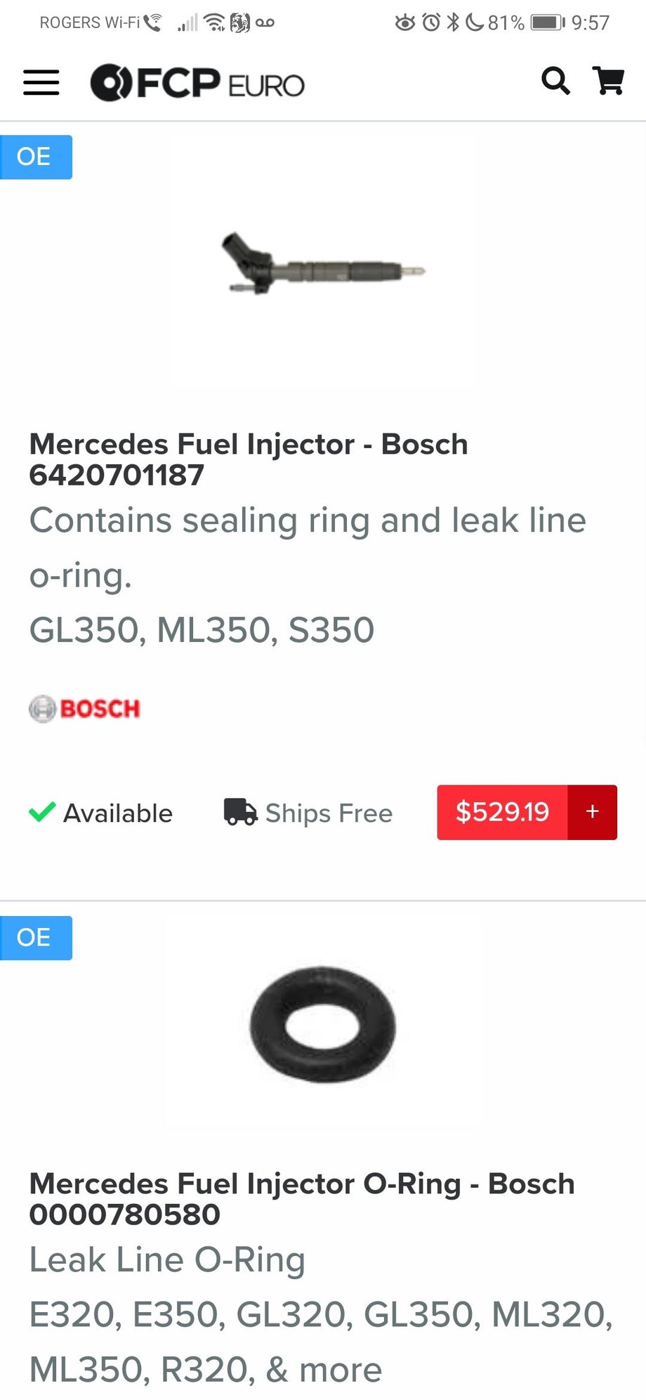

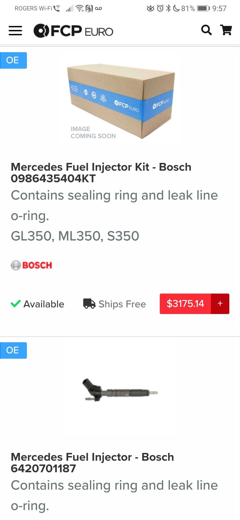

https://www.fcpeuro.com/Mercedes~Ben...words=injector
3.1k for parts if you want to replace all of them
Or replace one and trade the vehicle in
