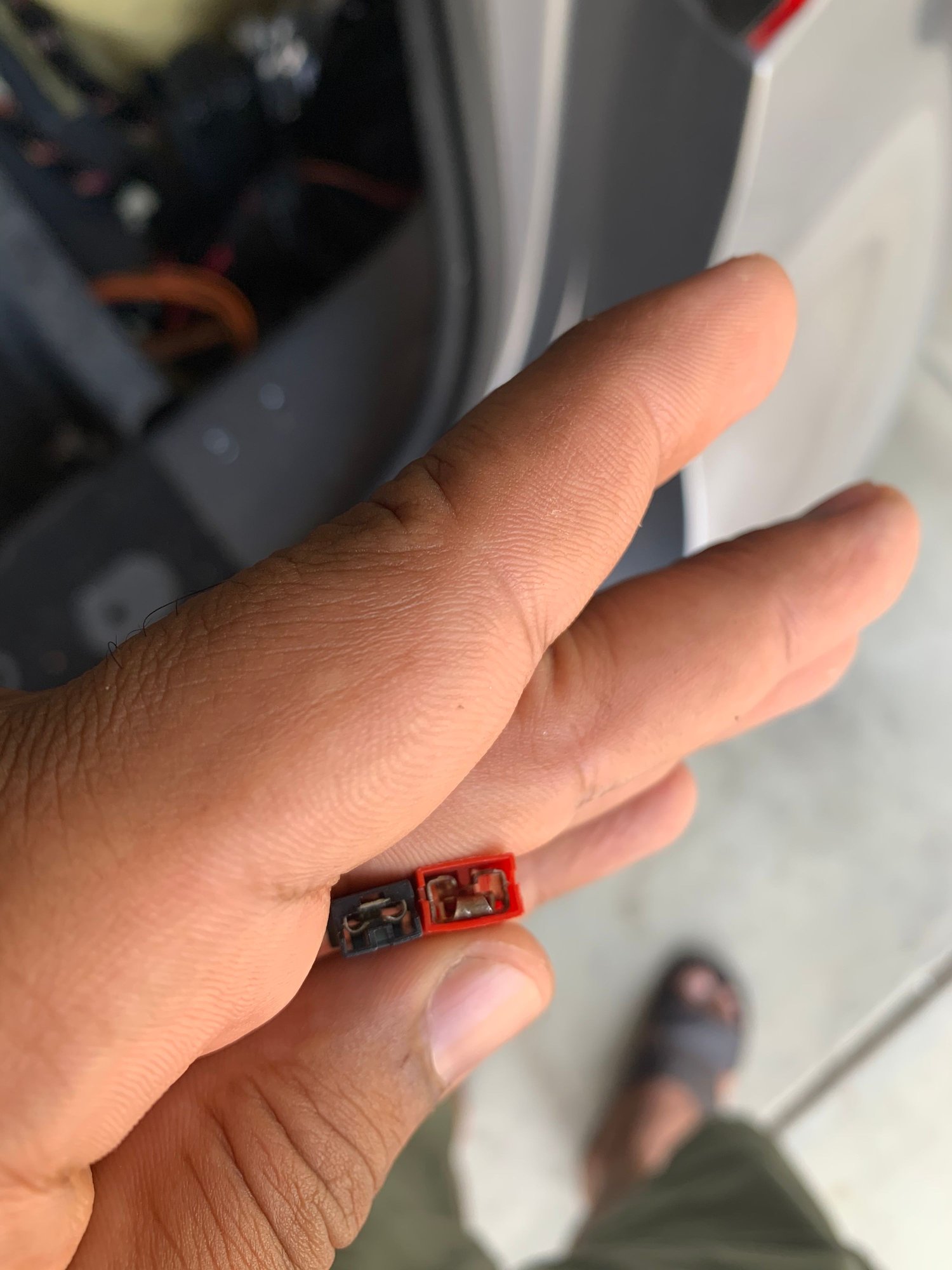

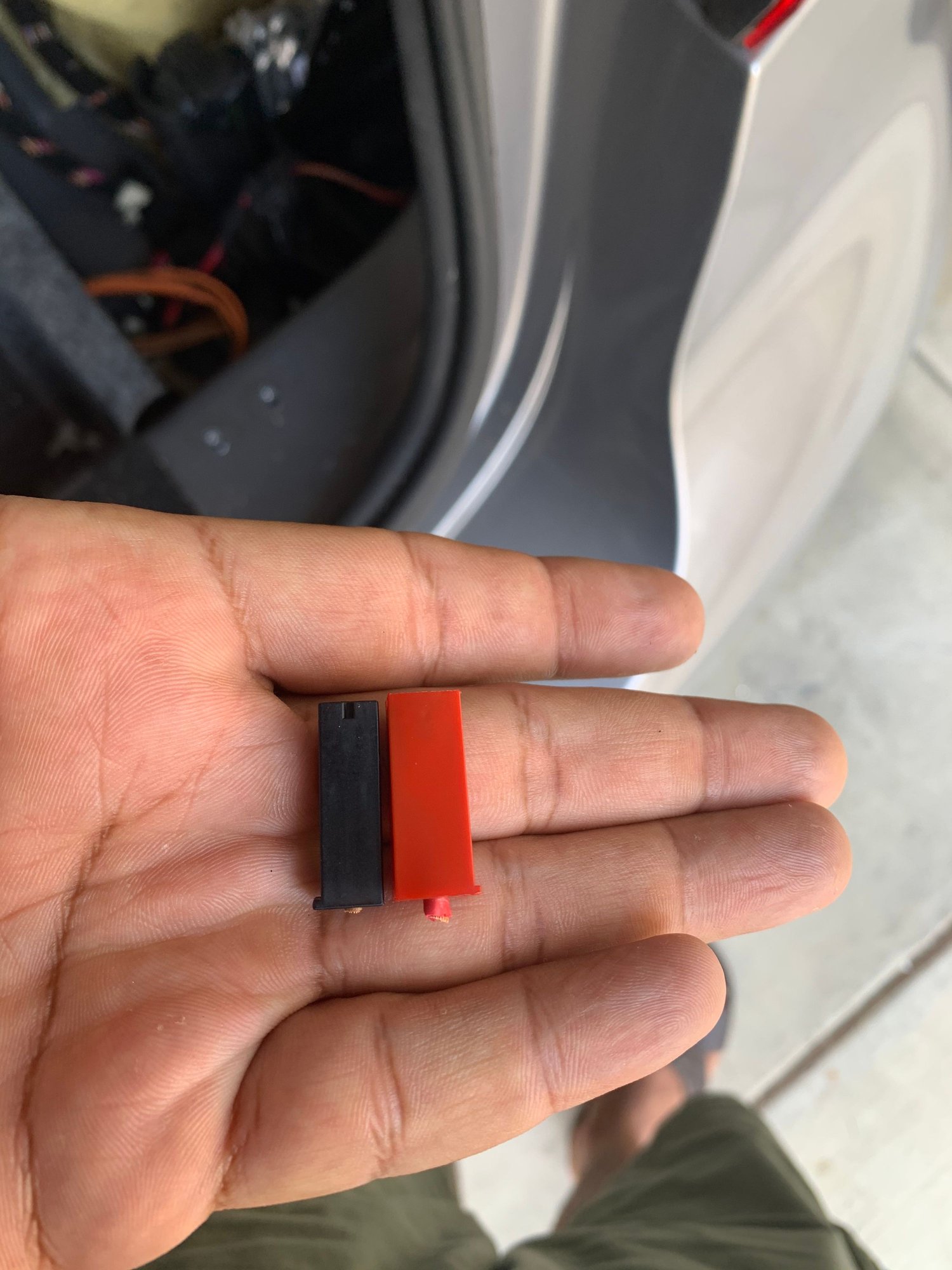

@immi08 Thanks. Can you post a photo of the quick connectors that you replaced, and describe the type of connector purchased and describe how the connectors were replaced? Thanks.
Here’s the pics.
I used the standard quick disconnect connectors. I don’t see how they would be any different. Stripped the end/ran the wires through The connectors and crimped them down.

Originally Posted by immi08
Here’s the pics.
@immi08 I would double and triple check the new connectors you added. Did you give a reason for needing to change them? Soldered joints are best practice for vibration-prone wiring.
