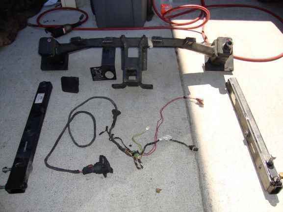

Just to answer your original question, a factory hitch is a lot more than an e-trailer bolt-on. In the box, it costs about $750, and it will cost around $2,500 with installation.
The reason is that it includes a rear SAM (Signal Acquisition Module - com puter) which integrates engine mapping, fault diagnosis, trailer light out in the instrument cluster, a tow mode, and many other electronic features.
In addition, and maybe most importantly, (and the reason for the high installation charge) is that a factory hitch includes internal chassis reinforcements to achieve the full 7,200 pound capacity, along with the ability to use a WDH (weight distributing hitch). Much of the rear of the car must be dismantled to install those internal reinforcements. When installed at the factory ($750 option) all those bits go on during production, so no R&R is required.
The takeaway - all the Bolt-On aftermarket hitches are not anchored well into the chassis, so towing a full sized load is questionable. The Curt hitches of the world are only safe for trays and bicycle racks.
Since you are only wanting to carry stuff on a rack, you'll be OK, but it's not advisable to use the hitch as you would a factory hitch.

Originally Posted by Koenig1
Wow, that's quite a statement!!! I'm sure you'll be able to provide reliable proof of this? I would hazard to guess that at least 50% of the vehicles with trailer hitches on the road today are 'aftermarket'! And, if you do find some proof of your statement, I would suspect a questionable install.... might be the 1st reason for failure.
There are plenty of threads on factory hitches, and the chassis reinforcements included, on this site. I'll let you do a search - I've been following this for over a decade.
Here's a picture of the complete hitch kit. Notice the arms toward the front of the picture - these are inserted into the chassis as reinforcement. Your aftermarket hitch doesn't have the whole package to achieve the tow rating that Mercedes assigns to the complete factory kit.
I don't think I'd be comfortable using a typical U-Haul wiring tap - that went out with CAN-BUS.
