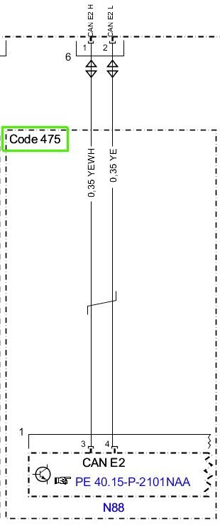

Which harness? From which point to which point? The sensors communicate wirelessly to the module. Module is item 10 in the diagram. Located near rear axle.

The Module 10 talks with the sensors on each tire wirelessly, but the module itself connects to a harness

The TPM module device N88 communicates via CAN, and via two way radio to the tire sensors. Diagram attached. What are you attempting to do? For what purpose is the information needed?

Excuse my ignorance in this area, but when you say it connects to CAN, what does that mean? In other words I will be ordering the hardware to retrofit this feature, what should I order in term of harness to be connected to CAN?

CAN is the Controller Area Network, standard for Mercedes and many cars. The TPMS controller needs to talk with the CAN bus. CAN via Xentry/DAS needs to add (code) the module as a recognized device.

@Hameed_W166 This is a big project. Are you a reseller?
Code 475 is the option code for tire pressure monitoring.
N88 connects via chassis CAN2 to the instrument cluster, device A1. It is also fed power from the battery prefuse box. Finally, it is grounded under the rear seat.
Device A1 is VIN specific.
You need tire pressure module N88 and it needs to be connected to chassis CAN2. The harness is a data connector, which I haven't found in WIS or EPC.
I recommend that you buy WIS/EPC from eBay. You will also need Xentry/DAS if you don't already have it. @BenzNinja on this site can help with Xentry.

i do have WIS/EPC and couldn’t find the harness as well, I might end up fabricating one once I get the socket/plug types.
i am not a reseller but I am doing two retrofits to my ML350, I started with Power Tailgate project where i purchased all necessary equipment, and was thinking of adding TPMS as well knowing that I will be stripping the carpet of the car anyway to pass power tailgate harness.
