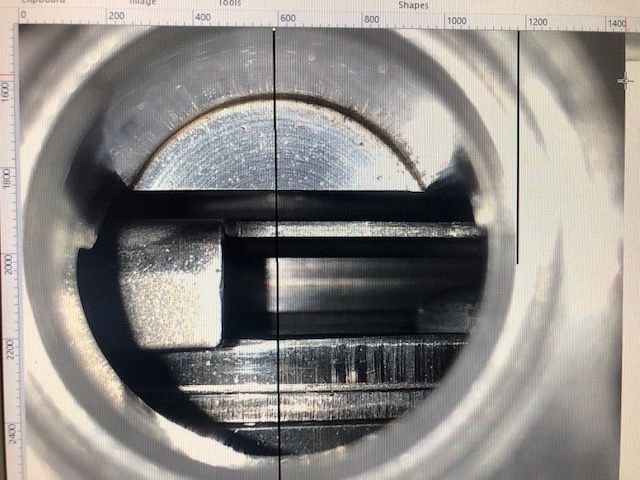

Update: Checked camshaft position sensors and camshaft solenoids. They are in shape.
I honestly didn't want to check the bottom end.
Instead I followed my instinct and went to the camshaft adjuster.
Here is the offender, intake camshaft adjuster on the passenger side:
As I don't feel comfortable paying $1000 on this piece, I sent it for regeneration. We'll see what happens in a week.
I would not either, and even worse if more than one adjuster is damaged, i.e. 4 x @1000. Is that price of 1000 for a new adjuster? I ask because the once listed by MB parts is remanufactured (whatever that means).. See https://mbparts.mbusa.com/oem-parts/...01bC12Ni1mbGV4
Not sure if you know there is a YouTuber named Tasos who sometimes flip the pin and reuse the adjuster.
I think that would only make any sense if the wear around the hole is minimal, but from your photo it is not, correct?
If the regeneration works for you, I am certain many in the Forums would love to know who you used for the work. Good luck.

UPDATE on my case:
So after finding out my intake camshaft adjuster on the passenger side is bad, I decided not to buy new one, but give it a try and rebuild it (Sorry Mercedes, you won't get my 800bucks ).
Two weeks later I got it back and went to reassembly. Many people are asking if this job can be done without removing the valve cover. YES, it can be done.
You just have to be CAREFUL and put marks on the chain and both adjusters. Then if you are replacing the adjuster, you have to copy paste the marks on the new one when doing reassembly. And yes, it is a tight job, but saves you a lot of work. Procedure is the same as the "chain tensioners", just the chain tensioner solenoid valve (torx 100) has to be loosen while the chain is in tension.
So adjuster rebuild, car reassembled. I start it and ... guess what, error code is still there Same error code, same camshaft is deviating from the crankshaft.
Many people told me it's the chain stretched or a sensor. BUT if you think logical, stretched chain would probably send error codes on both camshafts and at least make some noise.
I read that few people here replaced the camshaft as the last step. Decided to go by the procedure and check my timing:
There you go, same camshaft is off It was not much, 1-2mm probably. I guess those cars are more precise than I thought. Finally valve cover had to come off
Seems like the signal plate on the camshaft is twisting due to the rattle of the adjuster. The worst part is that if you have an early production car, you still can not be sure as there is no marks to check it. Later on, Mercedes realized about that issue and placed laser markings on the camshaft and the plate.
The good part is that if you are getting a replacement camshaft from a salvage yard (like I did ), you can figure out if it's in a good shape by checking on that markings. ( Sorry Mercedes, you missed my 800 bucks again ).
Car was reassembled, engine started and error code disappeared in 5 seconds. There was not even need to be cleared with Xentry.
PROBLEM SOLVED!!!

Originally Posted by Drive-Maniac
UPDATE on my case:
PROBLEM SOLVED!!!
Conclusion: If you get P0016xx or P0011xx code, it is ether one or all:
1.Chain tensioners
2.Camshaft adjuster
and if these don't solve your problem
3. Camshaft has to be replaced
Also about camshaft adjuster , I forgot to mention that I found a small company here in Europe that specializes in rebuilding and producing their own adjusters for BMW, Audi and Mercedes ( the ones that fail most). They gave me 2 year warranty and price was 1/3 of the price of a new unit. Well, we'll see how it goes...
https://mehenker.com/en/
