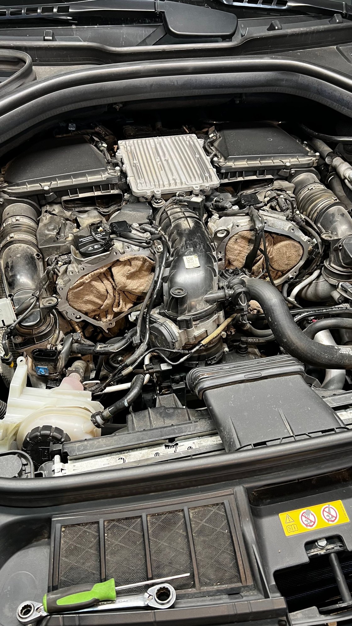

TIming Covers Leaking

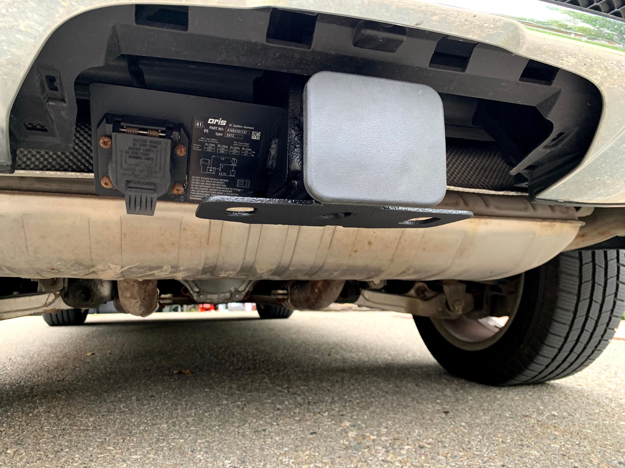

Rusty Trailer Hitch - Along with Missing Hitch Cover

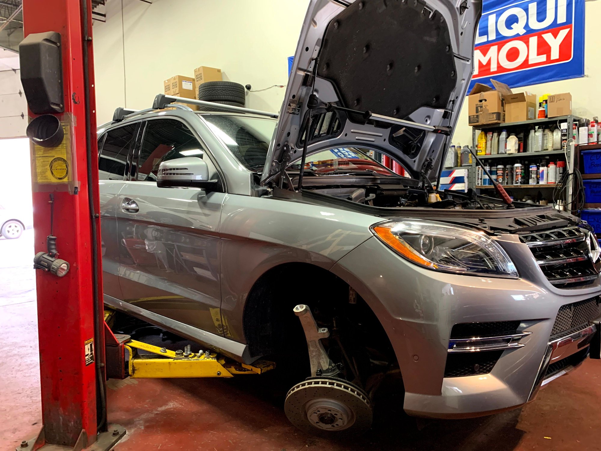

New Brakes all around and Oil Change to begin with. No photo
  • Akebono and Bosch Ceramic Pads were used, along with Zimmerman Rotors all around
  • 5W-40 Molygen and a Mann Filter I believe was used

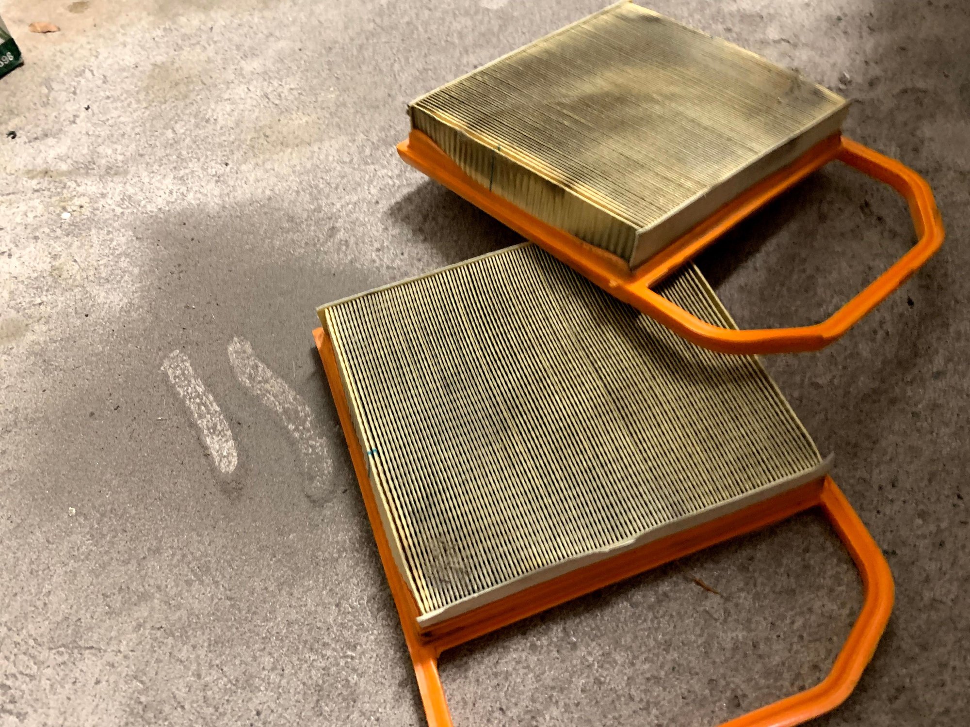

Next Filters, the date stamps are from 2015 and appear to be original to the car? Car was serviced at MB in the beginning of its life, surprised by that. Also new Cabin Air Filter, not pictured but new Hengst Blue.Care Filter, along with Pollen Filter. New Wipers and rear wiper I got for the 2010 was fitted, was just 4 weeks old.

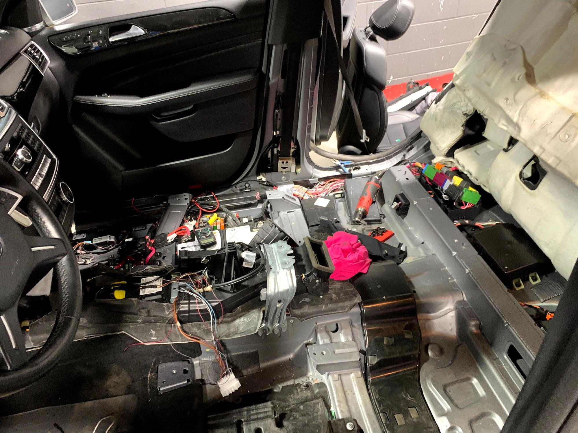

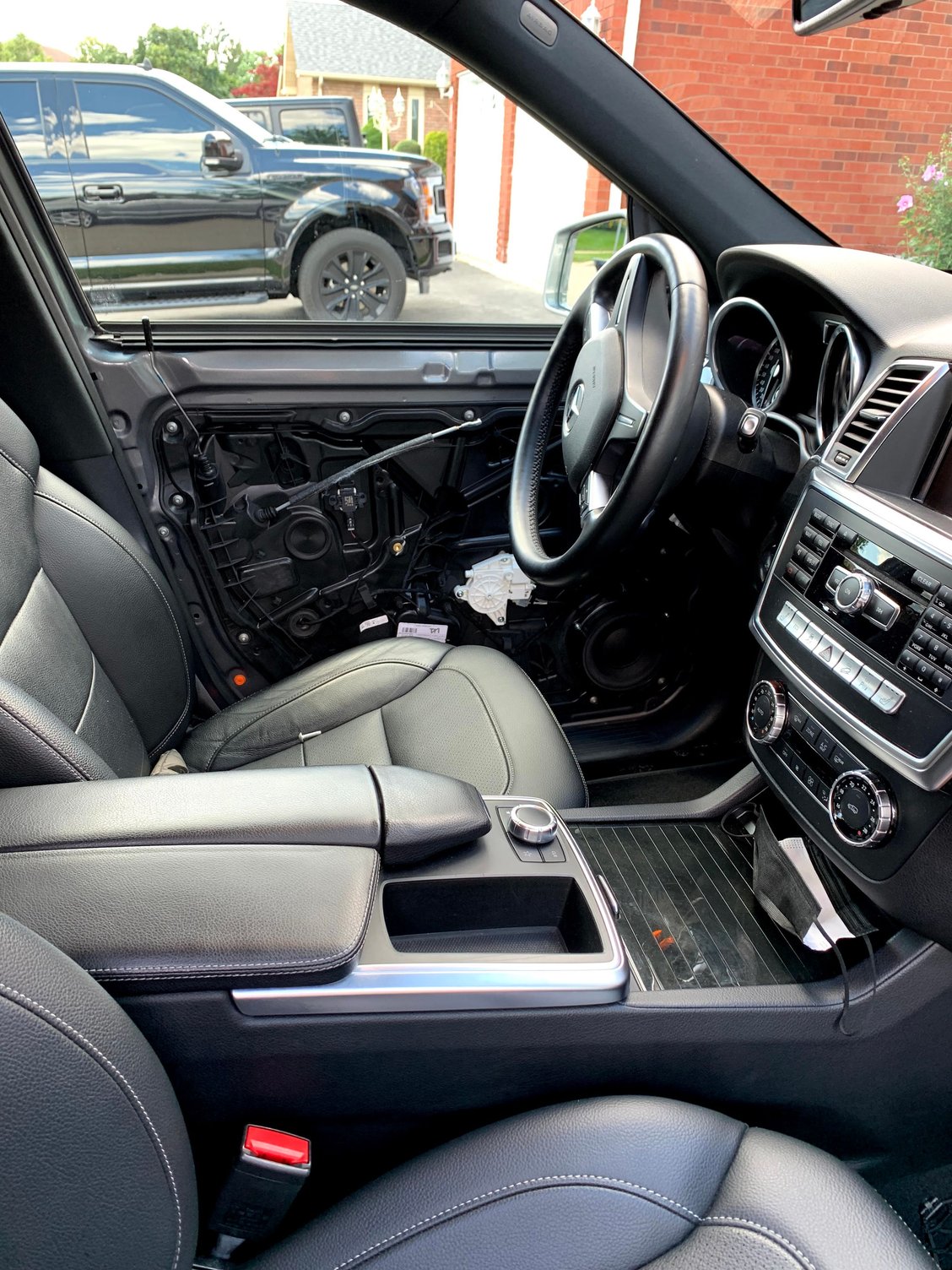

Next Command Knob, removed all the accessible aftermarket wiring and dropped the car off to MB House in North York (Toronto)
After two weeks, and a retrofit and accessories (more on this later) Car was reassembled. Aftermarket wiring installed with a mix of wrong fuses caused a list of issues with wires burning in the car and apparently could have caused a fire, are fixed now.

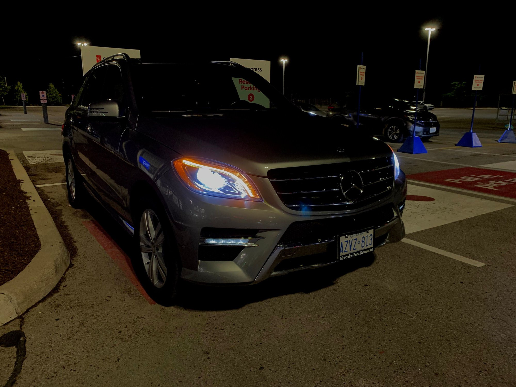

Next new Xenon Bulbs, the bulbs were fine, but were getting old. Manage to find a set on Facebook Marketplace for genuine Osram Xenerc Cool Blue Boost, after research and confirming that they're genuine they were fitted, and aren't too blue in realize, they're more white with a tad bit of blue. They're a lot whiter then the photo below! Do be alarmed!!!

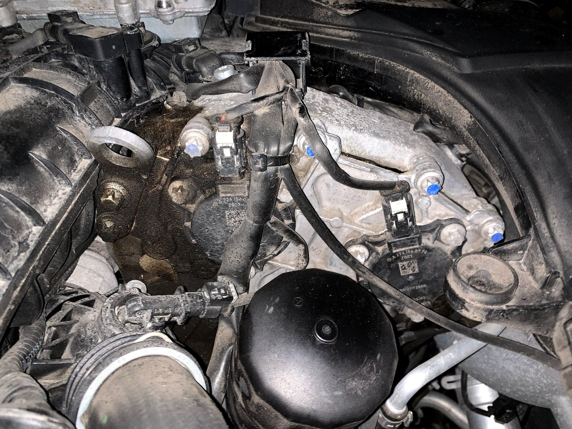

Front CV Axle along with Timing Covers, and Spark Plugs were done.

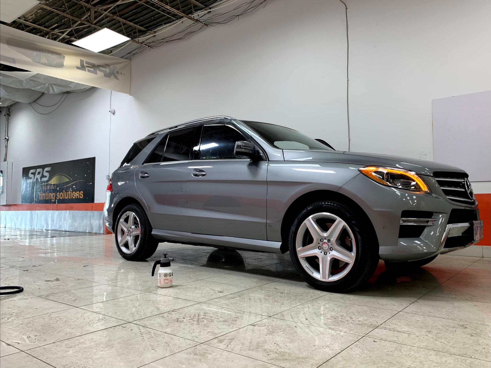

After shopping around for dent repair places and extensive research, I settled with Xpress Dent Repair in Mississauga, Ontario. Highly recommend them and did an amazing job. Yes, all the tape marks are dents, including the roof. Also New 20" Wheels. One needed refinishing - Leprecon Rim Repair. License Plate bracket is broken? Not sure how you can break it, but it is and still is broken. but I managed to just use the top holes for the rear lol.

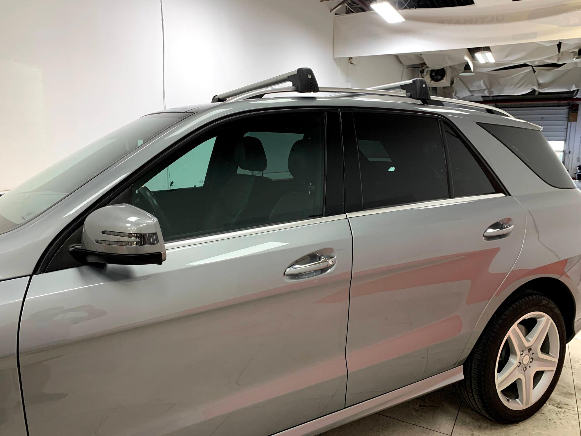

  • Retrofit Running Boards (Car is for my parents, so they need them)
  • ILS+ Coding
  • 20" AMG Style Wheels - Including the correct lug nuts

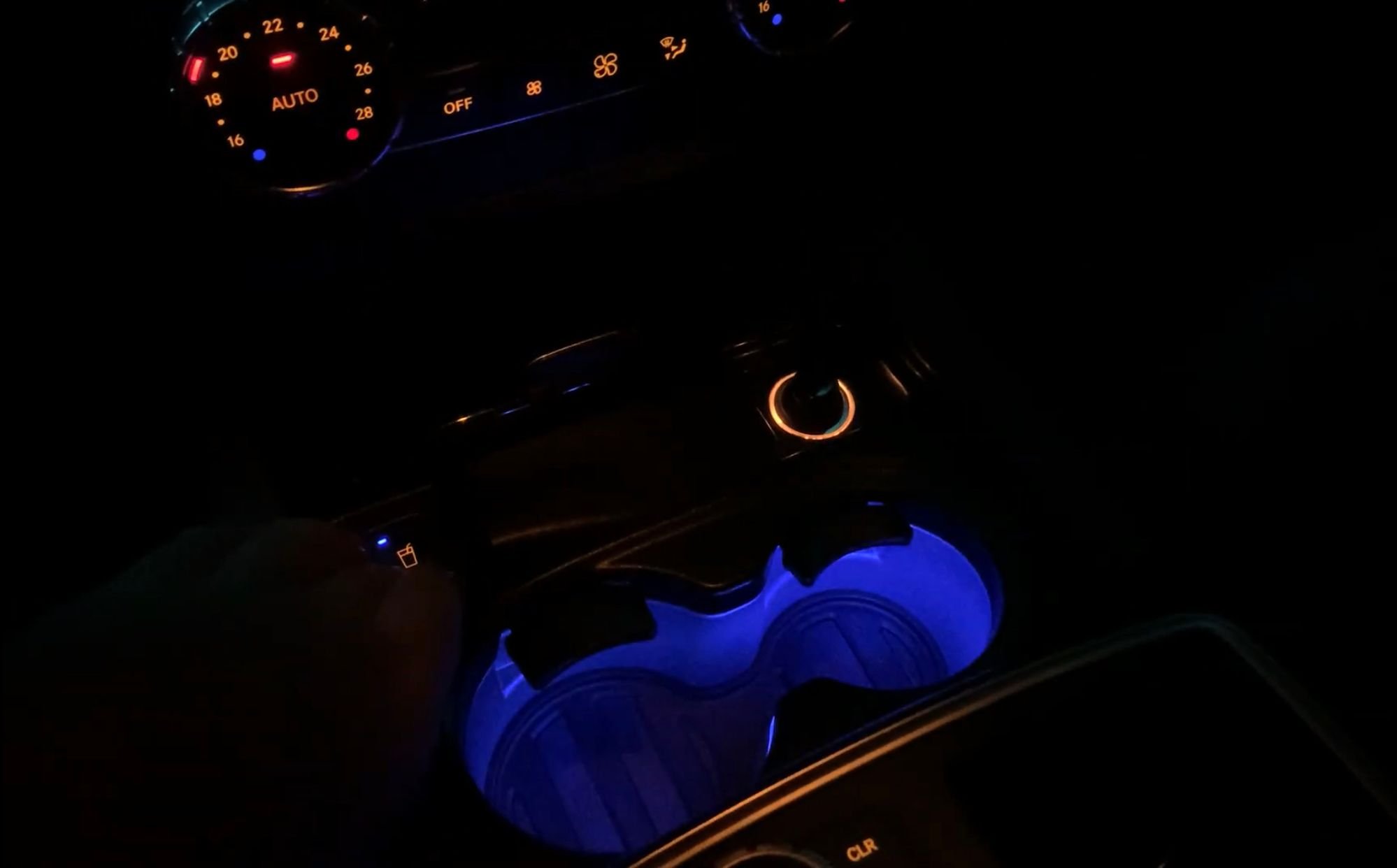

  • Retrofit Cooled Heated Cup Holder
  • Tint Front Windows
  • Winter Wheels
  • Coat Hanger Accessory
  • Roof Rack

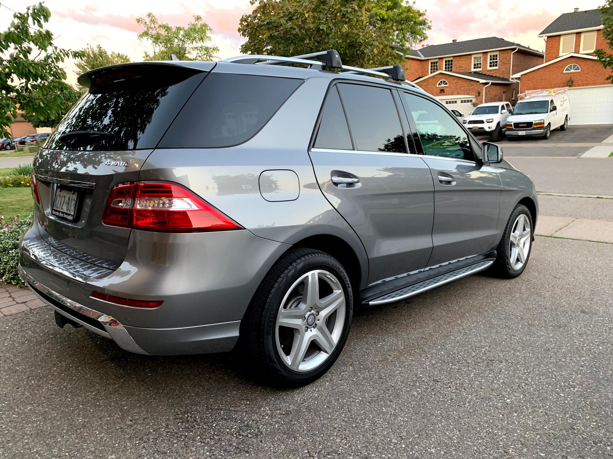

New to me wheels, in realtively good condition, other then one refinished when the car that came off them was CPO'd - Off a 2015 ML350 Bluetec totalled - Got a set of lugs nuts off a 2010 GLK - Which are the same to be fitted on install. Bled the brakes at the same time. - At MB for Brake Light Bulbs - went out.
Running boards, I went for genuine ones, used though. I bought two sets, one was a bit more in fair condition then how I would've liked them. So I bought a second set of used ones, somehow there were a few for sale, people who took them off when they sold the car and totalled in an accident - to put onto their new ML if they didn't have running boards. Ended up selling one of the pairs and broke even with the price of the other set and made a little bit $ actually. - Note, installing running boards is a bit of a pain, new jack points are needed, and being fragile with the screws on the bottom, some snapped from corrosion? and wrong angle of applying force, best to do when car is jacked up or on a lift.
Completed Paint Correction (Claying, Decontaminating, Compound, Polish) at some point before the running board install, along with Ceramic Coating the Car after all the dents were
fixed. Touched up chips with 792 Palladium Silver. Along with Carpet Extraction and polishing wood trim a bit. Picked up a used set of roof racks for $200-250 with Ski Racks as well. Came off a ML350 Bluetec that was used minimally, owner had an ML that was leased - employee of MB

Retrofitted Cup Holders, they are not plug and play. Vedamio Coding and new wiring harness is needed to my knowledge. ILS+ is coded in and the low beam sits a bit higher, with Motorway Mode as well, just makes it that much more enjoyable to drive. No matrix lighting occurs with the Xenon ILS but can still be appreciated, The headlights swing and move more freely than before. There is also a Menu in the dash now for Intelli. Light System. Typing in Motion for Nav was also enabled.

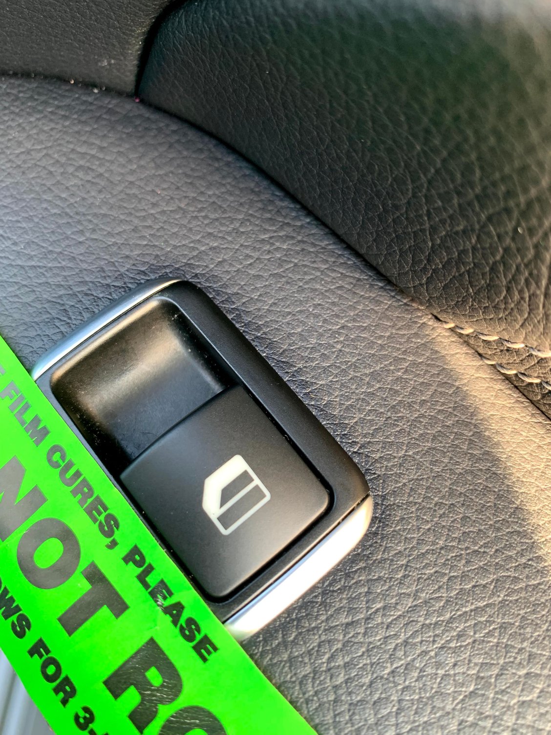

Front Windows were tinted with 55% Xpel Ultimate - Ceramic Film - Parents did not want it too dark - It by no means matches the rear, and im okay with that. Button Peeling happened, had to buy one new switch because of the tape. sigh.

Enjoying the car for the summer, drove a decent distance with the car. - Purchased the Genuine Mercedes Roof Box for $125CAD - I had to use it, so I booked a campsite up north.
Small Time gap between these photos
Winter is about to arrive at this point - This Project started in May
It's the end of October now.
Snagged a set of OEM Winter Wheel Package Wheels for $500 - Shreud Negation - and got a set of Bridgestone DM-V2's used but with 10/32nds or so for $450? Before and After cleaning, Lacquer Thinner helps remove stubborn yellowed stains
I'm sure I'm missing some things - Will make an additional post later on.
But here is the end for now, Car has seen an interesting past, but here we are at the end, it's looking like a well rounded 2015 ML400 once again. A bit more KM on the clock, but ready for more.

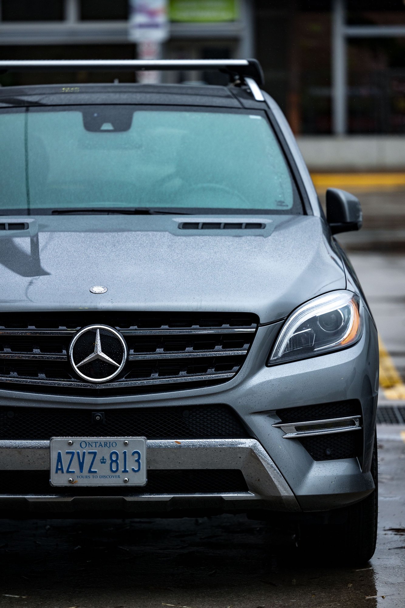

Decided to put on new tires, Pirelli Scorpion Verde All Season Plus 3 and did an alignment. The alignment is always a-bit finicky for some reason. The old pirellis were basically finished so it was very much time to have a fresh set. Still have two good MO Pirelli’s though at 8/32nds if anyone is interested in buying them.
Washed; to a certain degree, touched up some stone chips on the front end and shall be sending it back off to my folks.
but nevertheless it’s done. for now…
