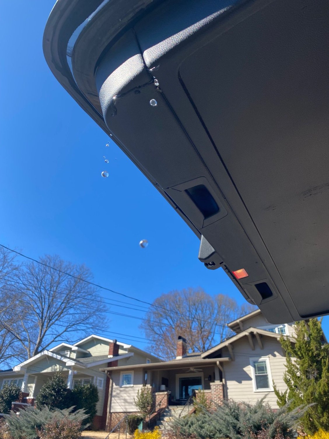

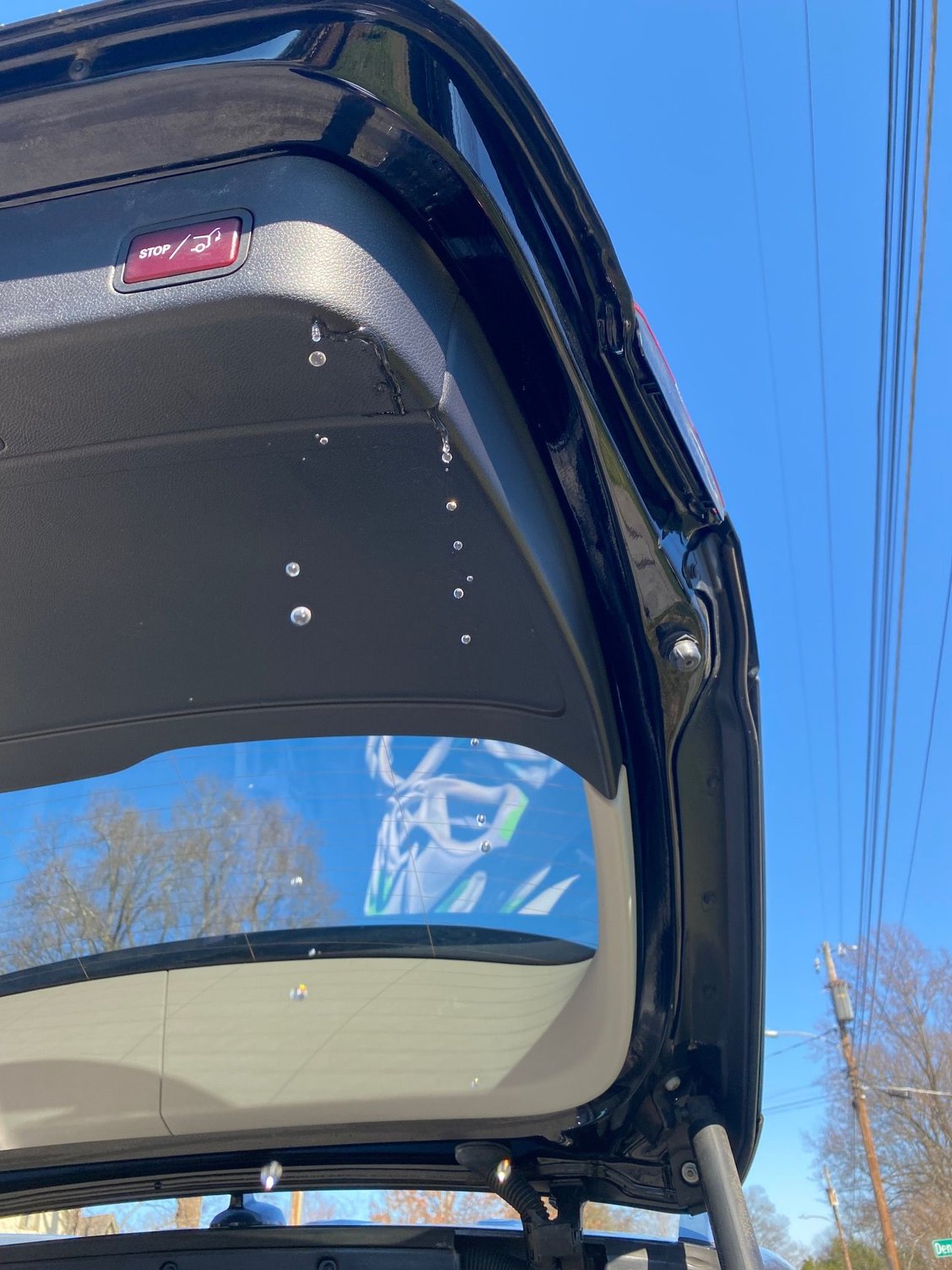

When I opened the trunk, water started streaming out of the plastic on the inside. It was after a big rain. The only thing I think it might be from is the lights on the trunk lid, one looks like it isnt on all the way. Does anyone know how to pry those off or take off the plastic surround on the inside of the trunk?

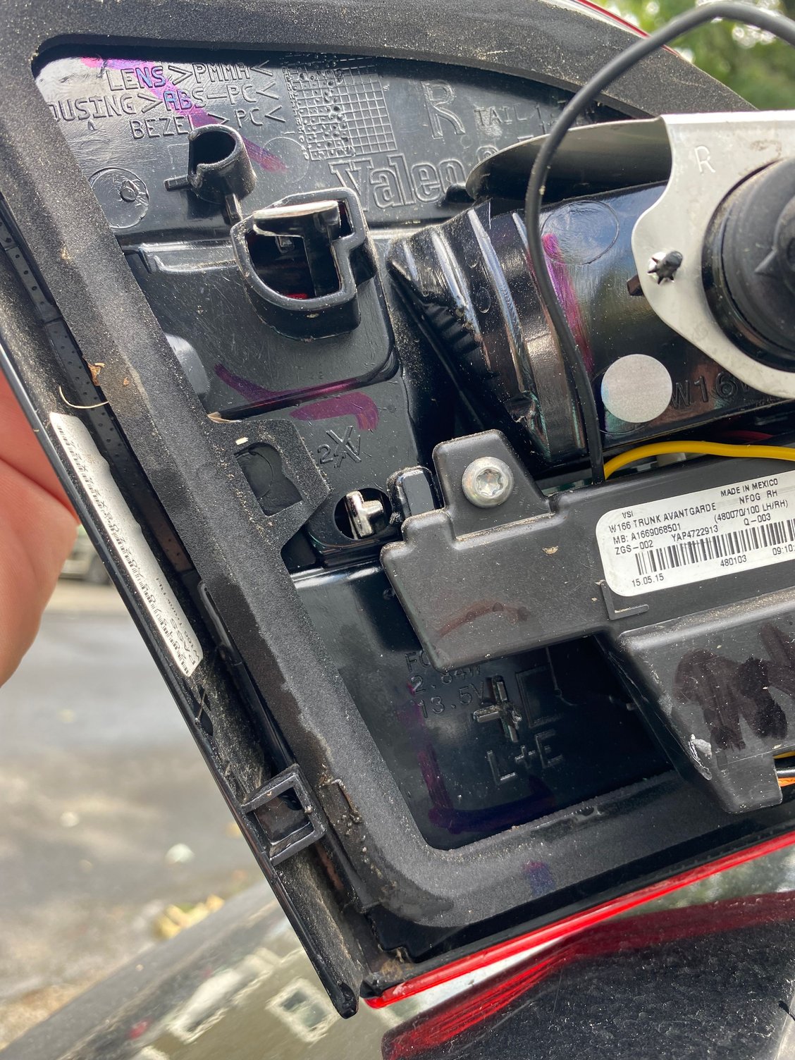

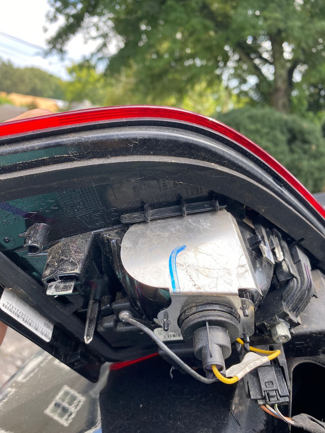

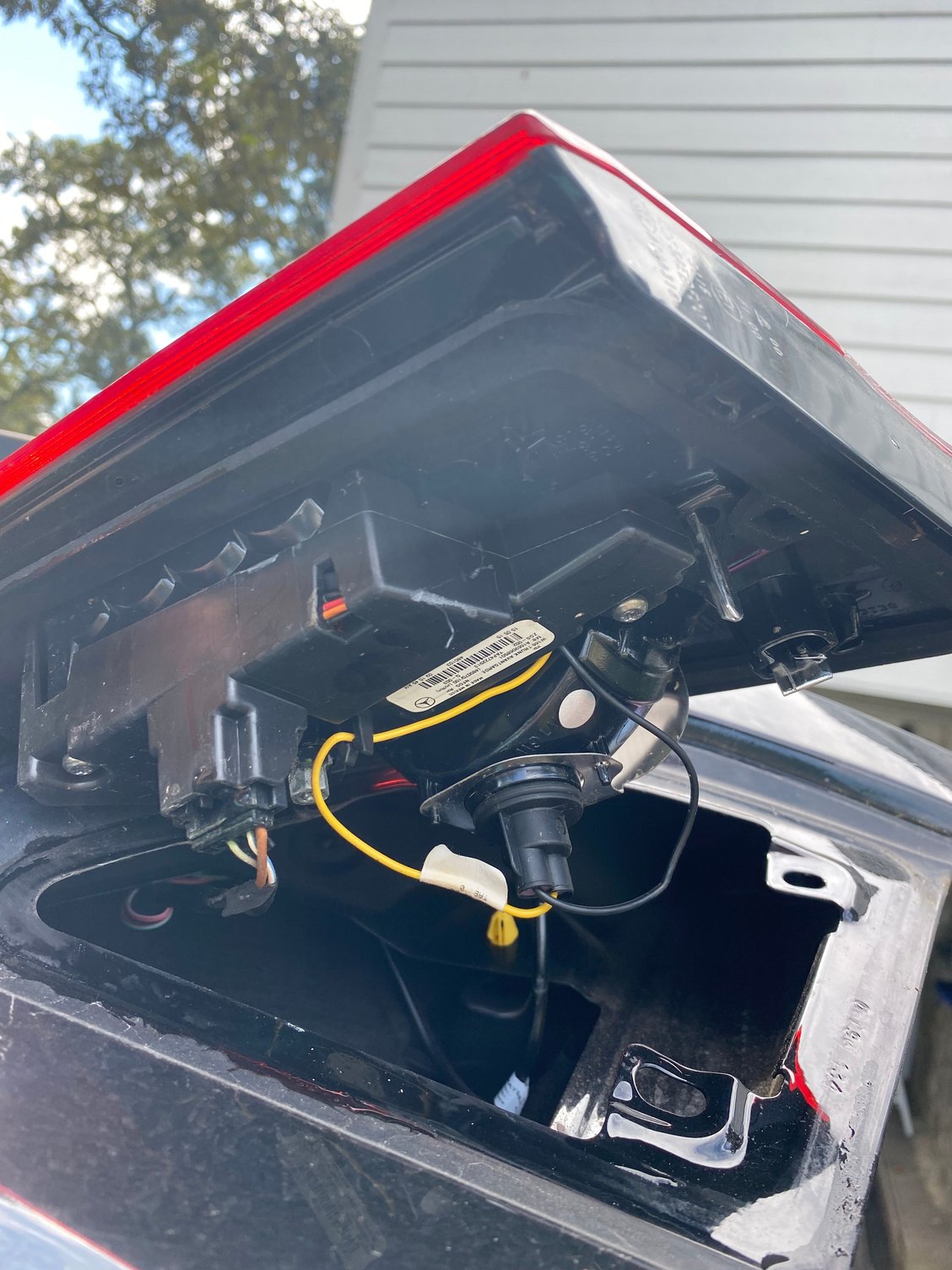

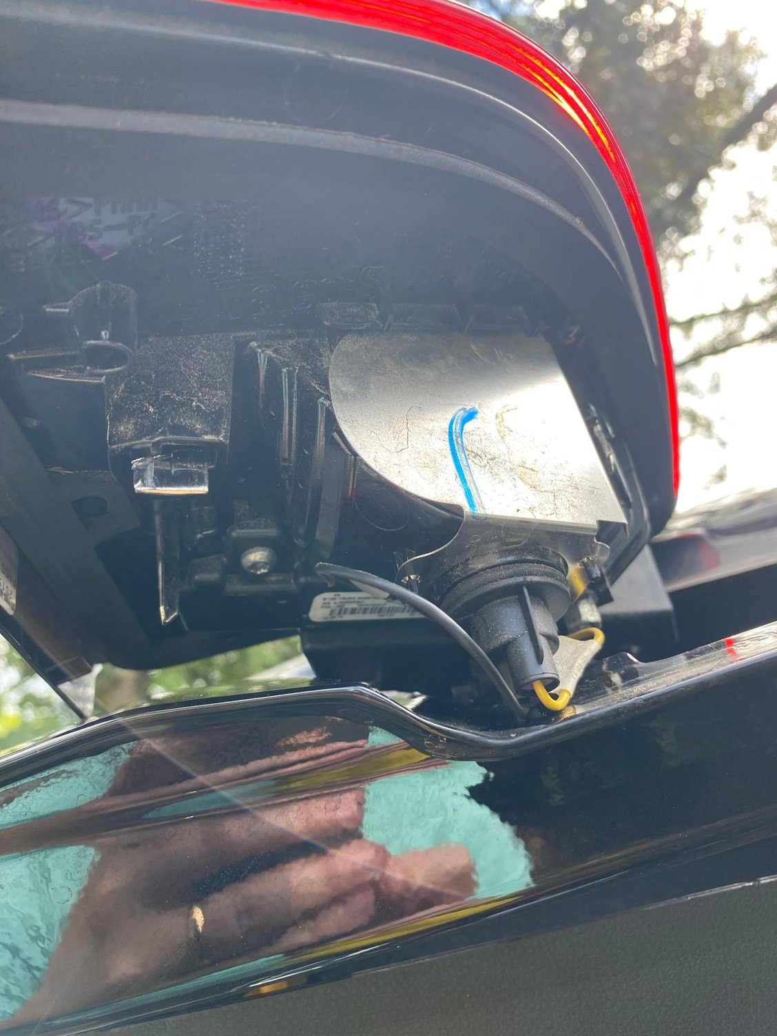

Finally got it opened up and not sure what the issue is. There was some moisture on the gasket.
