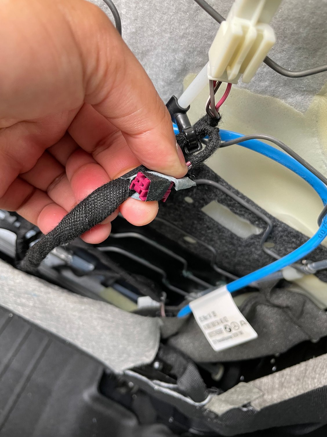

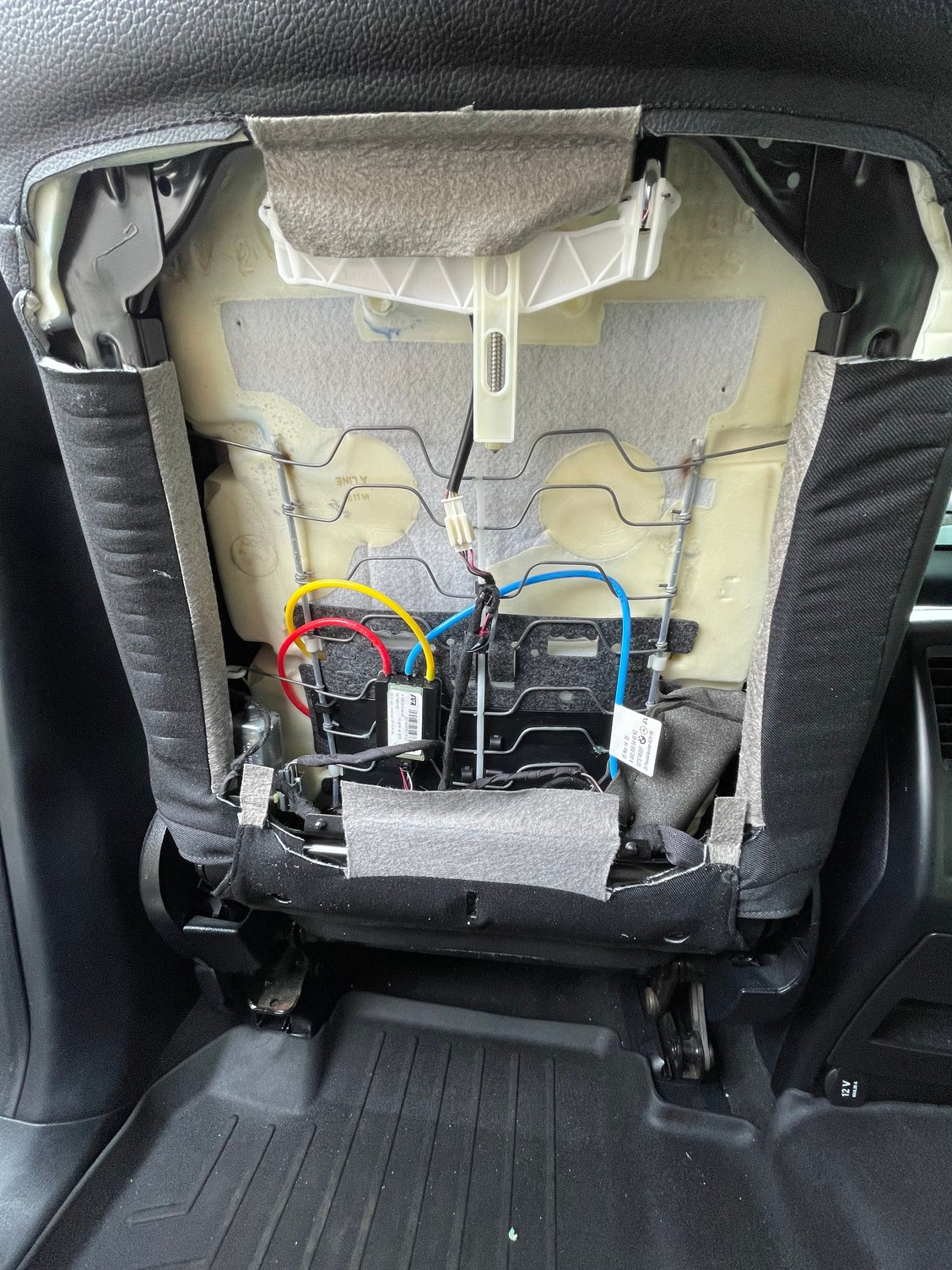

I was able to get the back cover off today. Looks like I would need to cut out the circles for the fans to install into, I would need to figure out how they secured the fans into the backrest pad, as I did not see any brackets for them or a different backrest pad for cooled seats.
The power plugin is there in the seats, which most likely means they would be plug and play once the appropriate seat switch is installed.

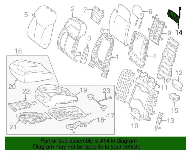

I will say that Mercedes has recently superseded the part number for the original fans and they are now significantly cheaper (£78+VAT here in UK for a pair of fans for the seat base) A0999060606
The thing that seems REALLY expensive is the factory seat foam that is specific to this option (around £350+VAT retail). There's also the seat backs with the grilles that are around £180 off memory (https://mercteil.com/mercedes-benz-a...are-part-ZEonN)
However, it wouldn't surprise me if all you need to do is cut out the holes in the middle of the regular seat foam. However these things seem less essential than the fans themselves.
