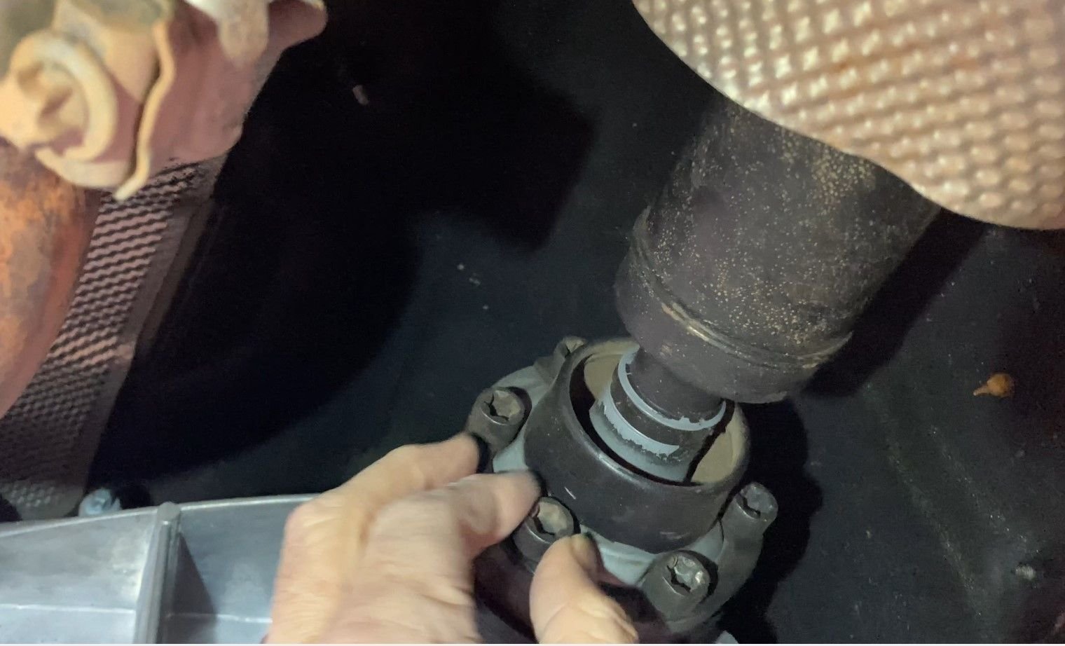

Originally Posted by danrob
Hi, while I am not a mechanic I have replaced Tires & Brake rotors. The Wheels are BBS.
This leaves the last two. Would the wear/damage be visible by a mechanic??
Thank you
Are confident the tires were balanced properly and are not damaged now?
Do you think a wheel is bent?
Failed propshaft flex couplings will be visible to an experienced mechanic. Failed axle shaft boot will be visible to a mechanic.
Failed propshaft or axle shaft joints need some diagnostic work (road test) that a mechanic is able to find.
