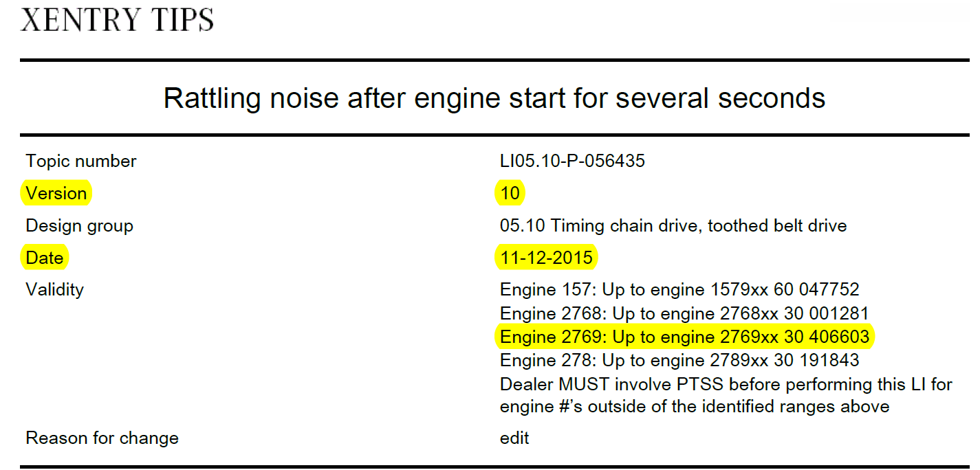

Open the connectors on the cam magnets and cam position sensors and check for presence of oil.
Is your engine in the affected range to have timing chain tensioner check valves installed?
Search feature will give you the details.

Follow @chassis advice, disconnect the camshaft sensors/solenoids connectors, get a good flash light and look into the harness side or the sensor side for some kind of shiny oily residue. If so, start the cleaning and parts replacing process starting with the sensor in question. If every sensor/solenoid connector is dry, you can either swap bank 1 with bank2 sensors, delete the error code and drive the car again to see if the code returns. What kind of diagnostics tool/scanner do you have ?
I have attached the document @chassis was referring to (I think it is)

Recall first KISS.
Like @chassis advised:
1 - Is your serial number in the list from the document?
2 - start by inspecting the connectors, if dry move to the next step
3 - swap sensor/solenoids, i.e. intake<->exhaust on the same side and see if the code swap from the exhaust to intake as well, if not next step
4 - Continue digging deeper.

This is your vehicle's datacard.. Engine serial number : 276955 30 331304 .. If I read the document correctly, your engine is within the list in the document --> Requires fixing
File Type: pdf

The engines listed in that document have some initial issues: rattling noise at startup which seems (based on the repair) to be due to low oil pressure at startup on the chain tensioner and basically, anything lubricated at the top of the engine: camshafts, adjusters, etc. I firmly believe that low oil pressure for too long on those components will start wearing out some of the components. So far, from the forum members reporting issues with these engines, the noise comes first. Other seems to skip the noise and start with codes related to camshaft adjusters (or perhaps worse oil leaking through the sensors and triggering intermittent failures)
If your engine was opened a year ago for camshafts on that bank and was not retrofitted with the chain tensioners and check valves as described in the document, someone missed the repair big time. In addition, if the camshaft needed replacement I would be surprised if the adjusters were not also damaged.
at this point, things do not seem to add up.

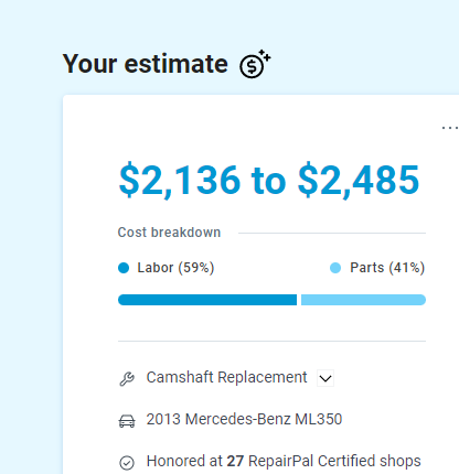

How much did you pay for the camshaft replacement? Here is a conservative estimate of how much that will be around here in Florida
and doing twice, it makes no sense.. Dealer estimate would have been higher. It is not a 1 hour job by any means of the imagination
