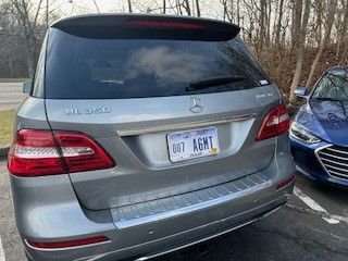

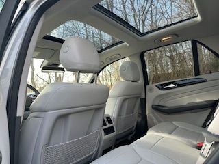

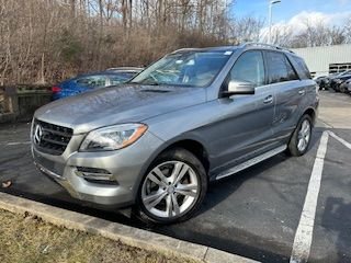

I have the opportunity to jump on this 2014 ML for a cool $9k. It's a one owner car with extensive service history as well as mileage being decent at 116k. It seems like a good deal to me, but these cars are a little before my time and a lot older than I typically like to own. With that being said, the economy sucks right now and being in something cheap for a couple years would help ease some of the financial sting as long as it isn't going to nickel and dime me (or a lot worse) to death.
To those who have had them long term please share your thoughts.
Onto the pics-
