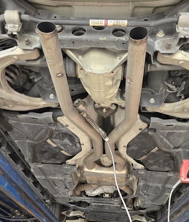

That makes perfect sense because I feared that it would have that loud open pipe sound which is not what im after and I'm not a fan of the cold start... Im looking for a muscular tone which you can hear when you get on it but nothing obnoxious.. I'm going to my muffler shop today to talk to my guy about potential setups i want to do..and to tack my turn downs. I am thinking about 3 options initially... may replace the big resonator with a magnaflow #12469 (3" dualin/out 5x8 body) and pipe it out like the pic(s) below with turn downs, no tips out the back.... OR add 2 small body straight thru mufflers/glasspacks to the piping you see in pic just before the turn downs an keep the stock resonator or magnaflow it....OR do an H or X pipe where the resonator is now and doing the 2 small body mufflers/glasspacks with turn downs...we'll see...

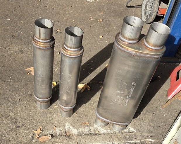

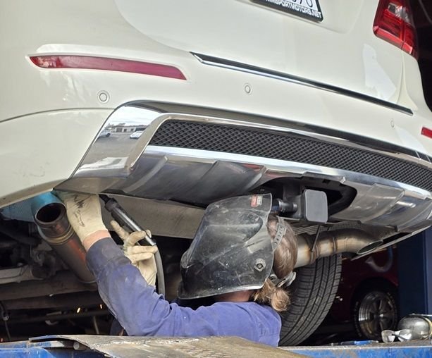

ok...after the morning drive to take kiddies to school...i'm going the most stealthiest route..lol... Gonna replace the stock resonator with a Magnaflow #12469 (has internal X pipe), and do Magnaflow #14419s at the rear dumped right after the muffler (in the original stock position)...

Just got back from my muffler shop...mufflers ordered. In the interim, here are pics of after I cut the muffler off, ran it like that for a day or so and then added the turn downs.... to make it look more inconspictuous..

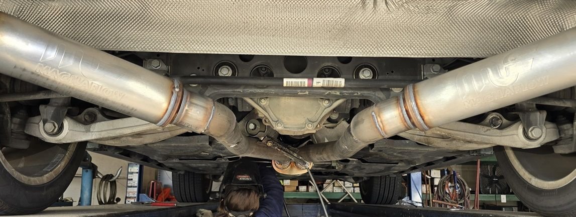

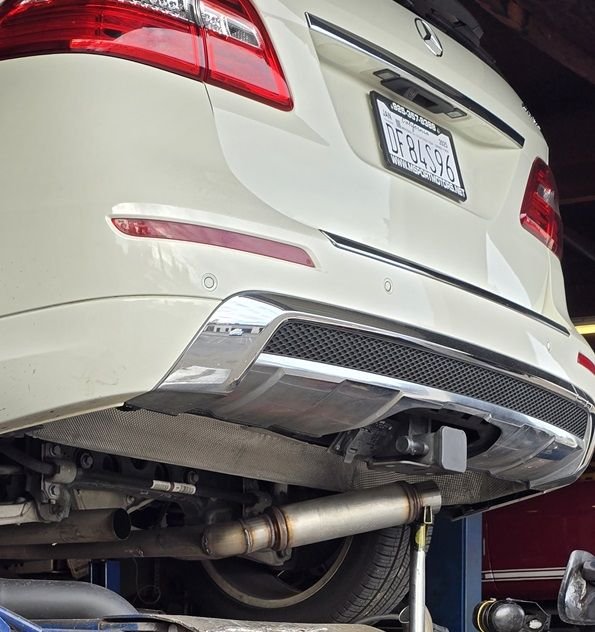

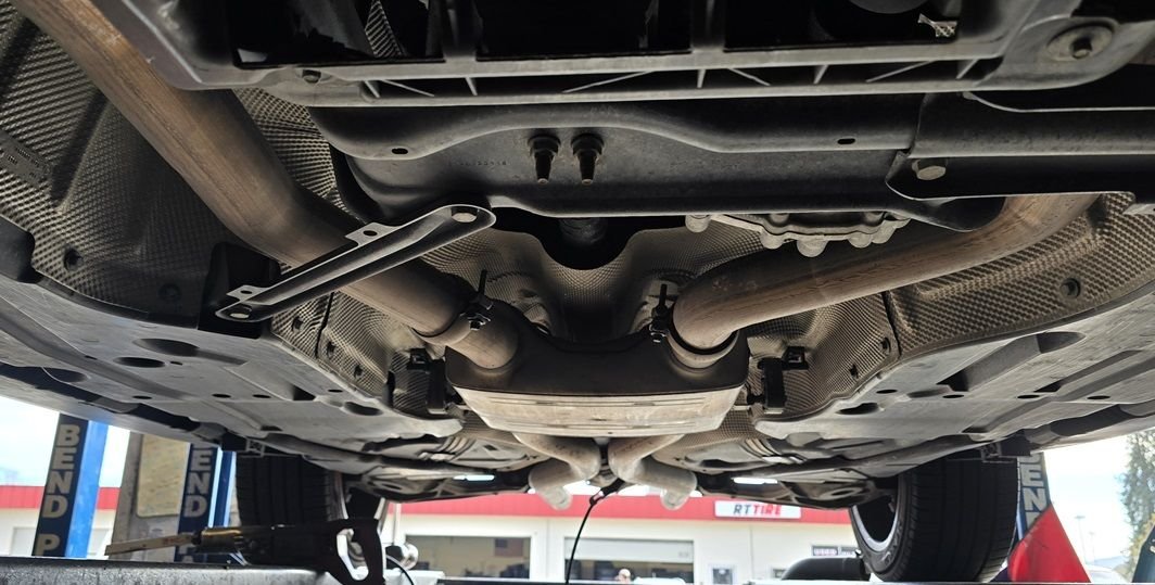

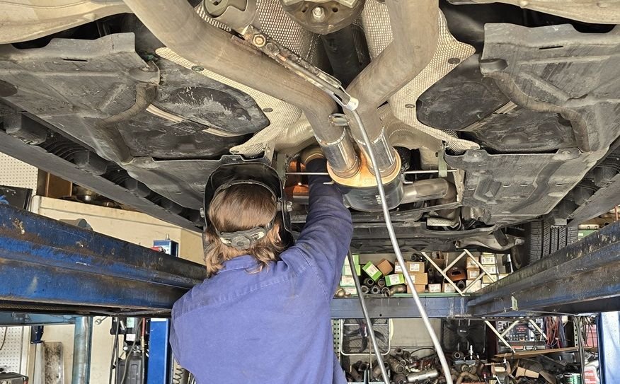

So I had my exhaust work done this week....It sounds amazing. It has the exact sound I'm looking for...muscular and not obnoxiously loud...the prevoius dumps sounded good but I wanted a more refined sound. Anyone who's done a resonator AND muffler delete...thats got to be way too loud inside the cab and I could only imagine a cold start...not good. It's raining out so a sound vid will come in the near future. He are some pics during the build process.
