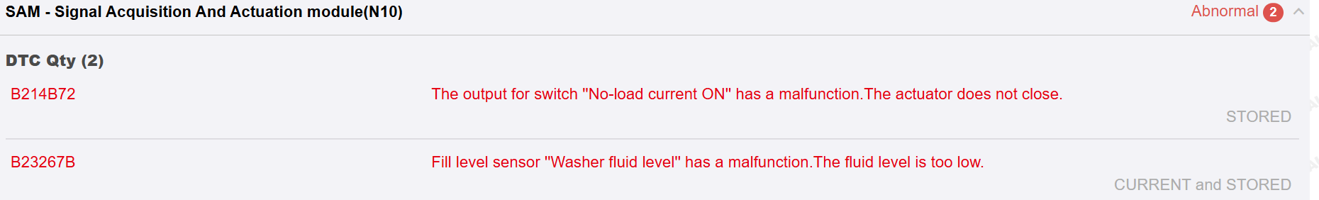

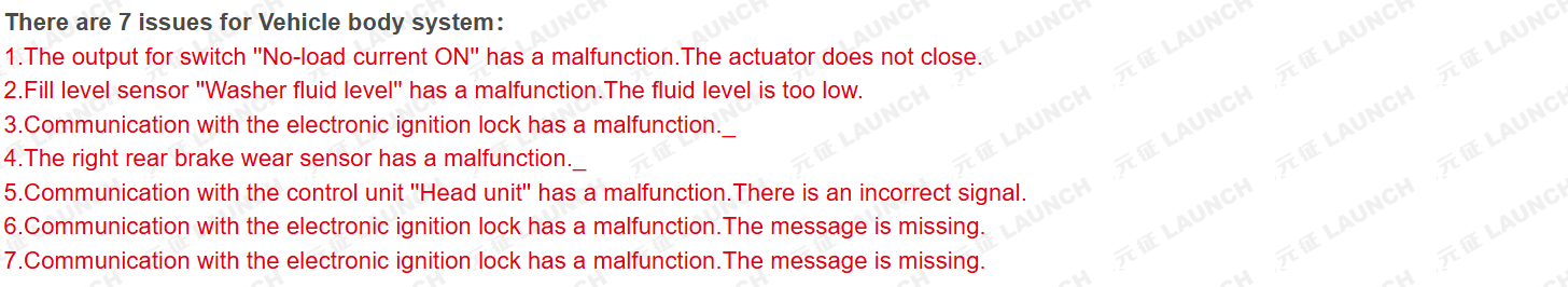

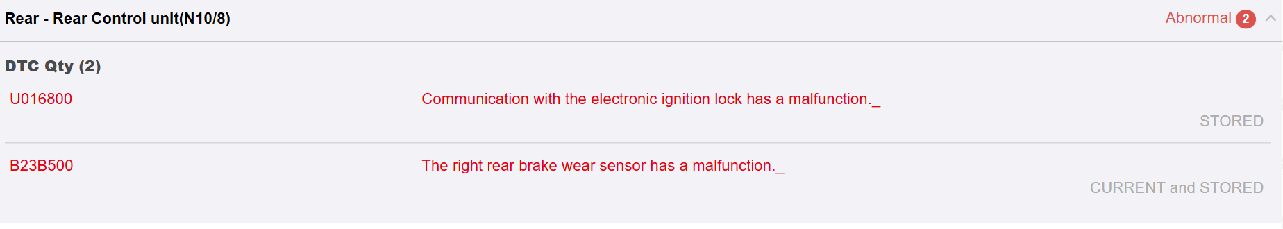

Diagnostics:
#1 is interesting
#2 Ignore
#3,5,7 EIS maybe the faulty solder connections ??? (how do you get that thing out), would this do it consider, hmmm
#4 ignore I know what that is, need to replace the sensor
#5 no comment
#6 & 7 Well no circuit power no coms I suppose
I will look up the codes - they seem to be talking about the EIS but still trying to decipher

You can NOT take these at face value ... I know well some of these faults and can say, they ARE EXTREMELY MISLEADING.
You need to consider what module is calling what fault. Faults by themselves are meaninglessness!
this is is your top ISSUE
This is driving everything else crazy.

from here the next step is concentrate on No1 fault:
this is top issue
this is top issue
You being a smart electronician, we can take a shortcut...

I'm battling very similar problem for past 3 weeks with 2012 ML350, 130k on it. when cold hit Massachusetts. If temps above 25F no issues, all works well, if below no luck getting power to dash... trunk open/closes fine with remote, interior lights on, hassar light works fine, does not look like battery as well. After locking/unlocking car for 10 or more times sometimes it recovers. Wondering if this could be related to AUX battery ? Yesterday while driving, and coming to stop car decided to switch to Park..... good we have snow on road, probably would of lost transmission.
Old Jan 22, 2025 | 01:56 AM
CaliBenzDriver's Avatar
Joined: Apr 2019
Posts: 11,923
Likes: 6,776
From: Silicon Valley
W212 MY'14 M276-3.5NA @75kMi
There's a good chance your issue is caused by a cold relay. Hook up a Launch scanner to get whole chassis report. Else wet finger random guessing is gonna be costly.
Old Jan 22, 2025 | 08:46 AM
vrmb's Avatar
Joined: Nov 2017
Posts: 33
2012 ML 350 (W166)
Thank you so much for reply. I will try to find someone with scanner. When you saying cold relay, is there specific one I should check/replace. I found a good link, which has all fuses/relays.
