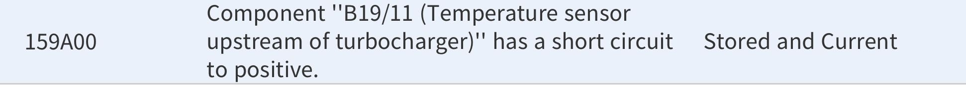

Loss power 159a00
hi
anyone has any photos or videos of dealing with this? Maybe shop manual? Location of this sensor. Unable to find any thing online.

Here is the Removal/Install for the Turbocharger. 1st page in the image shows the location of the B19/11 Temperature Sensor upstream of turbocharger that you are looking for. Appears to be located on the back lower side of the turbocharger. Looks like it's quite a bit of work to get to but the part may need replacement.
Might be a trip to the dealer and perhaps might be something covered under the AEM Field measure but you would need to confirm with the dealer.
Hope this helps
