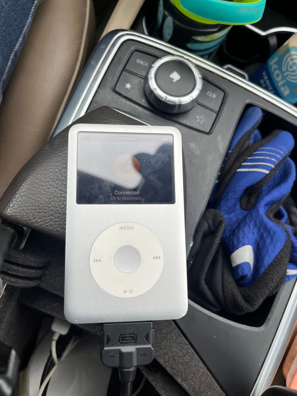

iPod Classic connected to center console via media interface cable.

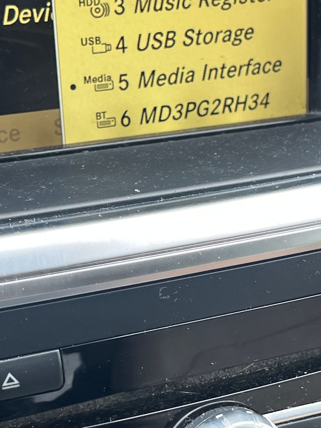

Media Interface selected on COMAND

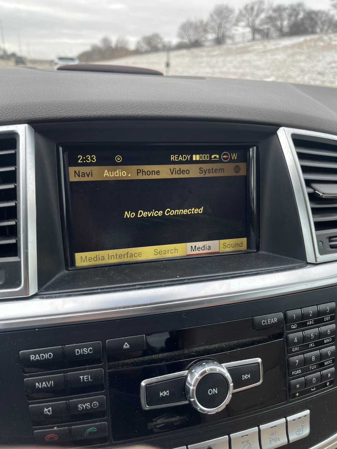

No device connected
No device connected
