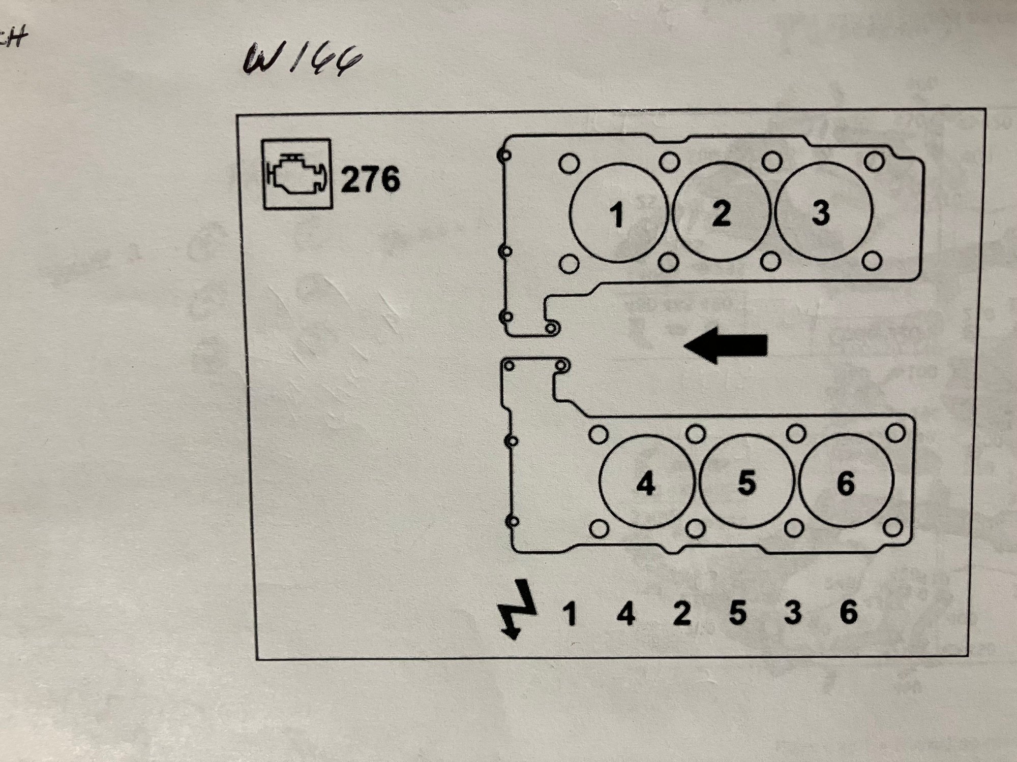

M276 Cylinder misfires when cold
This is the cylinder arrangement. If you are able to scan your engine control I think you will find misfires on one or more cylinders. Most likely they will not occur above a warmer ambient temperature like 50F

Quote: This is the cylinder arrangement. If you are able to scan your engine control I think you will find misfires on one or more cylinders. Most likely they will not occur above a warmer ambient temperature like 50F
Thank you for this schematic
Lots of experience here, to use
