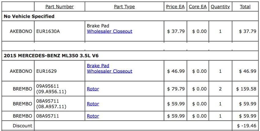

That's true for many/most of aftermarket pads for these vehicles. I have a 2015 ML 350 4MATIC without the AMG Sport Package brakes. A few months ago, my brakes were due, and I wanted to try the Akebono Euro pads, which were on sale (the complete set of front and rear pads was on clearance and cost less than $85 in total). For the rear pads, the SUV takes Akebono EUR1630A (corresponds to brake kit Mercedes Benz part#: 007-420-83-20, which has been replaced by 000-420-99-04), and, for the front pads, it takes Akebono EUR1629 (corresponds to brake kit Mercedes Benz part#: 007-420-81-20, which has been replaced by 000-420-13-05). The Akebono rear pad kit comes with wear sensors and anti-rattle springs, but they don't fit correctly. The Akebono front pad kit comes with just the wear sensors.
When I was looking up parts, I checked the Mercedes parts catalog, but it seems that the rear anti-rattle springs are not available separately from the Genuine Mercedes kit (I couldn't even find separate part #s from Mercedes). None of the U.S.-based parts suppliers had any either, but I think one might be able to find compatible aftermarket ones from vendors in Europe (or on eBay). Had to clean and reuse the old ones.
The spring clips for the front brake pads are available separately from Mercedes (possibly the same as those used on other makes and models), so I picked up a set from a dealership to replace the rusty ones on my vehicle (we're in coastal northern New England...).
The coating on the Genuine Mercedes rotors that came with the vehicle had held up well in our salty environment, and we were OK with their braking performance, so I decided to just get the coated rotors from Brembo, the OE manufacturer for the Genuine Mercedes rotors (both manufactured in the U.S.)... The parts prices with the sales discounts applied were pretty reasonable, I'd say.
