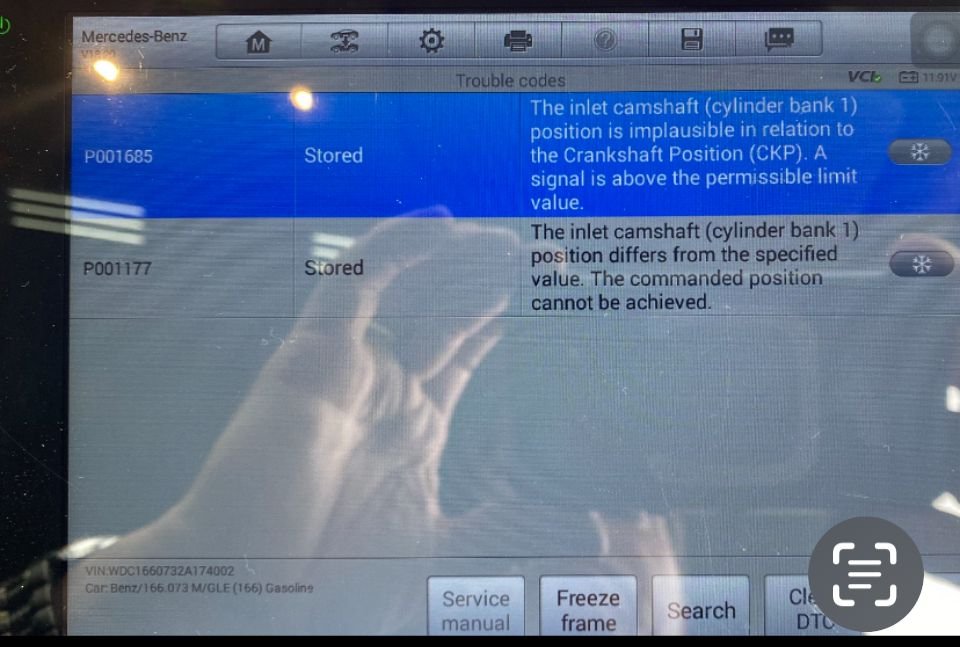

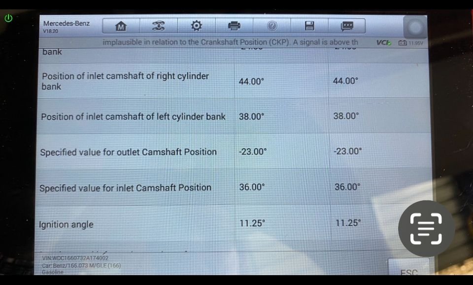

Does your scanner read the camshaft position. They can be up to 7 degrees out before throwing a code. Your codes are for the circuit not the actual cam adjuster.
My inlet cam adjuster was out , passed the specified amount. These were the codes.
It’s actually the reluctor wheel that is pressed on the camshaft that becomes out not the adjuster itself.
