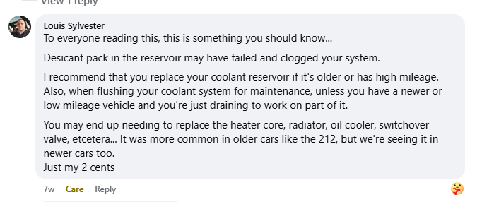

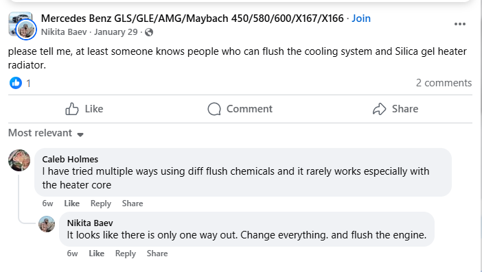

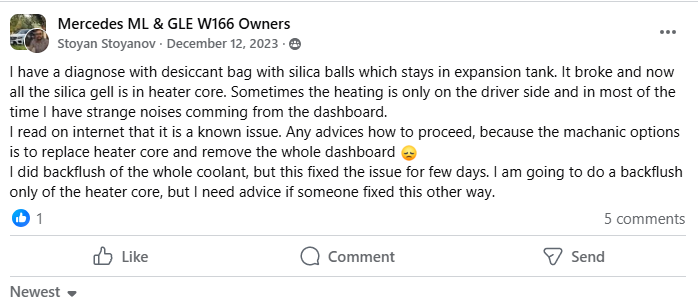

Found an instance,
From another group, and a very collaborative MB tech there, Louis,
From Caleb Holmes (also a MB Tech in those groups),

Found an instance,
Louis here, Thanks for the kind words!
Just a little more info on this:
166 chassis coolant reservoir has a 'hanging' desiccant POUCH (which is synthetic/plastic).
I'm not sure how many other chassis have pouches like these, but a lot of vehicles have a plastic box with slits on the sides (similar to charcoal filter cartridge in a fish tank?).
Although both types can fail, it seems like the POUCHES may be a little more susceptible to failing. The pouch has a 'hoop/loop' on one end and attaches to the top of the reservoir. My assumption is that the pouch can swing around when the coolant is low (probably moves from coolant flow too) and may cause a weak point in it. Thus tearing & letting the desiccant circulate in the system... then clogging it.
This is why we may recommend a new tank preemptively while doing repairs (depending on age/mileage).
