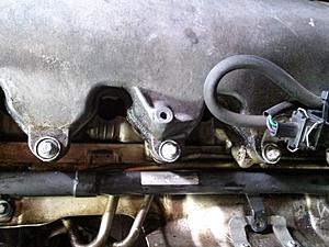

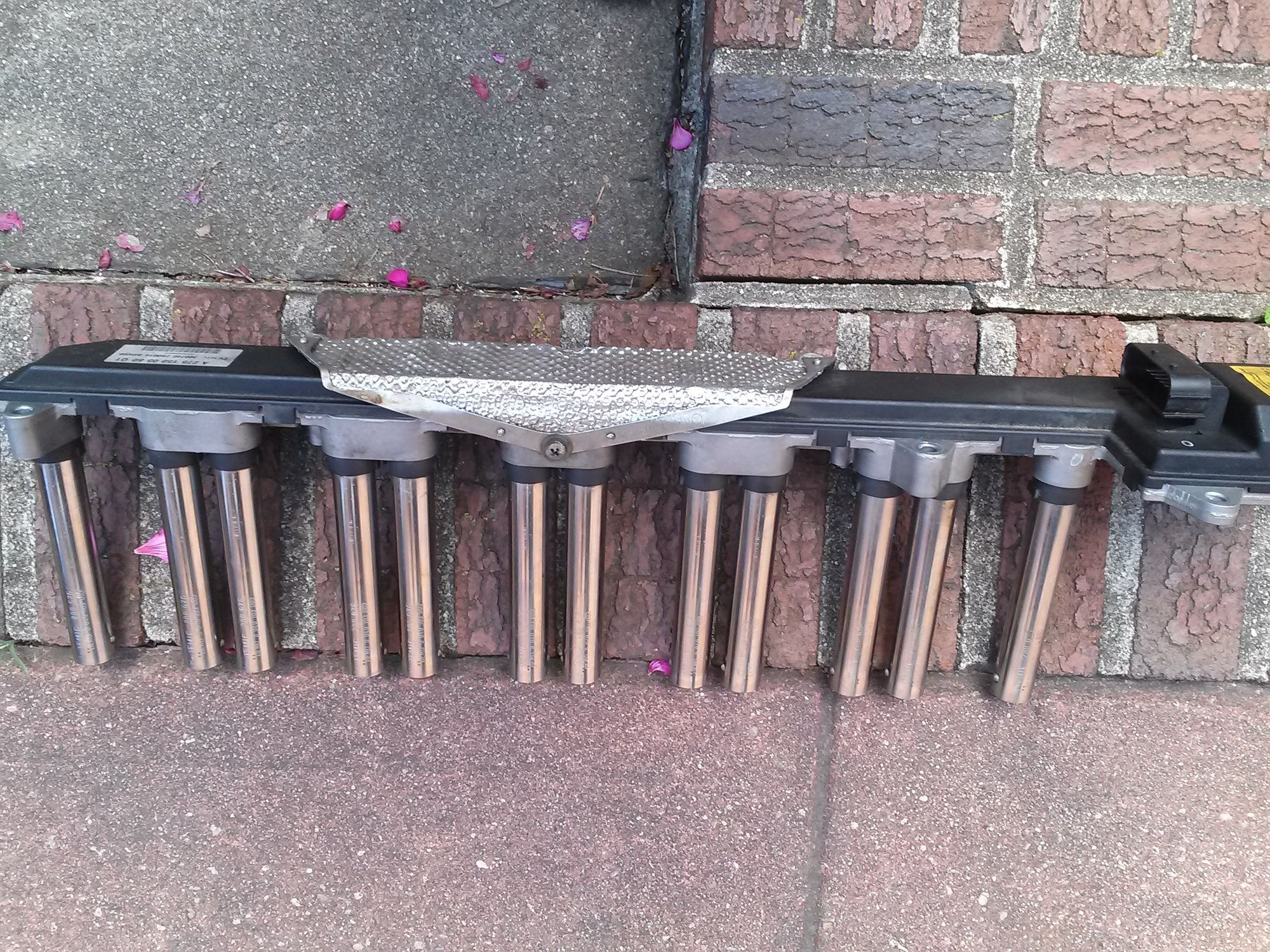

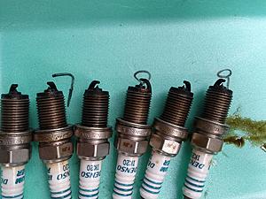

Yea,I too have a problem with my Left Coil pack.
Miss fires on all six,codes are P0300(random) and 307-312.
It runs fine on a cold start for about two minutes and that's that, check engine light comes on and miss fire badly. I have to admit that besides regular oil changes and top up with oil in between I haven't do anything to maintain it.
Thanks to the Forum here with another DIY instruction to remove and replace the coil pack, I was able to pull the pack out with minimum effort.
I attached some Pic below,
Coil pack is nice and clean by only looking at it, No arcing/burn marks/separation on the tube. too bad there is noway to test it out?
Red insulate boots are kind dry but not cracking.
Spark plugs are something else, I bet you guys have never seen anything this bad.
I did notice that I need a Valve cove gasket replacement as well,you'll see it in the photo, my question is do you think it's because the Valve cover leaking and oil drips down then slowly ruined the plugs and coil pack? but all the Red boots are clean without any trace of oil. Some Plugs threads are covered with oil, I don't know if it's just the oil just sitting/collected outside the plug and when I unscrew them and oil got on them?
Attached Thumbnails Misfiring-v12-coil-pack-007.jpg   Misfiring-v12-coil-pack-008.jpg   Misfiring-v12-coil-pack-009.jpg
Old Jun 30, 2015 | 02:50 PM
  #115
fisherman123's Avatar
Joined: May 2012
Posts: 23
04 S600 16 Honda
a little closeup
Attached Thumbnails Misfiring-v12-coil-pack-012.jpg   Misfiring-v12-coil-pack-011.jpg   Misfiring-v12-coil-pack-014.jpg   Misfiring-v12-coil-pack-015.jpg
Old Jun 30, 2015 | 03:55 PM
  #116
biker349's Avatar
Joined: Oct 2009
Posts: 1,924
Likes: 38
cl600
it's possible it's your ignition module. had similar problem and the ignition module solved it. good luck.
Old Jun 30, 2015 | 04:32 PM
  #117
Joined: May 2012
Posts: 23
04 S600 16 Honda
Thanks Biker! Sorry,My bad, I forgot to mention I already swapped out mine with a known good one from my Indy and that didn't help,at this point he thinks it's the pack and of course he doesn't have an extra pack for me to play with.
