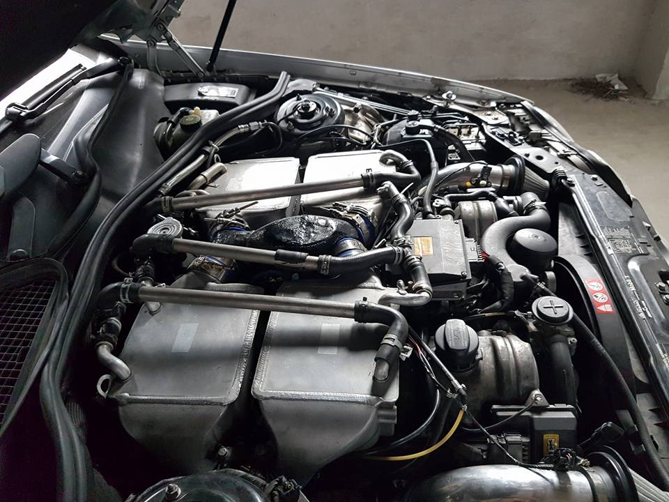

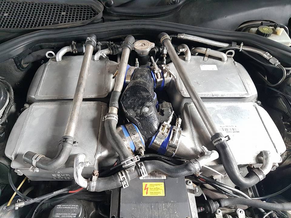

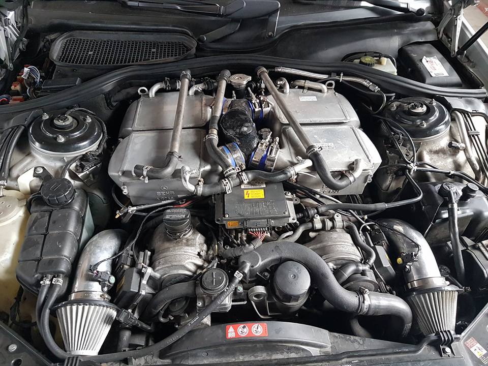

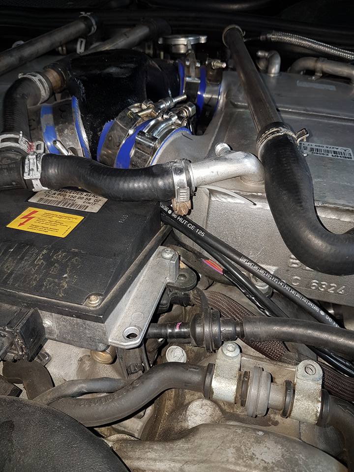

Old May 5, 2016 | 01:54 PM
MB-CLS500's Avatar
Joined: Feb 2012
Posts: 155
From: Tbilisi , Georgia
CL600 W216
and 4 yeasr later...
Attached Thumbnails Attempt to Fab Quad Inter-coolers-13179187_485726201618234_163073455076677129_n.jpg   Attempt to Fab Quad Inter-coolers-13151459_485726151618239_2547987777739619786_n.jpg   Attempt to Fab Quad Inter-coolers-13133314_485726174951570_8415191508602087811_n.jpg   Attempt to Fab Quad Inter-coolers-13124936_485726034951584_1123667669379385266_n.jpg
