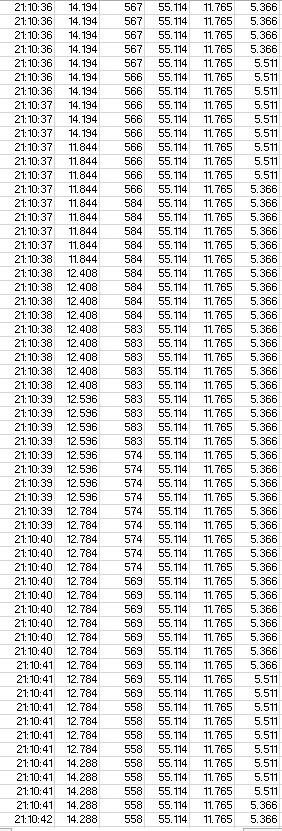

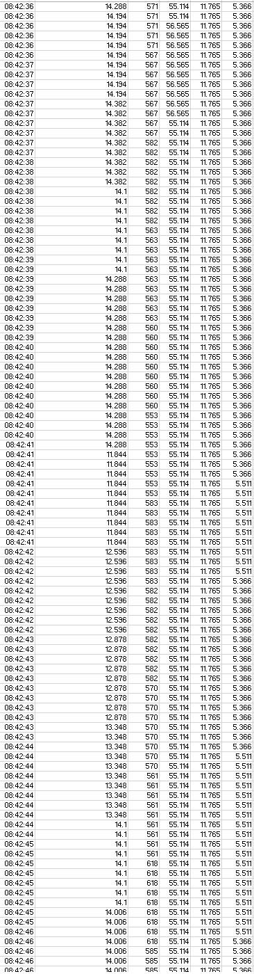

Hi all,
2007 CL600 M275 5.5
I'm having an issue which I am struggling to diagnose. First thing I should point out is that there are no stored codes on any modules and that the batteries were replaced 6 months ago.
The issue I'm having is that, once warmed up after about 10-15 minutes of driving, when I stop for a prolonged period of time (>5 seconds) the car will idle perfectly for 4-5 seconds but then there is a bit of a shake/wobble. When looking at the voltage I can see it drops from about 14.1 to 11.8 immediately when this happens before quickly recovering. The weird this is this only happens once. I can happily pull away to the next stop light and it won't do it again for the remainder of the journey. It doesn't even do it on the return journey, the only time it will happen again is the following day.
Below are some data logs. The columns are (Time, Voltage, RPM, Fuel Pressure, Throttle position, and Manifold pressure). As you can see manifold pressure, fuel pressure and throttle position are all consistent so I don't think it is a fuelling/vacuum/throttle-body issue.
Any assistance very much appreciated.

Well when you said "Sometimes the secondary air injection pump kicks in when warm (for some reason)" it turns out I need to figure out what that reason is.
The problem didn't happen yesterday, I started the car for 60 seconds or so, then had to switch off because I left something In needed for work, switched back on and carried on my journey. No problems at all.
However, this morning it did happen again and I had my diagnostics with the M33 pump data up. The moment the car "stumbles" the air pump is actuated (for less than a second). I don't know if the immediate drop in voltage is detected and it switches off or what but I need to figure out why the pump is trying to kick in when the car is warmed up. First stop will be the vacuum tubes on the valve cover which goes to the two valves (that the air pump routes its air to) as I have read that these vacuum tubes are often culpable. I have pre-emptively ordered some replacement tubing from Mercedes because even if they aren't leaking I'd like to renew them. Another possibility is the swichover valve that lives under the intercooler but this is throwing no errors. Does anyone know what state the valve should be in and when. On my way in this morning it was "open" for most of the journey. I don't know if that means that the pressure in the tubing is atmospheric (and closed means it pulls vacuum) or vice versa.
Thank you Polar Bear for getting me this far.
