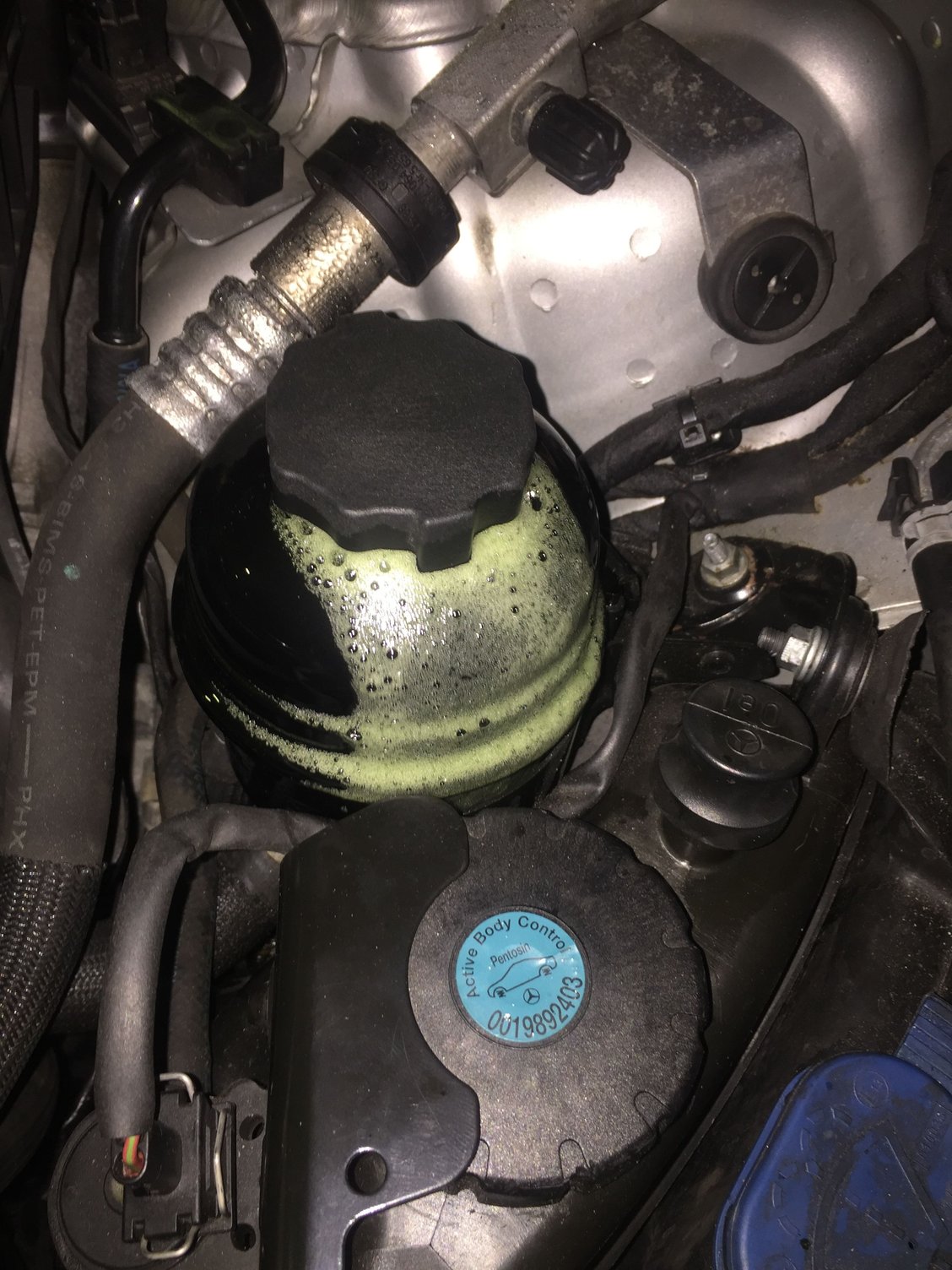

Could only find..........
After inspecting the power steering system today I could only find some oil around reservoir bottle. Bottle dipstick lid and gasket cleaned.
Fluid topped up and bled by moving front wheels left to right with engine off while on axle stands,
engine started no noise and steering smooth.
Went out for a drive and it started to get noise, stops
to check and found fluid frothing out of lid on reservoir bottle.

Air is entering the system.
You mentioned that you drained and refilled the power steering. And a mechanic prior to your ownership replaced a hose. Is it possible any of those repairs have resulted in a leak?
Did the vehicle demonstrate this problem the day you bought it? If no, dig into the repair work you and the mechanic did. If yes, the air/foam are likely due to lack of use and a seal somewhere may have hardened and become ineffective.

Answers to Q’s
Thanks for the reply.
I have done 4K miles in the car in last 7 months since I bought it.
The car did not do this when I bought it or after I serviced it 4K miles ago.
Tomorrow I will put vacuum pump onto reservoir and see if it holds vacuum.
Also reading WIS it says upto 30 lock to lock with engine off to bleed system of air.
But of course the big question is where did all this get into the system?
Will report back with findings.
Alex

Sorted the problem
Jacked car up and with engine off did 30 lock to lock with steering.
set reservoir at the correct level
Have now done 30 miles and it’s perfect
could not tell you why or how the air got in there.
Alex
