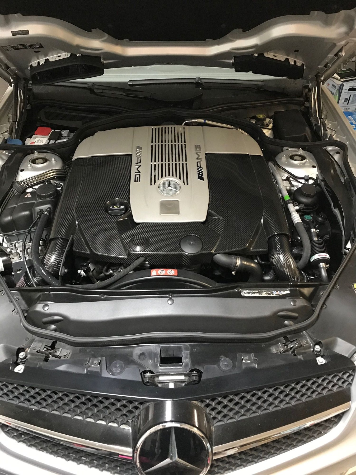

Did a couple carbon fiber shields to block heat from this setup in the engine bay. Still fed by outside ducts but eliminated the number of sharp bends and a chunk of the associated pressure loss in the stock airboxes. Picked up a couple pounds of boost in the higher rev range where it normally falls off but also have downpipes.

Jul 23, 2025 | 03:20 PM
Quote: Did a couple carbon fiber shields to block heat from this setup in the engine bay. Still fed by outside ducts but eliminated the number of sharp bends and a chunk of the associated pressure loss in the stock airboxes. Picked up a couple pounds of boost in the higher rev range where it normally falls off but also have downpipes.
Any pics of this setup with the cover off?
Reply 0
Jul 23, 2025 | 10:05 PM
Seconding this request, very curious what the airbox modification(s) look like.
Reply 0
Apr 2, 2026 | 03:01 PM
Third request for more pics of the above SL.
