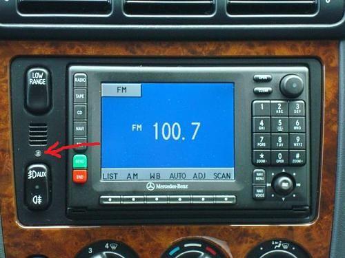

Insert the original key into ign., turn the key to pos. #2 (not start), all the time watching the LED light. Does it blink once?

Thanks. I'll check that upon my return home.
