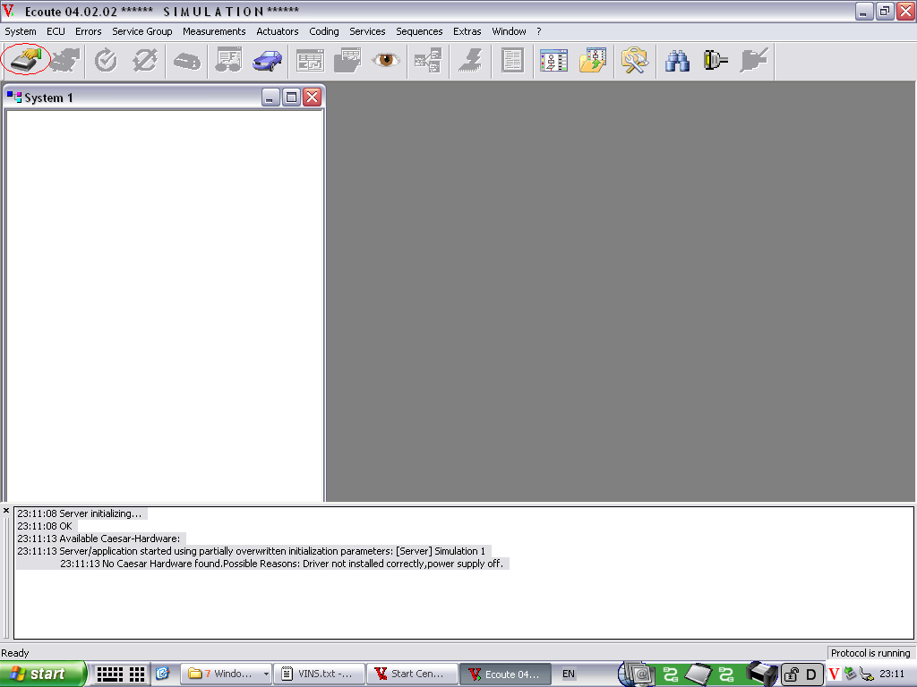

1. Open "Vediamo Start Center"
You should see your HW ID in the vediamo server section (Also if you open the information pop-up you should see license available)
2. Open "Ecoute" (The red simulation label is normal)

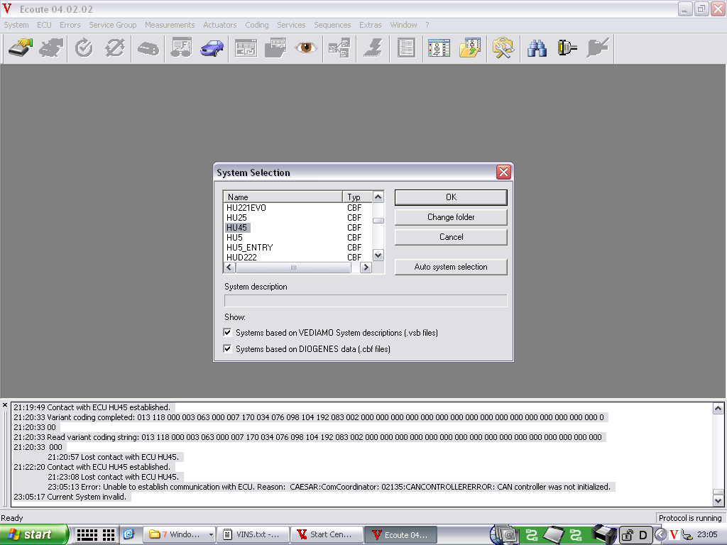

2. The Ecoute screen will load, select the "Load System" icon:

Select HU45 from the list (if the list is empty you need to browse to the folder where you have your cbf files):

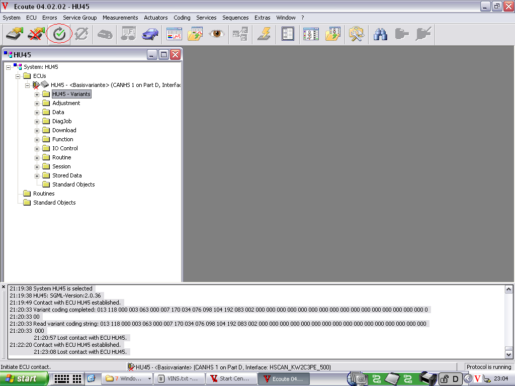

5. Select the "Initiate Connection" icon:

6. After connection is established select the variant coding icon: (The icon is grey in this image because I had already disconnected, it should not be grey for you)

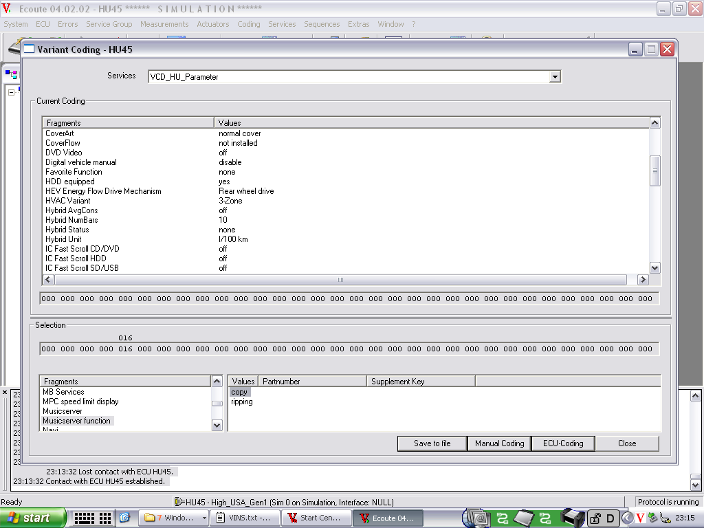

7. Finally locate the parameter, select VCD_HU_Parameter from the services drop-down and then the Musicserver function. Select the "copy" value and click the "ECU-Coding" box:
