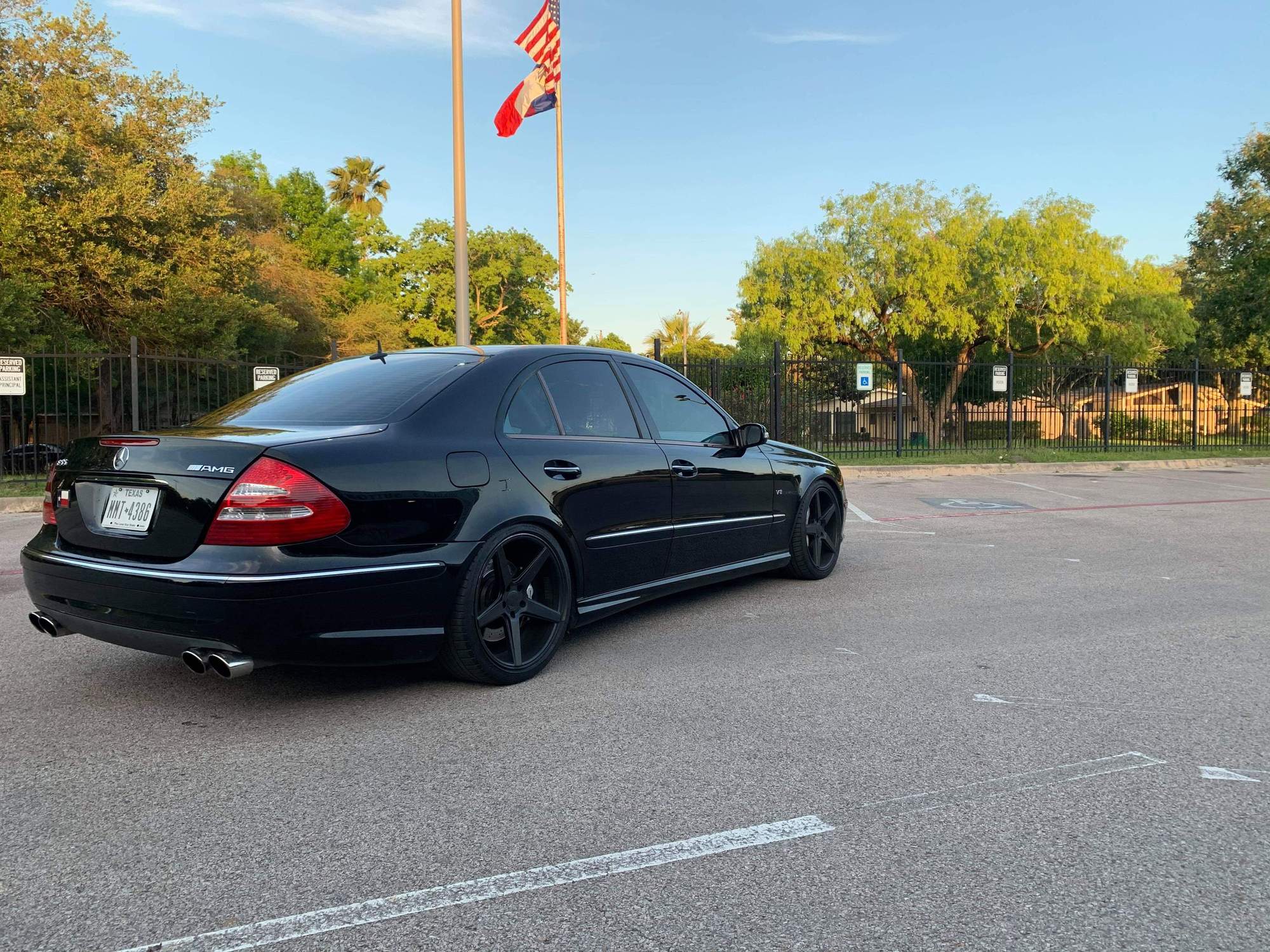

Good morning fellas!
I'm brand new here and I live in Houston, TX. I'm hoping I can get little help/advice on my current "randomly wont start" issue from someone more experienced than myself on these cars.
I just recently purchased a 2003 E55 AMG (first Mercedes I've owned but I've always liked the E55's). I needed an affordable daily driver/work car that would still be nice and enjoyable to drive so I figured the E55 would be a solid bang for the buck option. Shortly after I began looking, this one popped up local at a good price.
I've had the car for about a week now. It has a few mods, mileage was reasonable at 103k. It seems to have been pretty well cared for. Price was more than fair at $6k for a clean title/clean history E55. 😬
Mods:
-74mm clutchless upper
-AMG belt wrap kit
-Aftermarket front mounted H/E
-Split cooling
-BMW power steering reservoir for additional coolant capacity
-BCracing coilovers
-Resonator/muffler delete with X pipe welded in
-KMC 19" wheels
Anyway, car has been great all week until this morning when it just randomly wouldn't start. The car turns over like it wants to start but just wont fire up. In the short time I had to mess with it before work, it seems like the fuel pumps are failing to prime/power up.
Previous owner said he just replaced the radiator, fuel pump setup and installed the coilovers not long before I bought the car.
Any ideas as to what my issue may be? My first thought was... fuel pump fuse/relay. I only had about 20 mins to mess with it before work. From what I googled, fuel pump fuse and relay are in the fuse box in the trunk but when I looked, I had a small 7.5 amp fuse in #004 which was still good and the relay in spot #A (without testing it) appeared to look normal. My car being an 03 E55 AMG, I read somewhere that those 2 spots are correct for non-AMG cars and that my fuel pump fuses are in a different location.
Can anyone point me to where they would be on my 03?
I plan to mess with it tonight after work. I'm mechanically inclined and I work on my own vehicles 90% of the time unless its something big that i dont have the space or time to mess with. On this E55 though, i just dont know much about them. This will def be a learning experience. Lol
I appreciate the help in advance!

Thats a nice car !

Thank you! Def not too bad for its age. Has a few minor flaws but thats expected on a 100k+ mile car that's 17 years old. Lol
