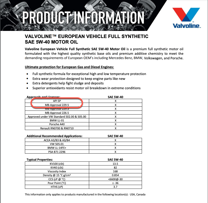

So far, I found Valvoline 5W-40 meeting the SP and 229.5 ratings. 0W-40 meets only 229.5.

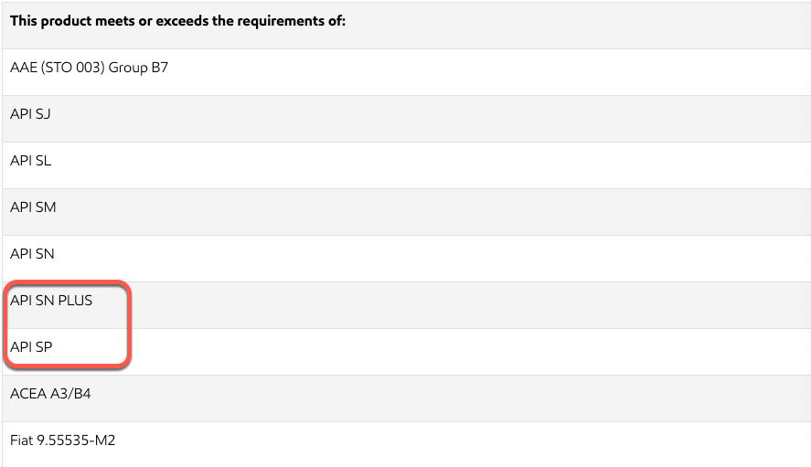

Mobil 1 0W-40 meets only SN specification. It also seems Castrol Edge 5W-40 meets SP and 0W-40 meets SN. Conclusion: 5W-40 meets the SP specification, while 0W-40 does not. Curious if the new Benzes have the Mobil 1 0W-40 sticker under the hood.

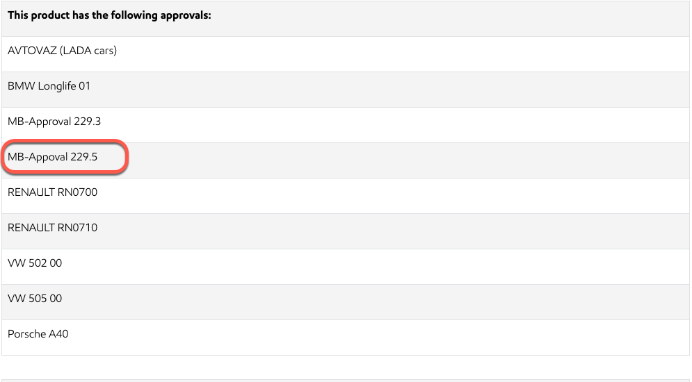

Lastly, Mobil 1 5W-40 meets all of the specs.
https://www.mobil.com/en/lubricants/...bil-1-fs-5w-40

Yeah the approved list is pretty much useless for me. Why? Because I am not interested in the list of all 229.5 oils. Pretty much every euro oil on the market will list 229.5 on the bottle. Not hard to find, at all. What I was after is API SP with the 229.5 approval. And right now there aren't many that have that, but there are a few. The presumption I was making is 229.5 + API SP would be the best oil you could get (at least by spec) for our vehicles, particularly those of us with direct injection.
Basically it brings in the goodness of GF-6 timing chain protection plus this LSPI business (which is from API SN Plus), in an oil that otherwise meets MB specs.
