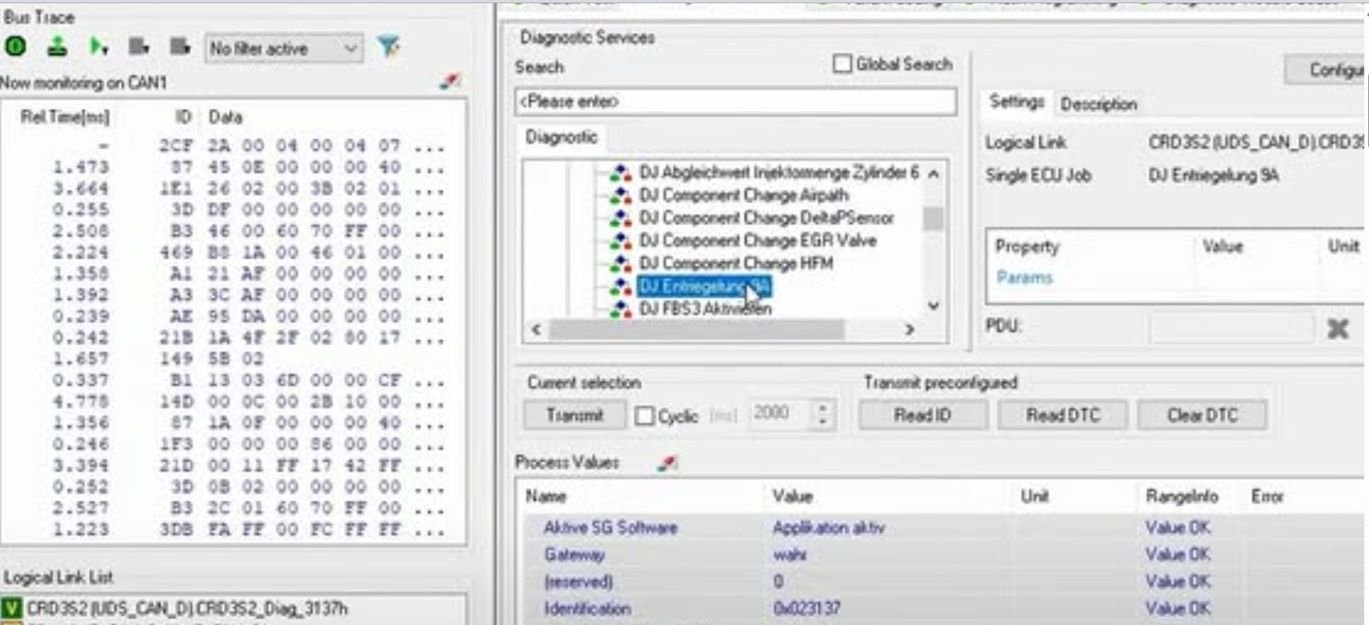

Unlock ECU using DJ Entrigelung 9A and 9B if I remember correctly, also the second level is written very clear like "Variant Coding seed request/send" in Security.
I can connect to your laptop to show you if you promise that you will help other members too.

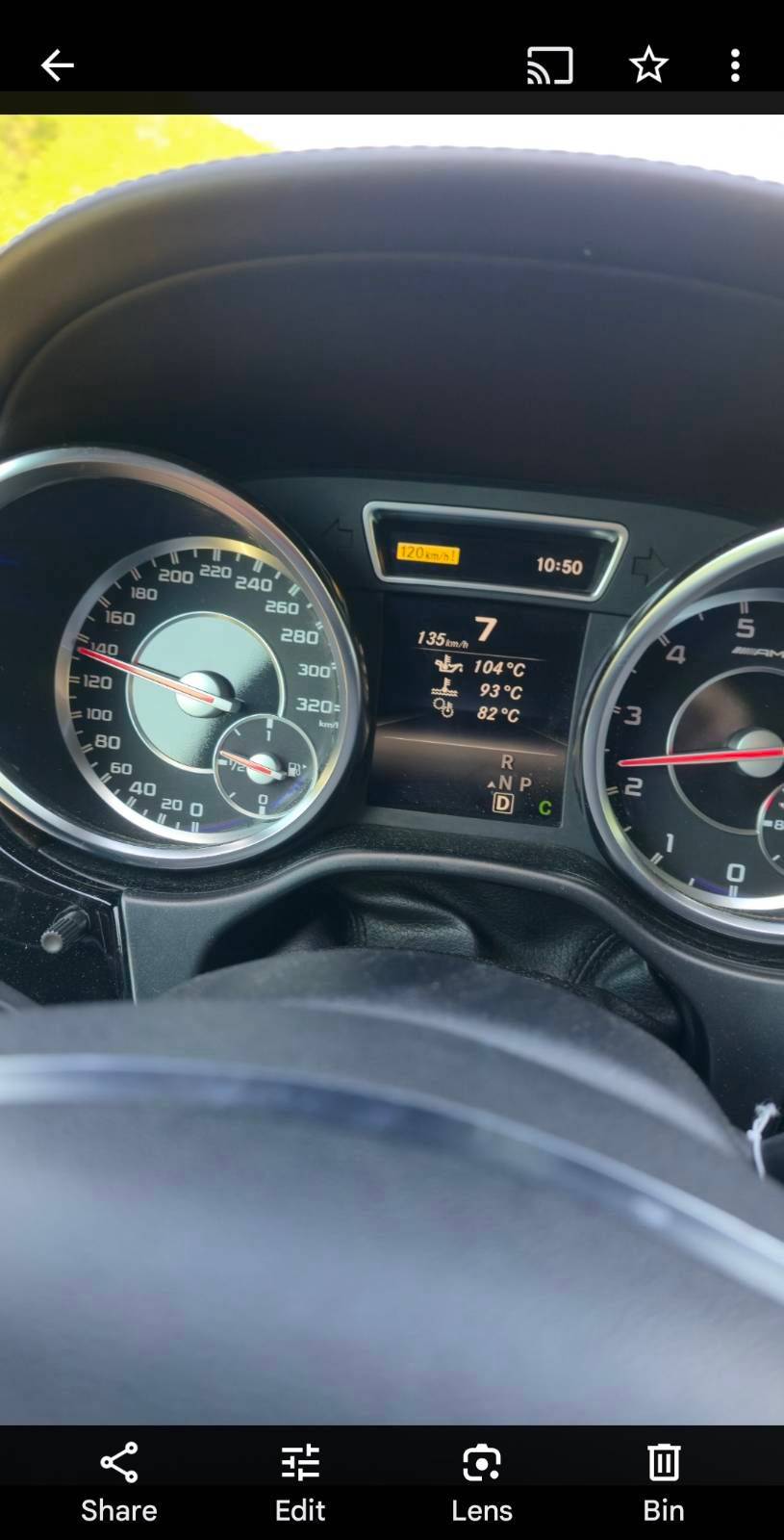

@realeric
Dude, I owe you at least one bottle of scotch
I've read tens of "guides" and watched tons of YT videos without result. With your guide, I've managed to change the start/stop, move the speed limiter from 280 to 300 and disable the seatbelt warning in less than hour (I already had laptop with Xentry, Vediamo, Monaco and Seed calc installed). It only took me an hour, just because I had to find the right dll for mine MED177. Big Thank you!
Question for you and the others: I got mine X166 from Dubai (GCC Specs), do you guys have idea how can I remove the shi#%y speed warning at 120km/h (pic below)?

You can code that speed limit Off directly under the IC Display module in about 9mn with a $125 scanner.
No seed key necessary for variant coding.

@CaliBenzDriver
Thanks mate,
I've found a guy here who said that he can remove it for 20-30 Euro (we are poor guys in Eastern Europe ), but I just want to do it by myself, with what I already had as equipment

Originally Posted by cecor25
@realeric
In Instrumet Cluster open Variant Coding and onto
4.VCD_04_Laenderkodierung_SCN
Change the domains:
Golfstaatenwarnung Geschwindigkeit (Speedwarning)(1) to "aus"
Akustik Geschwindigkeitswarnung (Gulf_state_Warning)(1) to "aus"

Thank you!
I've disabled only Golfstaatenwarnung Geschwindigkeit (Speedwarning)
Really apricate it.

Originally Posted by harpreet15
HI,
need some help
I am using MB seed calculator but I am not to procced futher. I have followed all the steps.
Using DTS Monaco and open port. Please check attached screenshots and let me know if more information is required.
If you translate " Ungültiger Schlüssel" you can try the non leached calculators and use the one from here:
https://unlockecu.sn.sg/
Also, you have to understand that the hex value #0B is #11 in decimal.
Anyway your context is out of context badly.
Hey,
Thanks for your response. Apologies for not making things clear at first place
I am trying to disable to auto start stop on Mercedes E350d 2015 (W212). I have DTS Monaco and Vediamo both setup on my laptop and connecting to OBD port through openport
I have used MED40.CBF in this case but stuck at point of unlocking ECU. I followed step mentioned in post to unlock ECU but not able to procced in both DTS Monaco and Vediamo.
Firstly, I selected Request Seed variant coding from where I got 0B,9E,CF,E7,F3. I have copied that key into Seed key calculator and as well https://unlockecu.sn.sg/ to get 0C, 40, 96,67,EA.
But I am always getting 7F, 27 35. Tried on both system but no success.
I am not sure where I getting it wrong
Hey,
Why would you choose med40 on 350 diesel.... Check with Xentry the real name of your ECU
I have used MED40.CBF in this case [...]
So the intructions don't make it obvious at first, but: different models have different computers. So even though the instructions say `MED40.CBF`, it's because the author has a W205 model. Your W212 has a different computer.
That is why we need to start with Xentry: even though Xentry does not do any reprogramming, you use it to discover which computers you actually have in your car.
Every computer has a different algorithm for unlocking and different reprogramming options. Thankfully the CBF filenames match the computer names, so it's easy to pick the file that will be compatible.
