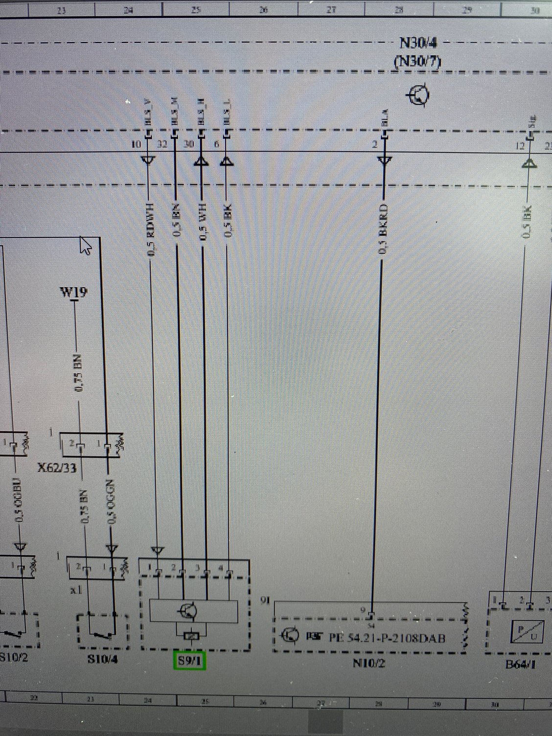

The wiring diagram shows the brake light switch going direct to the ESP module under the bonnet. Four wires, a power, ground, High signal and Low signal, I believe. See image attached. I assume it goes from the ESP module to the Rear SAM then.
When I check actual values for the Rear SAM it is registering when the brake is actuated, which tells me there is a signal going from the brake switch to the ESP module then to the Rear SAM.
But perhaps only one signal is needed for the Rear SAM (e.g., Low signal) and the issue is with the High signal. I am just guessing.
This image shows S9/1 brake light switch going direct to N30/4 ESP module:

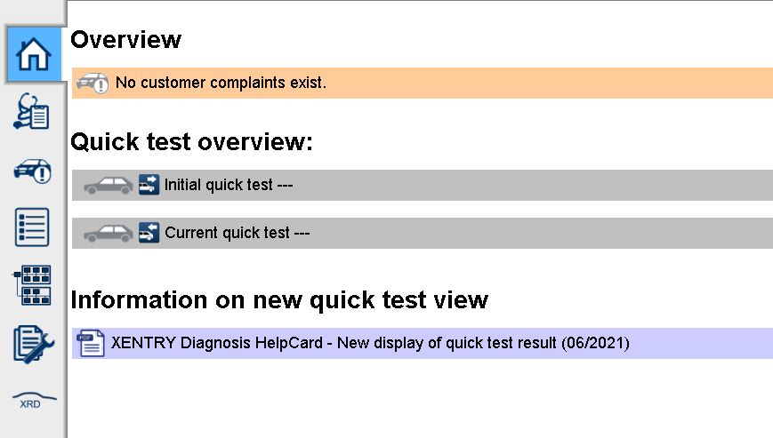

BTW, do you have the XENTRY Simulation application on your computer?
On this screen, before you run any scans, select Customer Complaints on the left (car with exclamation mark). Follow the instructions.

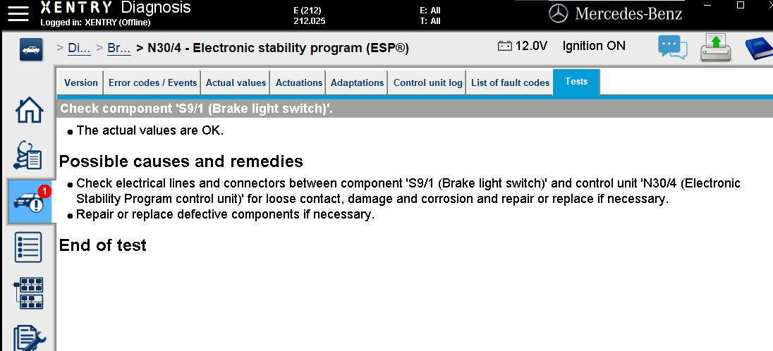

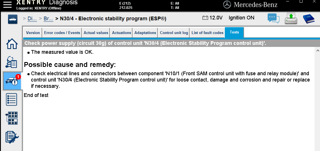

These tests are pretty much pointing to wiring and connector problems. Have you had any water intrusion or damp carpet?

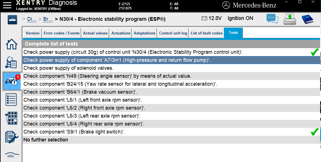

Here are the tests. I would do as many as you can. I was surprised to see Steering angle sensor, Yaw rate sensor, Brake vacuum sensor, etc. possibly affecting the brake lights.

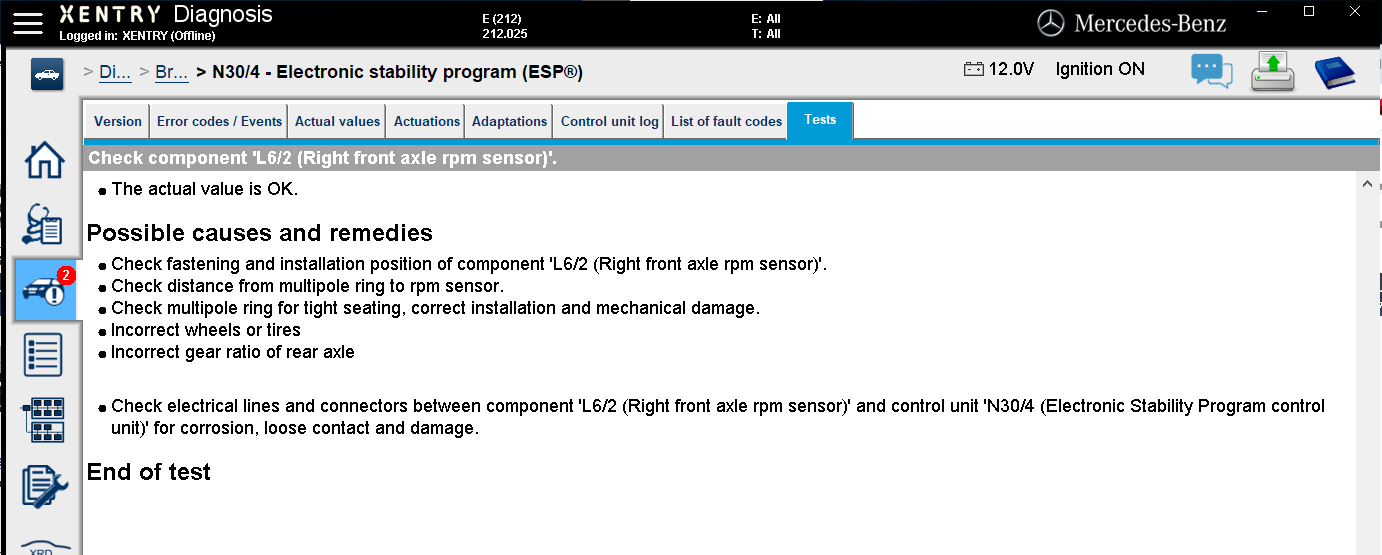

This is the results of a simulated test for the right front wheel speed sensor based on the OP's rim replacement and possible damage to the tone ring (multipole ring) or wheel speed sensor.

The diagram shows the Brake switch is actually a CAN sensor module directly connected to ESP but is causing faults... interesting!
So the input does not depend on SAM but ESP still complain it's faulty despite new sensor module.
Fault is with chassis side, causing sensor error!
