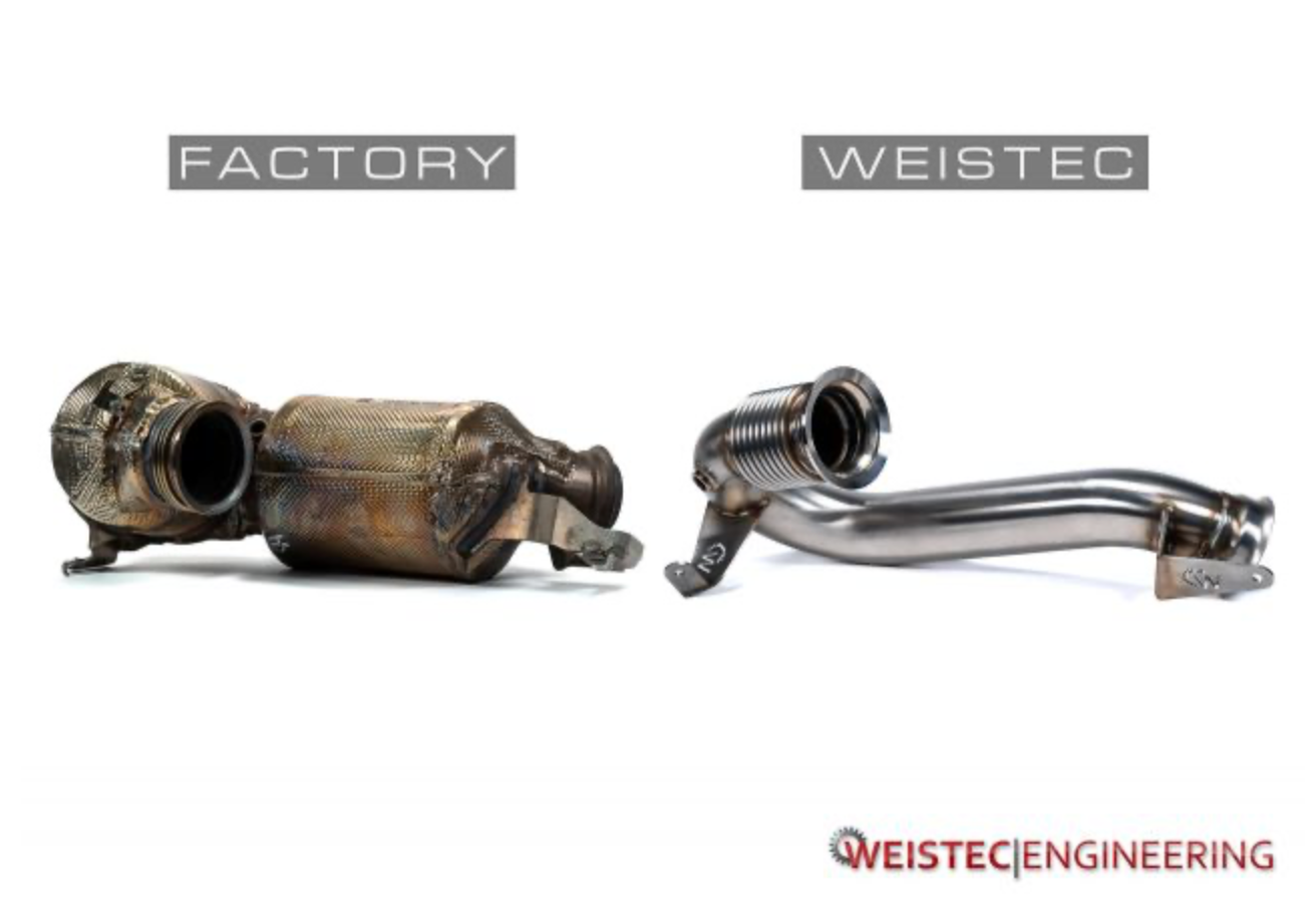

Regarding the Downpipe, it replaces the catalytic converter. I'm not going to consider that.
The car is plenty fast. Probably easier to add a JB4 or similer to get more power. Just add more boost. Turbocharging is great that way.
My goal is to address the immediate problem which is the mufflers by adding back a second muffled exhaust pipe from the passenger side muffler (just like earlier AMG'S). That should pick things up all by itself. If the new mufflers don't measure up with computer controlled flaps, I can always add the EVM.
Yes the EVM overrides the ECU's control, it shouldn't trigger any code in the ECU or a CEL, it overrides the control and controls the flaps/actuator. By stock, the ECU likes to close it as tight as possible when not needed.
