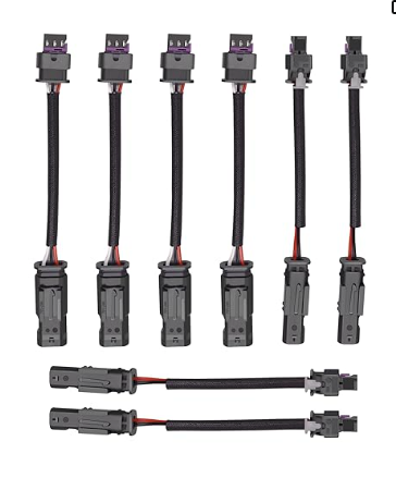

Yes, indeed: the standard wet cam sensors.
Did you install the cheap sacrificial extensions with your new CPS ?
They are used to help keep oil out of the engine harness.
I did not...didn't know about those. Got a link?
I don't know who is the best supplier...
I think I got mine from eBy + Amz which rarely stands for quality.
CPS : 3-Pins
(Sols: 2-Pins)
Here you go. These are actually very good — better than ones I had gotten off of ebay previously.
https://a.co/d/0ipYQYlV
