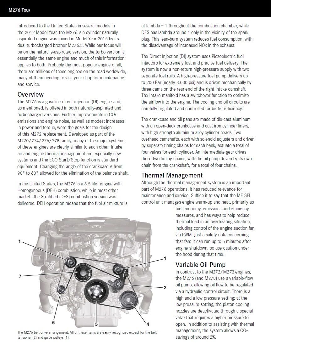

Originally Posted by JettaRed
A couple of your statements are not exactly correct. First, the 2-stage oil pump is primarily to reduce energy requirements to power the oil pump below certain rpm. In return, the consequence is reduced (theoretically) fuel usage. In practice, the fuel "savings" are negligible. A secondary consequence of using less fuel is to reduce emissions. Again, probably negligible...
Mercedes says 2% reduction in CO2:
This is the clearest picture I've seen which shows the location of the oil pump solenoid connector:
