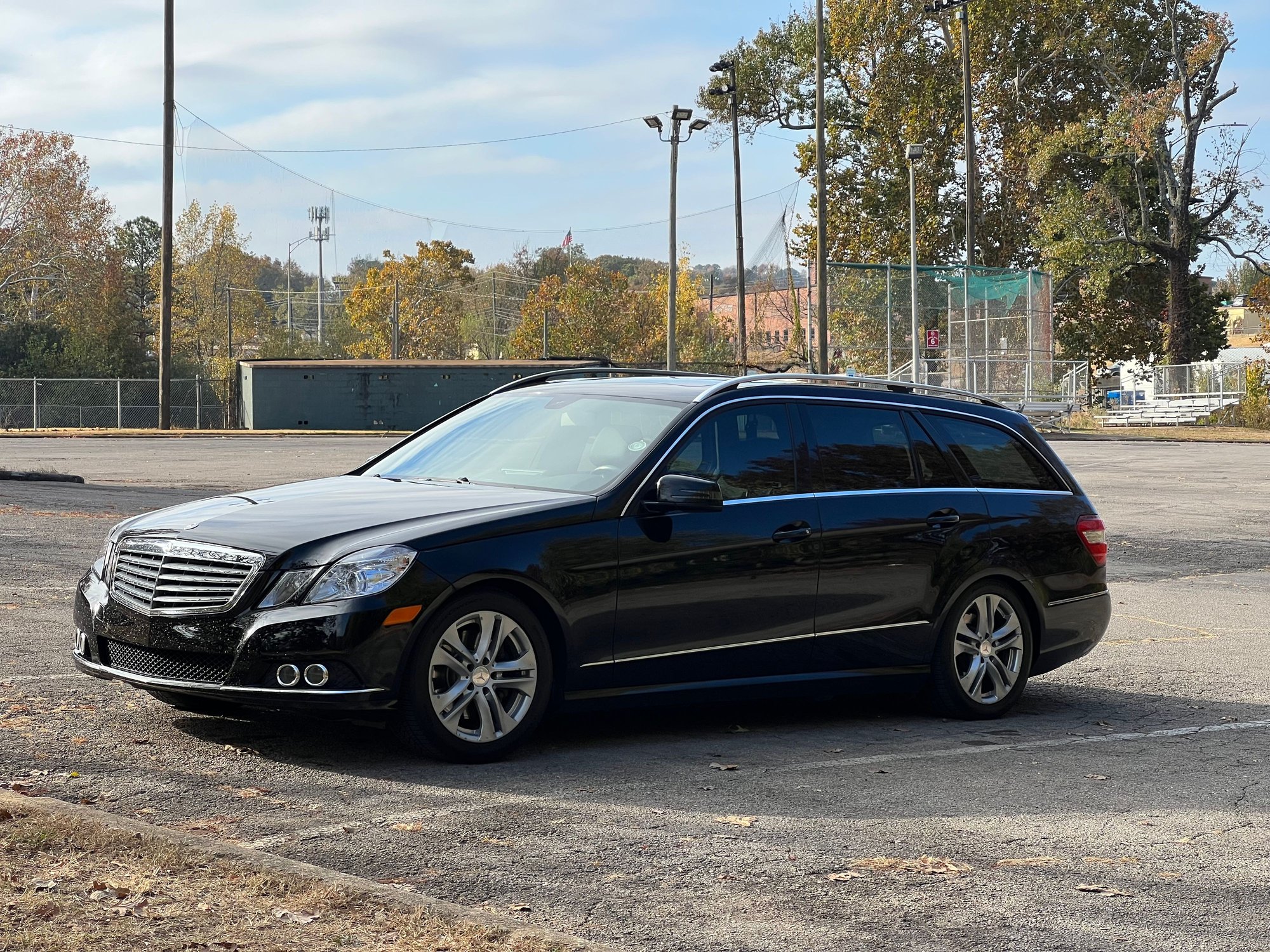

My 2011 w212 e350 has cruise with active braking to maintain set speed. Does anyone know if this braking feature or setting can be removed? I would prefer to freewheel coast or use a little engine braking instead of allowing the braking system to maintain set speed. Like “regular” cruise control.
EDIT:
My car does NOT have adaptive or distronic cruise. It has only speed control. I know how to press the brake or lever to operate the cruise control. I wish there were settings in the menu but none are here on the early w212 basic cruise control.
2011 e350 4matic. Betty White.
I have searched and search but can’t find an answer to this since most everyone is on to adaptive radar camera cruise in later cars.
thanks in advance!
Kyle

Nice wagon, by the way.
