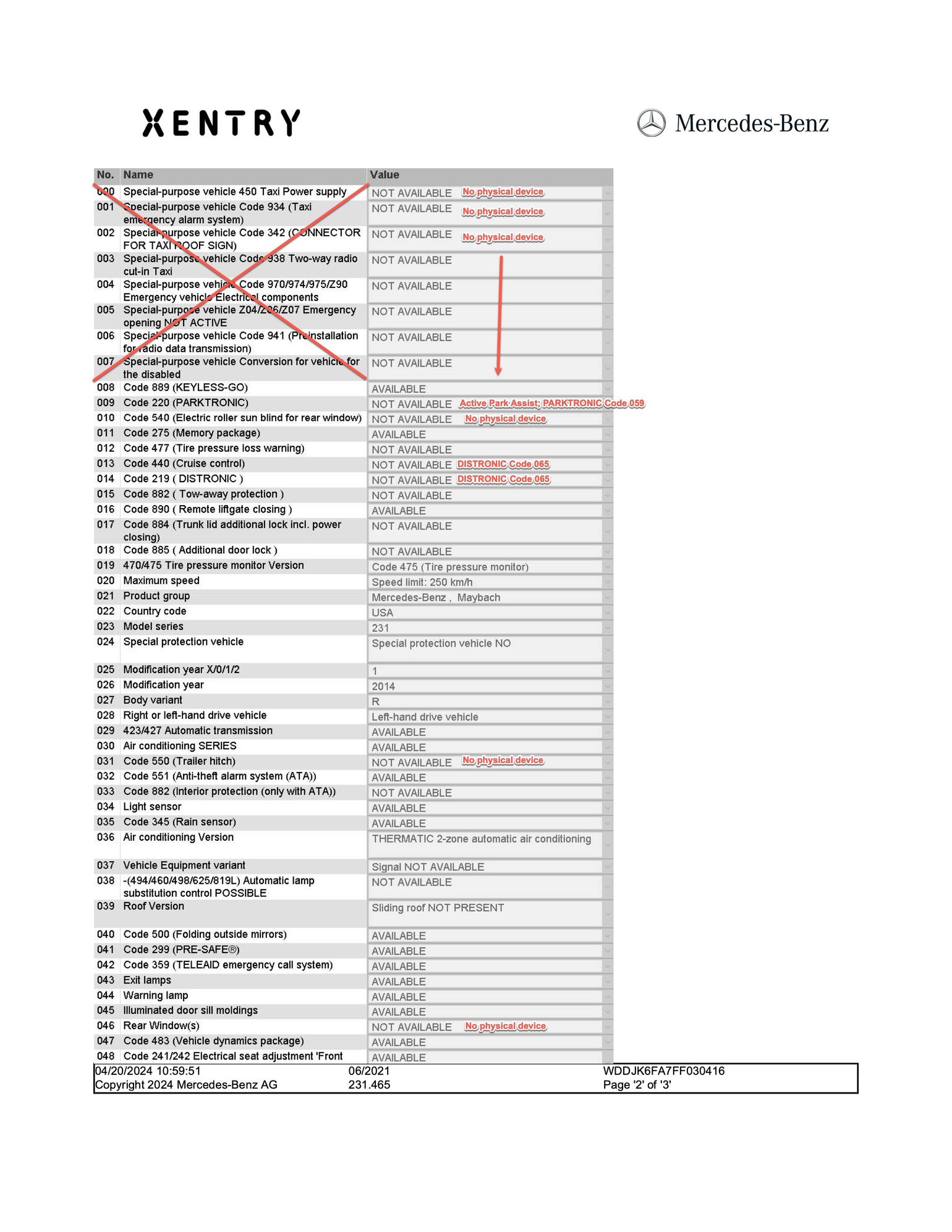

Old Apr 23, 2024 | 07:49 PM

I removed these instructions since they involved modifying a safety feature. I really don't know what else may be impacted by my instructions.
If you really want to remove the steering wheel jerk, please contact @BenzNinja who has years of experience making changes and testing them thoroughly before offering them to his members. Go to https://benzninja.com/special-tunes/ for a list of what can be done.

The Launch scanner is a great tool for the money with its ability to code features such as lane departure. I've noticed several variants that use "available " and "not available" descriptors, and have been confused by these. Thinking that perhaps these terms were stating that the coding option was either available or not, rather than the variant status, I avoided tampering with them (active or inactive would seem more appropriate, but maybe the translation from German to Chinese to English is the cause). Thanks for exploring this and revealing their meaning.

The terminology is confusing. And it may mean both. For some variants, the option is unavailable because of missing hardware. For others, AVAILABLE and NOT AVAILABLE may mean ON and OFF, or active and inactive, as you suggest. I'm not going to mess around for the sake of seeing what happens, but in this case, I wanted the steering wheel rumble, but not the braking and steering wheel grab. In some cars, such as my daughters Honda CR-V, the lane keep is much more subtle. But in my SL400, it seemed almost dangerous. So, exploring how to configure to turn the brake grab off was worth it.

Here are examples of how the terminology for Value means different things. Sometimes there is no physical device that allows a certain feature and other times there are alternative features, such as Cruise Control versus Distronic versus DISTRONIC (PLUS).

My '19 G550's owners manual describes the lane keeping function as having 3 settings available via the nav screen menu (Vehicle / Assistance / Active LKA / "Standard", "Adaptive", "Off"). There is no "Off" option on my truck. The only disable method is the push button below the headlight switch; and LKA is re-enabled upon every engine start. There are apparently variations among years and models, and JettaRed's caution should be taken seriously -- there are no guarantees that coding that works on one vehicle will work on another. And no matter how thorough and comprehensive a set of instructions is written, somebody will get it wrong. "Coding For Dummies" is a very short book that lists alternative forms of transportation for those who have bricked their cars. (no "lol" here, 'cause it's not funny).

There are two levels of Lane Keep Assist. One level is that the steering wheel simply rumbles/vibrates when you inadvertently cross a lane marker, mimicking physical rumble strips that may mark the side of the road or the center line. You can turn it completely on or off through the Instrument Cluster. The other level is pretty much the same except that in addition to steering wheel vibration, the car will also apply the brakes on the opposite side to force you back into your lane. The YouTube video below demonstrates how this works. You can also turn this feature completely on or off through the Instrument Cluster, but you cannot simply turn off the braking and accompanying wheel jerk while keeping the simple steering wheel rumble.
I was able to make changes that allowed me to keep the steering wheel rumble/vibration when crossing a lane boundary WITHOUT the brakes being applied and the steering wheel jerking the car back into its travel lane. But, because I don't know what else I may have activated or deactivated by making my changes, I chose to remove the instructions, especially since it seems each model and year of Mercedes tend to do things a little differently. I hope that clears things up.

Yes, that makes sense. What you are describing is the difference between Lane Keep Assist and Active Lane Keep Assist. The former is the standard system and if the car has the Driver Assistance Package it gets upgraded to Active LKA. So basically what you want is just the standard LKA. One way to do that would have been not to option the Driver Assistance Package.
Well, you get what you get if you don't special order the car. The other option is to configure the features to disable the Active LKA and enable the LKA.
