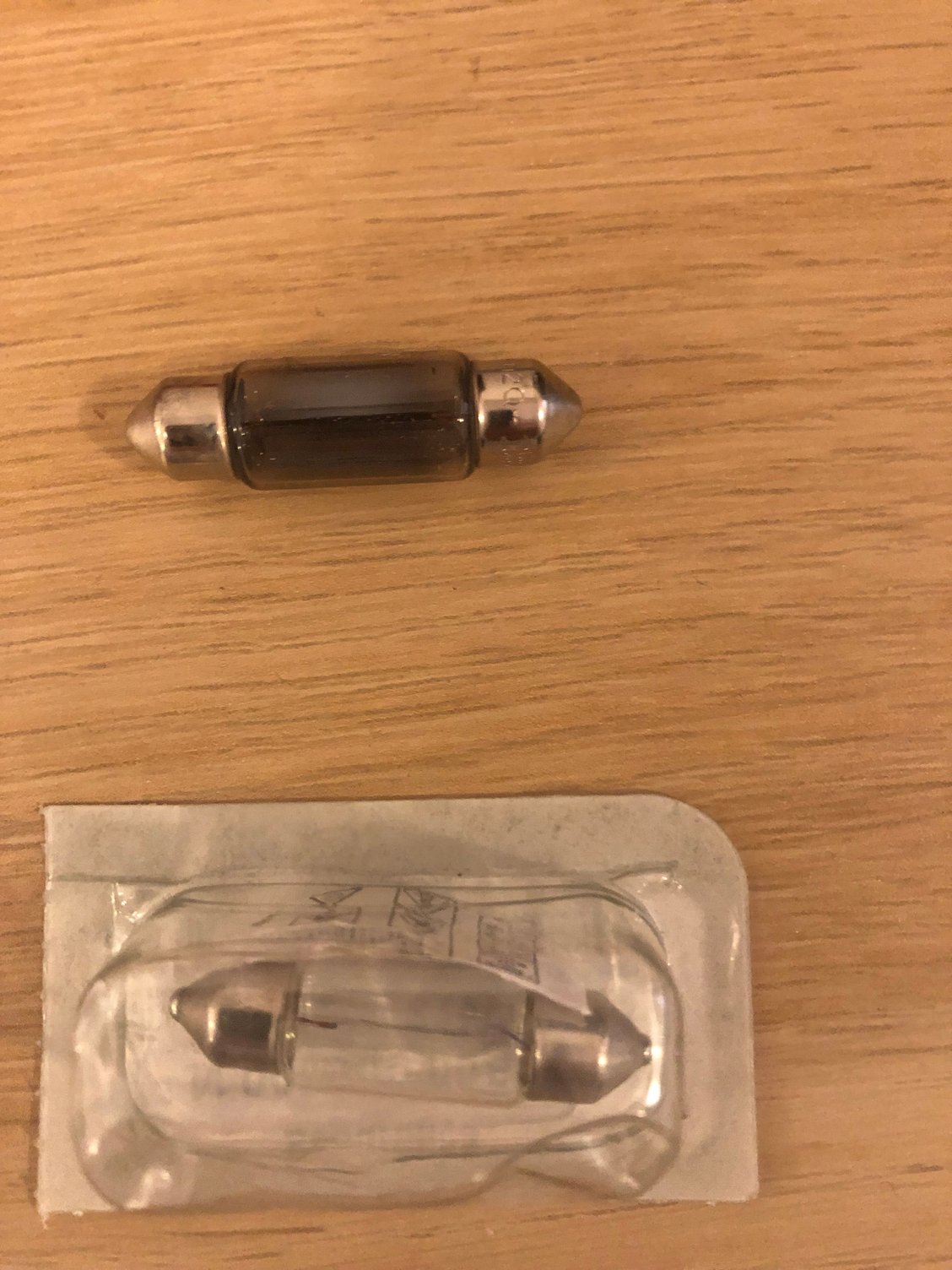

Well, I have been too busy to get back to that electronics place. The intermittent malfunction error continued along with the lamp working just fine. Until a few days ago when I then noticed the light was out.
It turns out the computer is smarter than we thought and was trying to warn me about a sick light, soon to die. I changed it this morning. The old one below is clearly toast.
Burned out bulb up top, new one from Mercedes dealer in plastic below.
