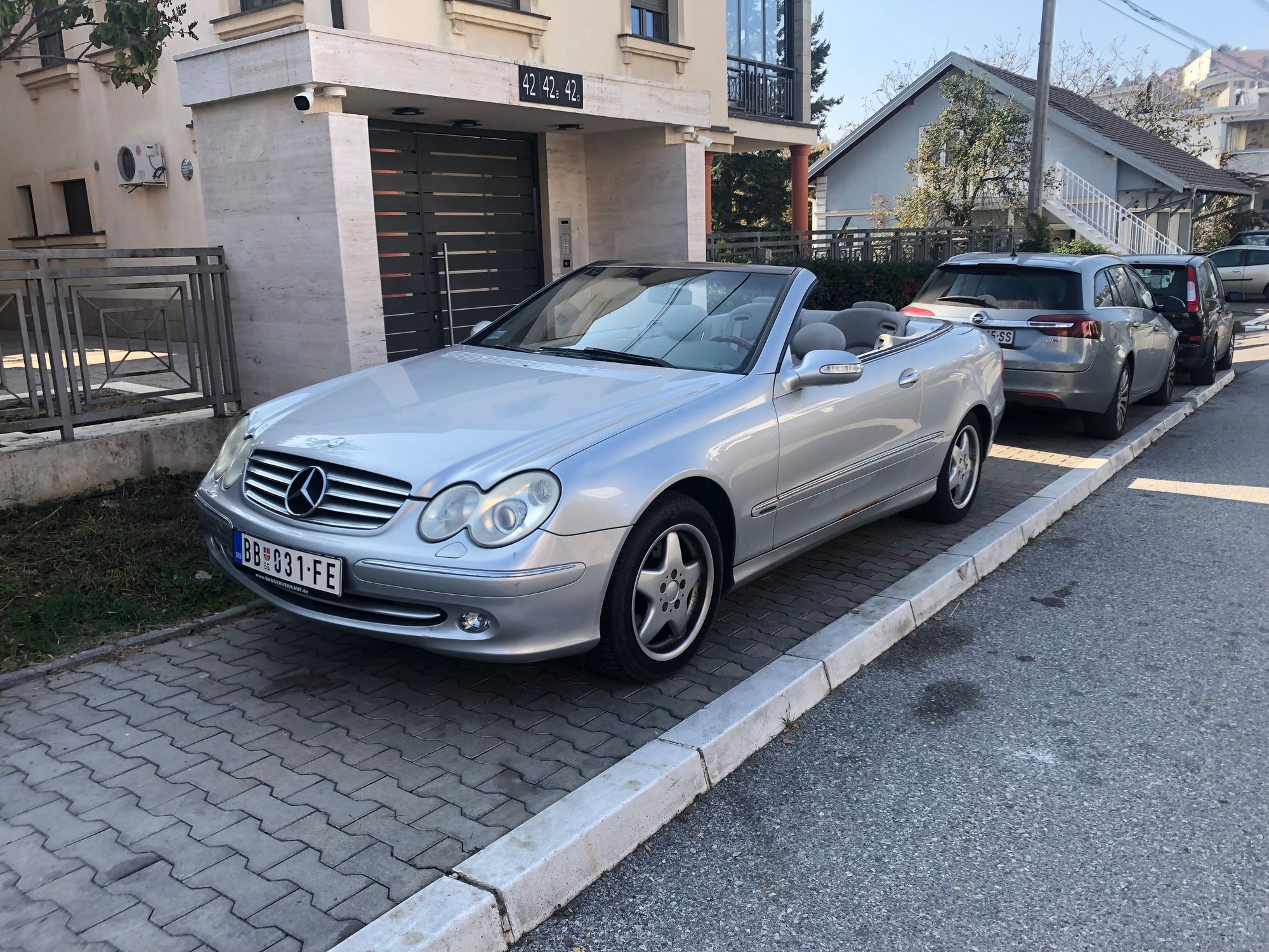

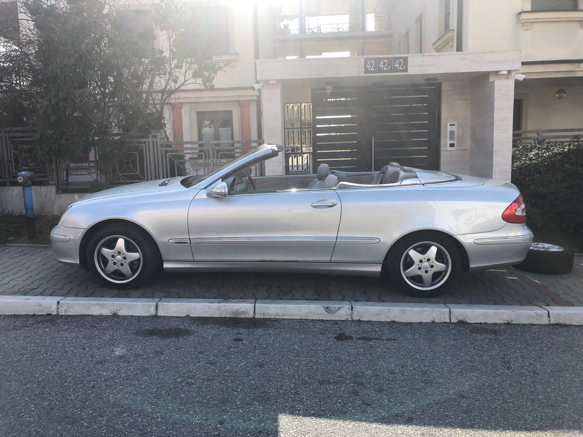

Really beautiful car! Timeless classic beauty. So glad you got her fixed.

It's always strange to see cars parked on sidewalks and people walking in the street! 🤣

FYI, parking over the sidewalk curb literally kills the front wheel ball-joints + bearings on any cars except perhaps trucks.
Try to use any type of ramp or wood post to help your front wheels transition to sidewalk height.

It's a Europe thing. One of the reasons the low-slung SL has the ABC suspension is so the car can be raised when traveling Old World towns and cities. I remember the narrow and cobblestone streets of Stuttgart many years ago, but I had my tank-like Volvo 245 station wagon, thinking how ancient these towns were. ABC was standard on the R230, but now is optional on the R231. I'm sure it is market-based and the demand has shifted.

Good to know thank you. That's one of the better curbs here. It's an interesting neighborhood I just moved to. Very fancy, a lot of foreigners, embassies, and rich locals. The whole street does the sidewalk thing here. Usually it's 2 wheels up and two on the street. I assume if they tried to change things the well connected here would object. I am trying to get a garage, or at least a proper off street parking spot but it is tight here. The last building I lived in was built 3 years ago. It had 24 units, and only 8 parking spots. Pretty typical of the new buildings, and the older ones are even worse.
