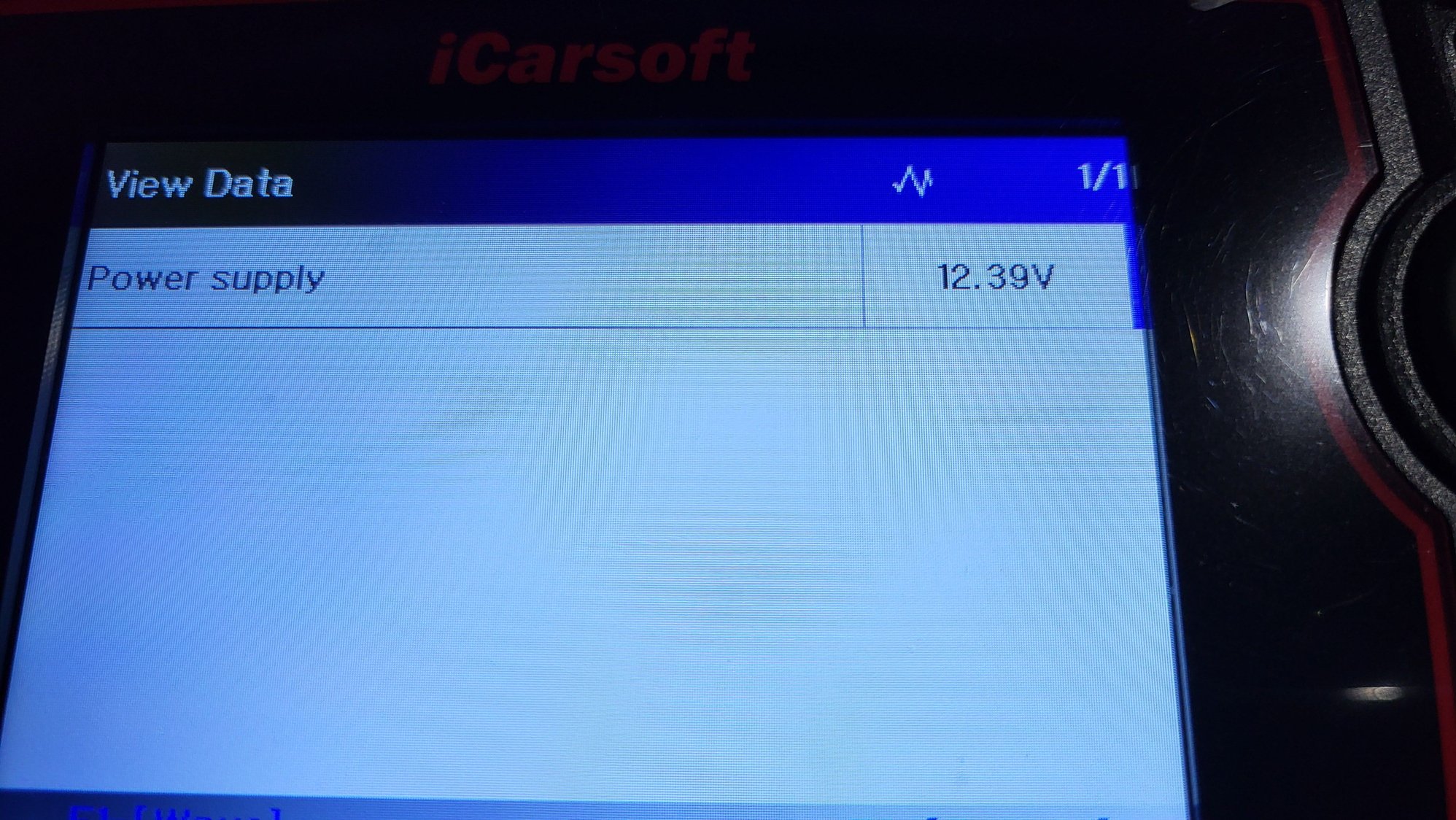

Well. This is interesting. I was just about to create an alternator/voltage thread (which I likely still need to) but was searching keyless issues as just today I received a friendly "key not detected" message while doing hwy speeds for maybe 10 seconds. It went away & no symptoms other than the message itself were present.
Once home, I did a scan with my iCarsoft MB V2 & had those same CAN faults also in my Central Gateway (which have been historic & intermittently shown up recently), along with an "Internal Electrical Fault" in my SG-FOND Rear Control Module, even though that was recently replaced and had a Xentry/Star session with my Benz indy who I turn to for that which I don't have tools for, like alignments or Star. Although my issue may be far more nuanced, at least I can now pray that my keyless go module is intermittently sucking the life out of my battery & removal and/or replacement of the fuse is in order.
Jetta, any chance you've ever noticed a significant voltage drop just from unlocking and opening your doors? These voltage issues make your soldering method quite tempting. If all else fails, at least the car can just get the torch!!
What other modules are reporting faults when your Keyless becomes unstable ??

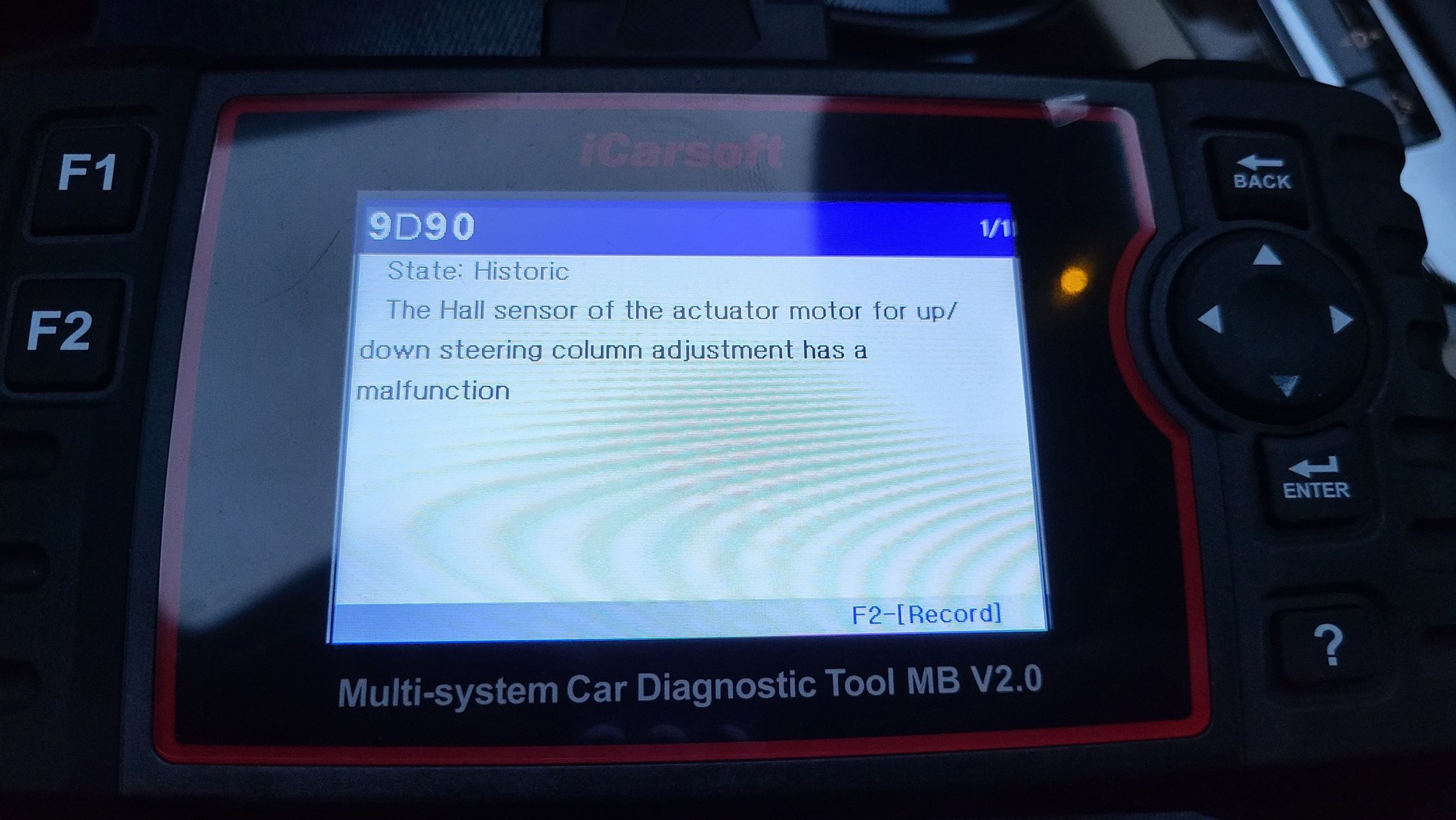

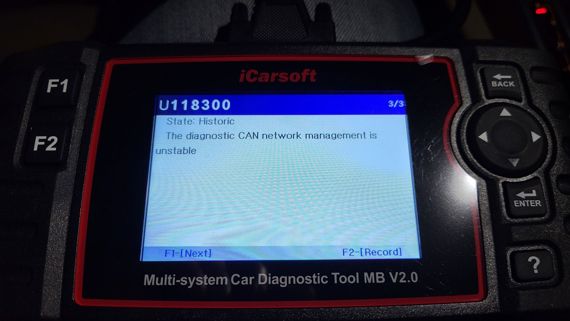

During this incident, the only other info that grabbed my attention was a constant fluctuation of 12.3 to 12.5v reported by EZS Electronic Ign Lock(N73). I had the service menu active and when iCarsoft via EIL was showing 12.3 - 12.5v swings, the dash was giving more consistent 12.6 with occasional 12.5 drops at anywhere from -1A to -6A.
On another keyless incident in which the car was either hesitant to unlock via door handle or hesitant to start via start button (forget which specifically as I've had both somewhat recently), I had a Hall Sensor fault for the up/down actuation for steering column. "Comfort access". The column did function, but with audible mechanical clunks & crunches that day. I do believe I've seen you mention this in another thread regarding lubrication of part of the mechanism, but it hasn't been a regular occurrence. The code was historic, cleared, & never returned. During this incident (and other times when doing routine scans without symptoms), there was also a 3rd Central Gateway fault along with the other two that Jetta first mentioned in the 1st post here.
I'm still going to make that alternator/voltage thread because I have a bit more to the story, but this is everything related to Keyless. Really hoping I can narrow it down to this system, although I haven't really started digging too deep yet.
From EIL Module (N73)
From ESA-DR Electronic Seat Adjustment Driver (N32/1)
Central Gateway 1
Central Gateway 1
CGW 2
CGW 2
CGW 3
CGW 3

That's pretty comprehensive detective work
You can ignore the "Diagnostic" faults of CAN-D - Its caused by OBDII disconnects... ok.
The most significant is that low voltage you captured. It's sort of "on the fence", I mean not super low in 11.xV but it's messing up your CAN-B.
If you want to test "normal voltage" with stable 14.1V and chassis reboot then consider ALT-LIN for relief.
The whole CAN-B benefit soldering door modules loose pins including KEY-Go module itself.

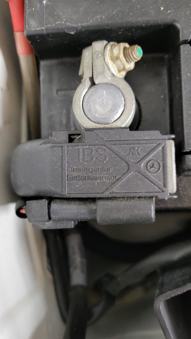

I do have the IBS on my negative post as well as a fault in the ECU/ME from unplugging the ALT - LIN. A communication error with starter or alternator. Also, when 1st getting the car before I touched anything mechanical or electrical, I tried out the IC voltage/current display before & during a trip probably at my 1st weekend or so of ownership. I observed the (then) steady 12.6v readout under normal driving & the "regeneration" of 14.1v give or take during decel, coasting, & braking. Also, the voltage/current increase during R or when A/C set to max.

Hope this story helps someone
Old vs New
Old vs New
Factory Alt
Factory Alt
IBS. Sister's late model W203 has conventional Alt, so she shouldn't have this?
