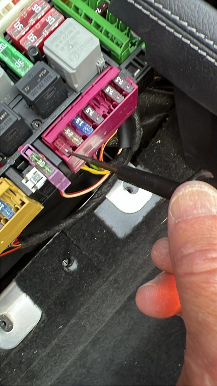

For no apparent reason, my KEYLESS-GO (KG) totally stopped working in my 2015 SL400. Neither of my key fobs were able to lock/unlock or start the car with Push Start. When I got into the car, the fobs were not detected. However, the fobs did work in the ignition switch to start the car the old-fashioned way. (I thought I was living in a 3rd World country and was embarassed someone would see me physically inserting and turning a key.)
Scanned for codes using my LAUNCH Creader Elite 2.0 BENZ -- no faults/codes. Broke out and fired up my XENTRY from @BenzNinja -- no faults or codes (per se) but also no KG module was detected. However, there were two CAN Bus related faults in Central Gateway (CGW).
I reached out to Peter (BenzNinja) who suggested I check the fuse. The fuse was arguably good (not blown). (In the R231 cars, the fuse for KEYLESS-GO is #74 which is in the fuse panel behind the passenger seat. It is a 10 Amp fuse.)
I replace the fuse anyway. SURPRISE! Everything worked again. I checked continuity on the removed fuse and it was good.
My conclusion is that because KEYLESS-GO is ALWAYS powered, simply turning the car off and on does nothing to the power going to the KG module. But removing and replacing the fuse performed a hard reset of the KG module.
So, if you find yourself in this situation, remove and reinsert the unblown fuse and see if that resets everything.
https://cimg7.ibsrv.net/gimg/www.mbw...943607d370.png

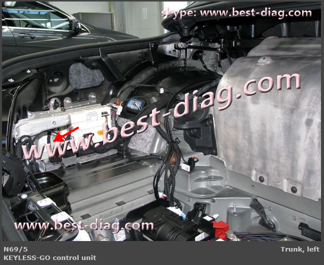

Here's the issue. Many of these controllers are "buried" under a bunch of stuff. Here is the KG controller for the R231 SL. I will look to see how hard it is to get to it. I know already it means taking the trunk apart. I will also check the WIS for instructions.

JR, we'll help you fix this under 30mn.
This is a 10mn job + 5mn soldering + 10mn documenting pictures .
In W212 KG lives up above R-SAM
Passenger trunk side
Are you okay with soldering skills + Equipt ?

KG Location
This picture shows the driver side trunk...
hidden behind the metal sheet
attached on the back of the metal sheet
W212 KG is passenger side, tucked away hidden behind that metal sheet.
It's about the size of a cigarette pack... small-ish inside a flat white plastic enclosure.

I'll take a look at how to remove all the inside trim pieces. This is what I am faced with. (Why do pictures always show all the dirt?)
here is your shortcut: don't remove the carpet!
Do you see where carpet top is tucked under the rubber gasket surrounding trunk area?
Leave the car in place by inserting your hand between rubbert seal and carpet near F-SAM.
