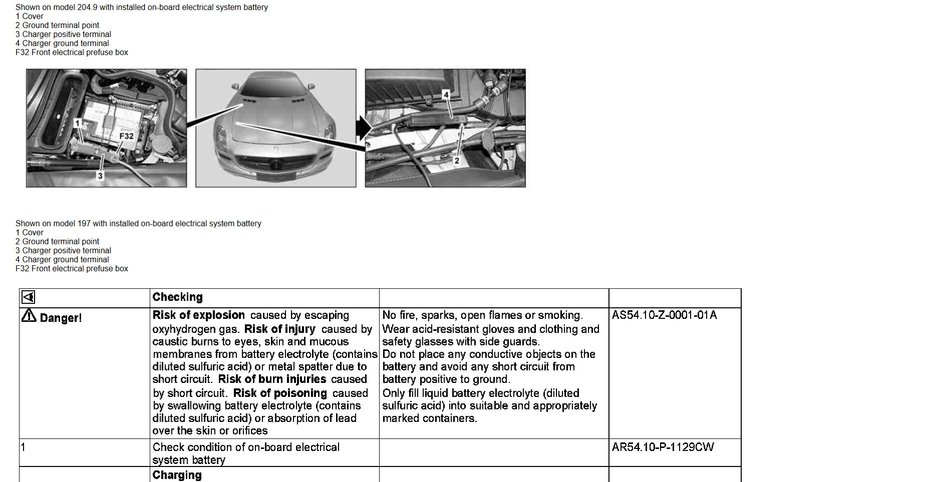

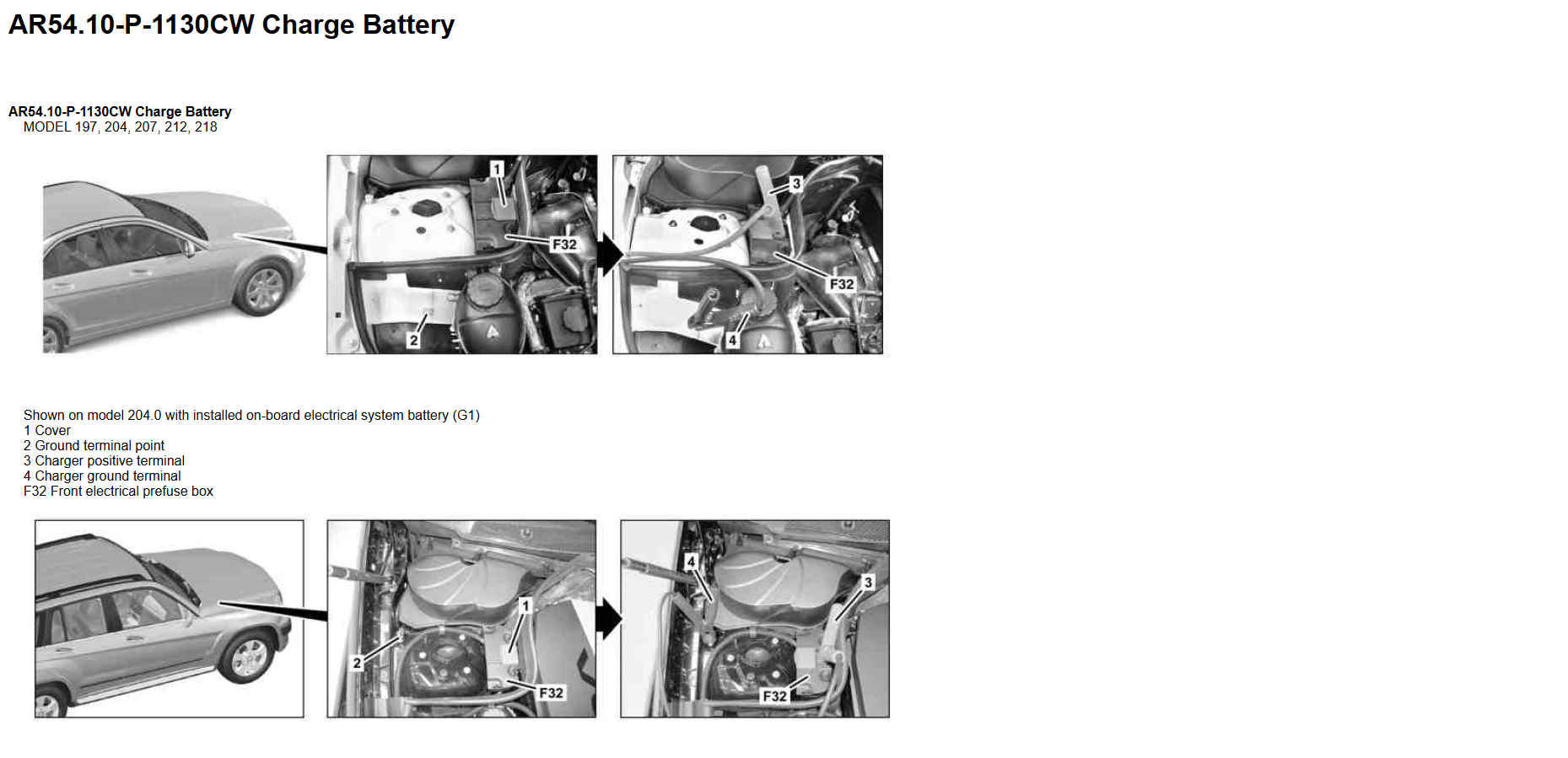

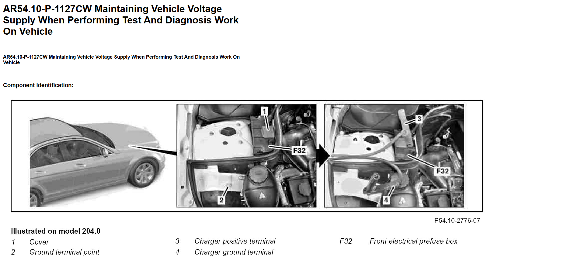

I noticed in the MB manuals it will say to connect a battery charger of min 30amps while using a scan tool for diagnostics, so it seems ok to use.

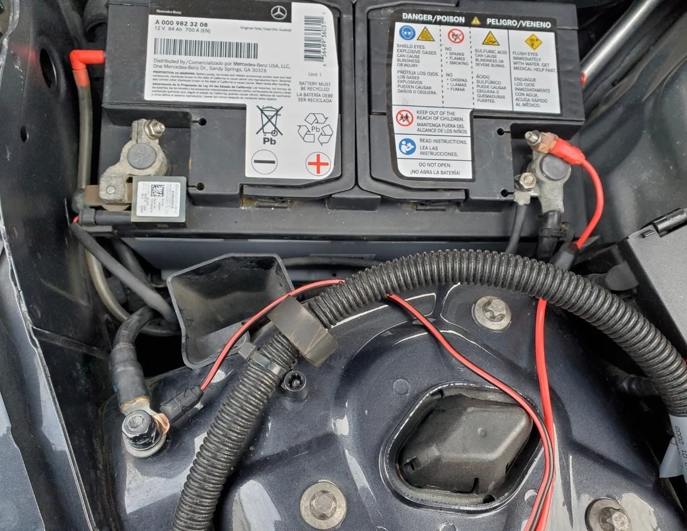

I have a Noco Genius 5 I will hook up once in awhile for the "maintenance" its supposed to provide to batteries.
I have a W204 and removing the box above the battery is a pain so I instead hard wired the charging harness in. I connected positive directly to the battery post, I connected the ground to the chassis where the battery ground wire is connected. When I want to use the charger I fish the extension cord thru the grill and place the charger behind the headlight in the engine bay, this way I can close the hood.
From my research the ground should not be connected directly to the battery, it should be connected after the battery sensor monitor. I guess this way the cars computer sees whats going on.

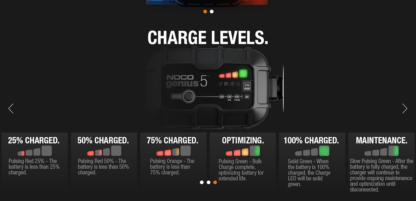

Old Dec 5, 2025 | 01:19 PM
TimC300's Avatar
Joined: Aug 2023
Posts: 3,687
Likes: 1,110
From: MA Coast

My Noco Genius 5 seems to take 3hrs to do its thing before it goes into "Maintenance" mode. Most of those 3hrs the bulk charge is complete and its supposedly optimizing the battery whatever that is.
I originally bought the Genius 1 and that took over night to charge the battery it was slow. I then bought the Genius 5 because I got it for a really low price on Amazon "Used-like new". I will say if I already didnt have an ac/dc power supply I would have bought the genius 10 because that works as a power supply also.
I will hook it up if I havent driven the car on the highway for over a week or two. I mostly do short local driving around. Hook up the charger and let it do its thing until the green light is flashing and remove it from the car.
I bought the Ancel BM200 battery monitor awhile ago and used it to see what my battery was doing. Thats when I noticed how quickly the car charges the battery on its own. Even short trips it was charging fast.
"optimizing the battery" is balancing the cell voltage to reduce internal resistance. This is done by over volting cells under low current.... this is when lead-acid battery off gas hydrogen!
CTEK calls that cell-balancing "AGM Mode" to help regen batteries used in deep-cycles applications, usually AGM Batts.

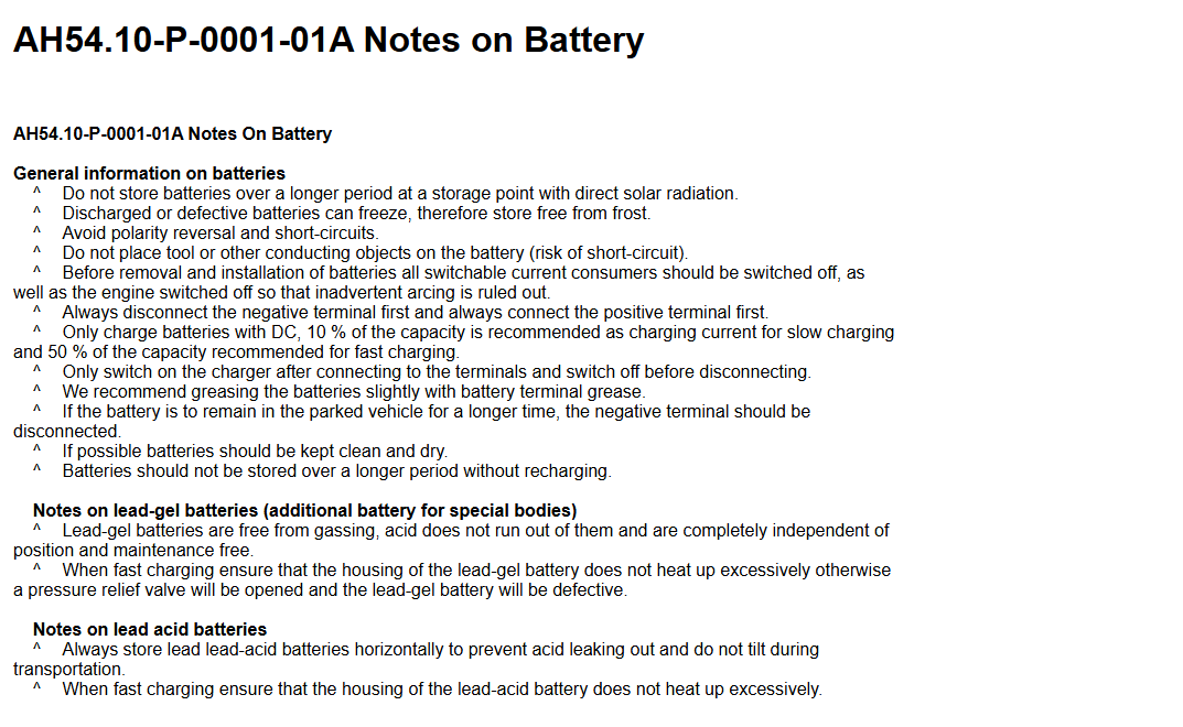

It's best to follow all manufacturers recommendations (MB + VARTA + CTEK) to always disconnect Batt (-) side before charging and in particular the 15.xV "AGM-Mode".
These chassis are really voltage dependant ie. ALT + BATT in best shape. It's usually well worth the troubles.

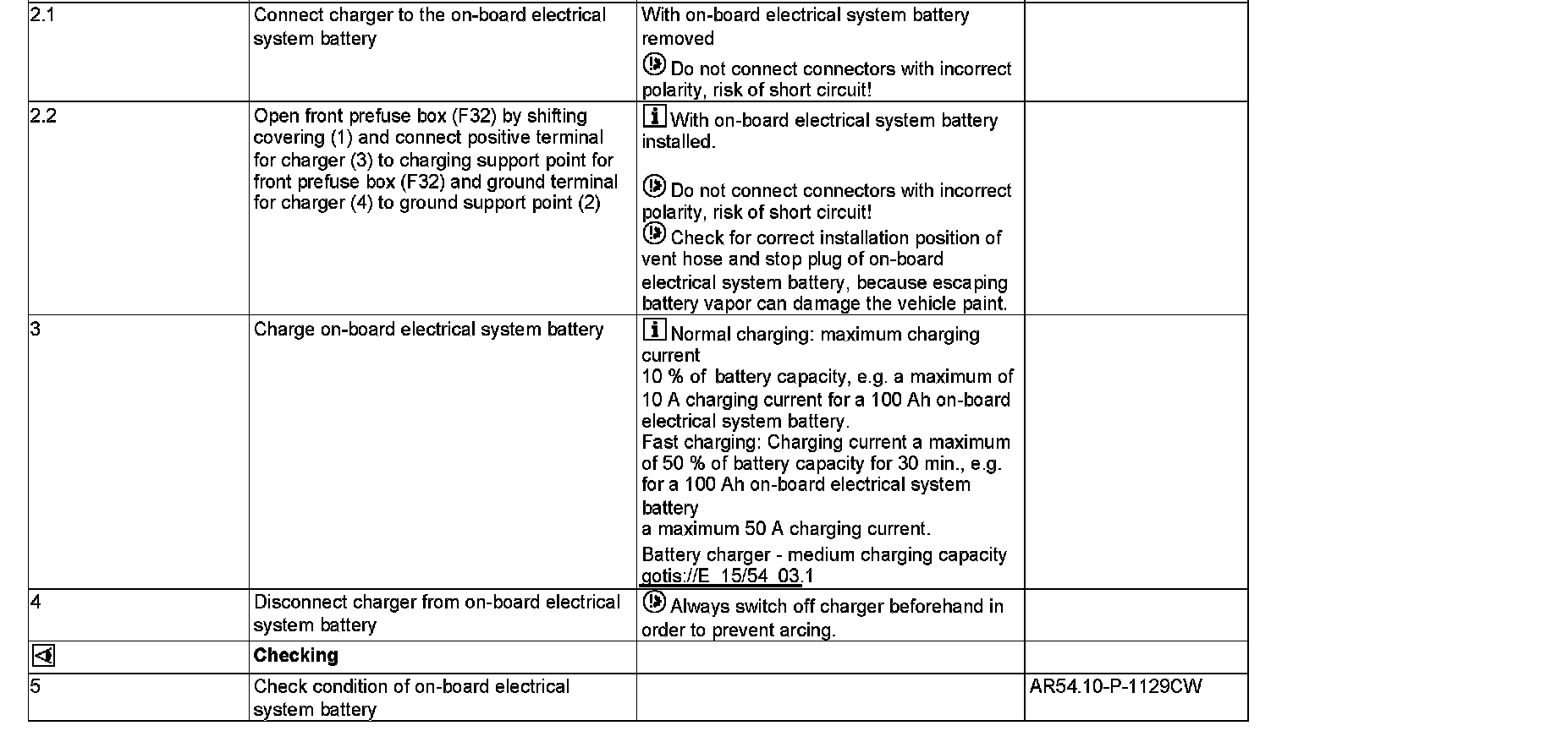

According to the MB manuals ive been reading thru in 2000 MB switched to AGM batteries.
The charging info I come across show using the charging/jumping terminals. On mine I hooked to the positive battery terminal connector because I couldnt figure out a way to hard wire it to the F32 jumper terminal.
