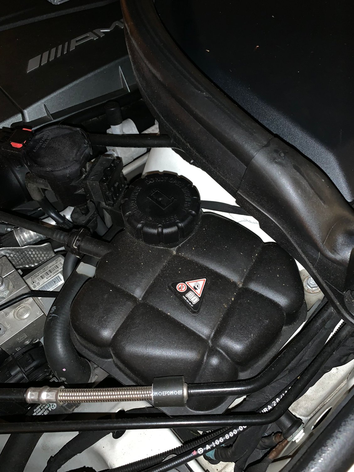

New to the ML world. Lifted the engine center plastic cover and saw this little tank. What is it? Is it supposed to be empty?

It's a coolant recovery tank. I have kept them full on my various vehicles. I'm not sure how MB uses the to manage coolant level. Bone dry would raise questions to me.

So two expansion tanks?
This one is at the right level. Should I add coolant to the other one below the engine cover?
This would be the first car I own with two expansion tanks. The one above is what I’m familiar with.

It's the tank for the intercooler coolant, which is a separate circuit from the engine cooler. If it's dry you should probably have it checked. Have you done any wide-open runs to see if you're suffering from heat soak?

I haven’t really push it but for a few seconds at a time. It runs great.
Thanks for your reply. I’ll go look again, it may not be dry, I hardly looked at it.

Keep in mind that this system should never get very hot (intake air temperature should be kept to ambient + 20 degrees) so it's not an expansion tank. Unless there's a leak you wouldn't expect the level to drop much. It would be good to see how high your IAT goes under heavy load.

IAT? How to measure?

Intake air temperature. An ODB scanner that you can get for around $100 will display it in real time. Or, if the tank is empty, let a shop diagnose it.

Got it. Thanks. You’ve been very helpful!
