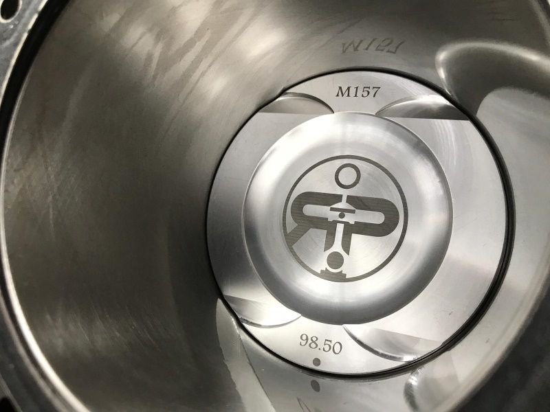

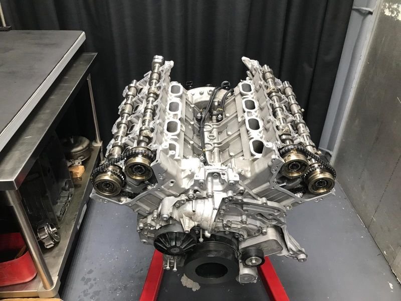

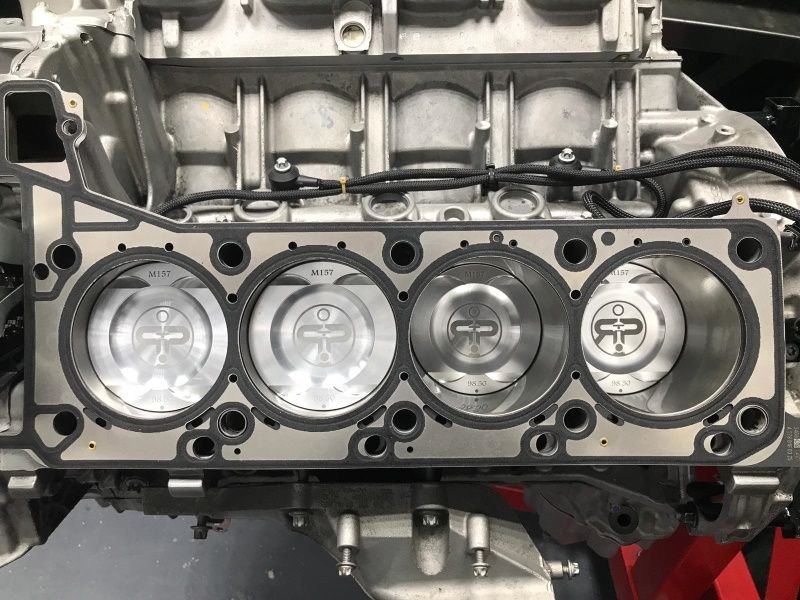

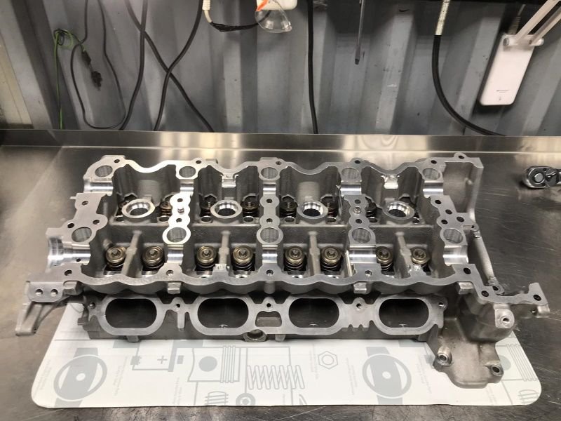

We are currently building an M157 engine for one of our clients cars ML63 AMG. I will update the photos on my first post here. Hope you guys enjoy to see such work, if yes let us know and we will be happy to share it with you.
Like always we are using Darton MID Sleeves, on this project here we are running a slightly bigger bore, 98.5mm (+0.5mm vs OEM)
to give an idea of the quality, the weight difference in the internals all 8 x Rods all 8 x Pistons is 0.1gr to 0.2gr only.
- Block with Darton MID Sleeves
- Connecting Rods Golden Line by ItalianRP (Connecting Rod Bolts L19 by ARP)
(Material: 35NCD16, 10% stronger than 300M, Material Strength 1.900Mpa, Hardness 52HRC)
- Pistons Platinum Line by ItalianRP
(Material: Billet, machined from 2618Al
Modification List:
Build Engine
Turbo Upgrade
Air 2 Air Intercooler System
Catless Downpipes
Methanol Kit
Cold Air Intake System
ItalianRP Platinum Line Pistons (Billet)
Bore: 98.5mm
Cylinder Head ready for installation
setting timing
