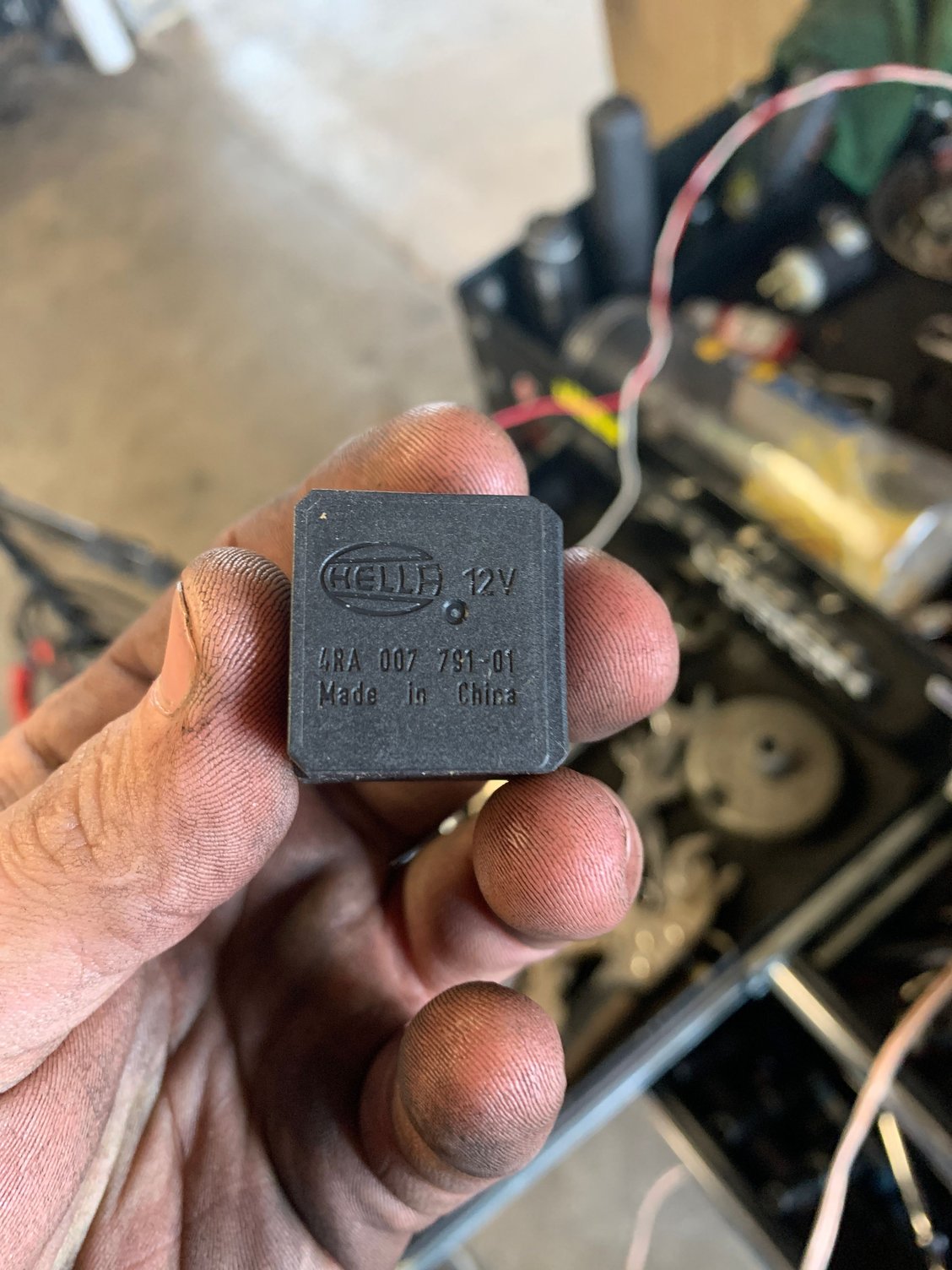

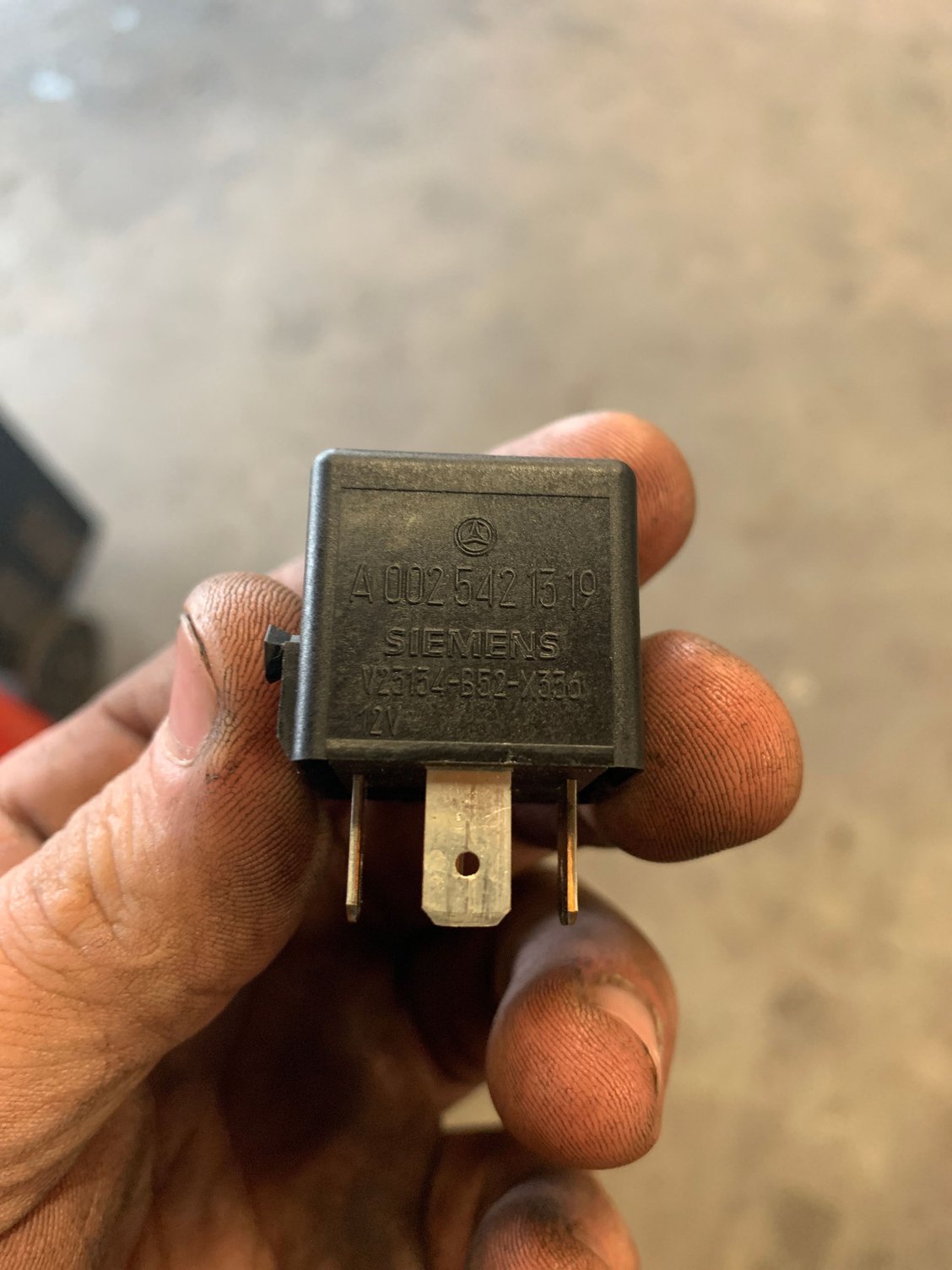

the oe pump numbers are, 7.21960.04
the new pump I have is e8929
the oe relay is
And the new relay is

Can anyone look up these numbers of the fuel pump and also the relay .To make sure they are for the said vehicle . Help !

A0025421319 appears to be a valid part number for your vehicle.
A2024702641 sensor with pump, appears to be the fuel pump for your vehicle
The pump part number you provided is not valid. All of the preceding info is from EPC.
