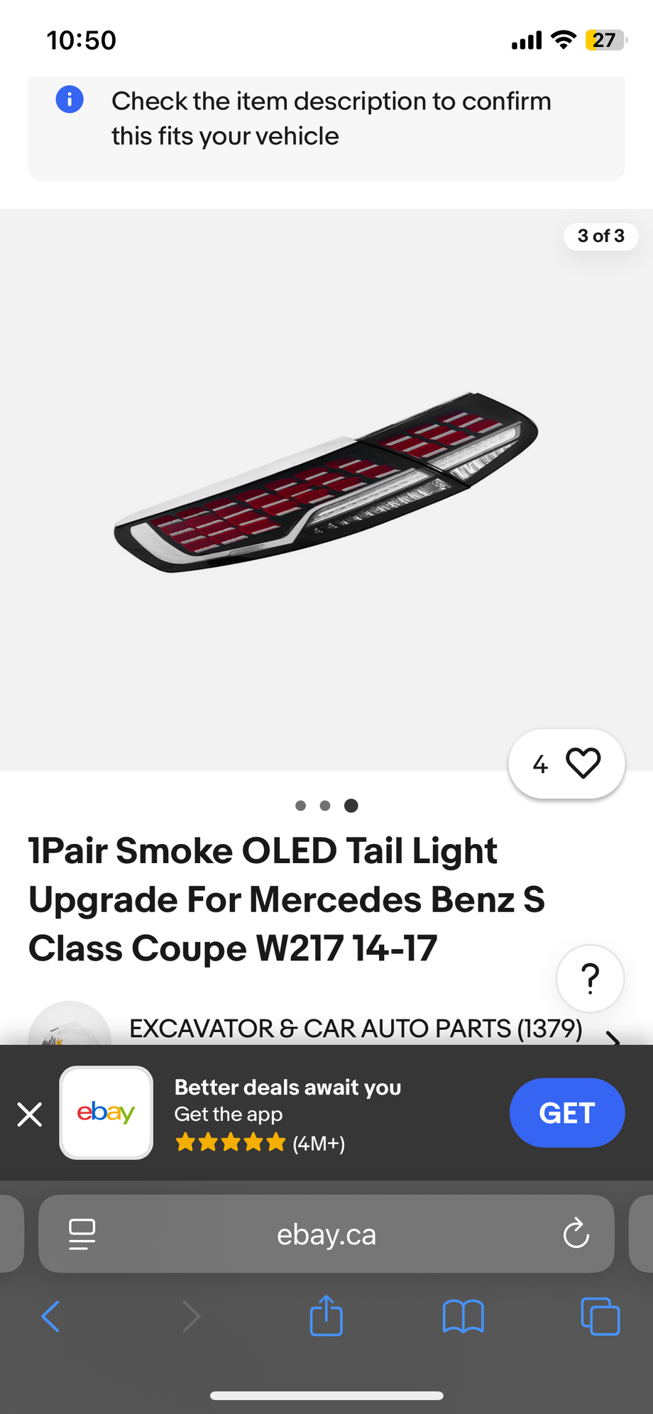

Smoked version oled tail light
I found some smoked version of the oled upgrade, has anyone tried these or know how they look on the car?
https://www.ebay.ca/itm/395031895035
It's been around for a while. Not MB parts. I would not put it into my car. Plus I don't like the color theme
