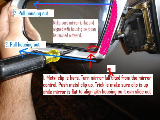

DO you have to take off the spring that shown on your pic? I pop up the clip but it doesnt come all the way off

100 Dollars for the LED lights.(EBAY) Installed them in 20 minutes.
1. Push mirror forward as seen in pict.
2. Stick thin long flathead screw driver underneath mirror(torwards front) and pry clip up so Mirror Cover housing slides off.(be careful)
3.Take mirror inside house or work area and clean up before installing new strip
4. The led strip has 2 screws that need to come out than pull out old LED strip from mirror cover...New strip will pop in
5.Once new strip is screwed in cover take back to car to plug in and mount
6.The Led strip will plug in the 2 center inputs of the 4 prong female connector located on the back of housing on car.
Let me know if you need more help.

OK, I finished doing it a couple of days ago. Wished I had the camera with me to document for you guys.
There were 2 sources, I bought the one (forgot name, can look up later) that wasn't from HK not b/c if they were a bad company or anything but the other one was local.
Regarding the fast blinking after plugging it back in. I did a couple of things that were mentioned before and it eventually worked. So try a couple of these combinations:
1. Turn on hazard lights with original blinkers, take them out while they are still blinking, plug in new blinkers.
2. Leave original blinkers in, turn them on, unplug them, then plug new one in.
Make sure the wires don't catch onto anything and tucked away b/c it came apart when I pushed the housings in to close it up. I had to take it out and resolder them.
If you guys have questions, ask away since my memory is still fresh
Borrowed from benznodubs with added text

I am not sure if the mirror housing for the W215 CL is different from the S class. It shouldn't. However...
I followed the instruction carefully and tried to install my newly acquired aftermarket lights. The problem is, even after carefully prying the metal clip up inside my driver side mirror, the housing would not come off. Period.
No matter how hard I tried to slide off the mirror housing, it simply would not move an inch. I even had the mirror positioned inwardly as directed. It still wouldn’t come off. I was afraid to break something so I gave up and moved the metal clip back in its place.
Here's comes the problem. My driver side electric mirror glass is now not moving smoothly at all. When I tilt up the mirror or move it to the right side, the motor would not turn smooth and it seems as if it would catch itself jammed up just slightly before it moves further again.
I did push everything back in place and try to apply equal pressure on the surface of the mirror glass to make sure that it's intact to the motor. However, the problem persists.
Does anyone know what I can do to solve this problem?

I figured out how to install the driverside led but the passenger side housing is hard to get off. Are there any tricks?
Old Mar 23, 2008 | 02:10 AM
No, it is the same.
See that silver colored metal clip at the bottom of the housing in this pic? The top part of that clip needs to pushed down(with a flat head screwdriver) to slide off the housing, and make sure the mirror is in a positon so the housing slides off past it. (picture is of Al's car)
