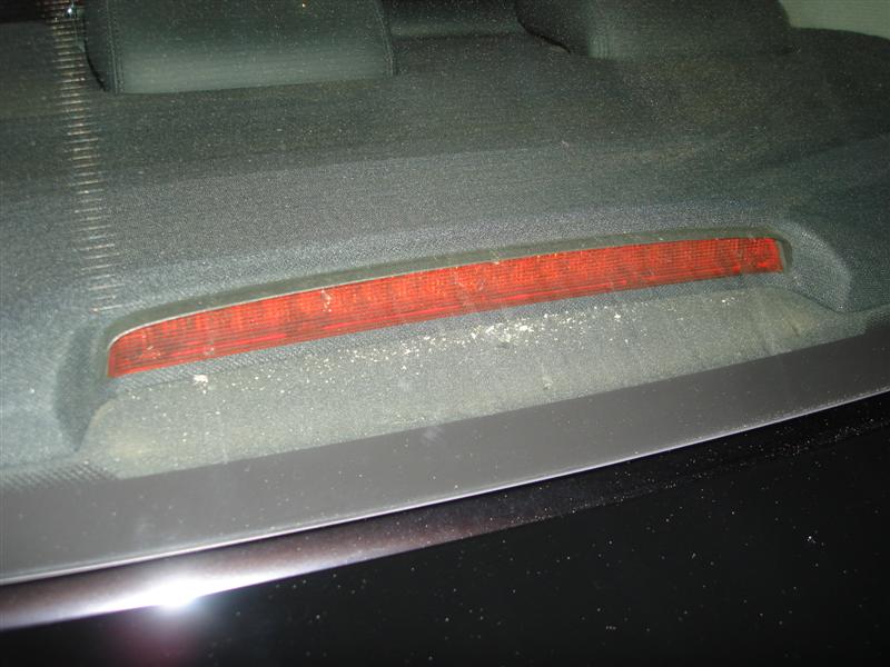

Yeah... because they were cleaning the rear window with some real liquidy stuff, alot of it dripped down the glass and it's all nasty by the brake light. Also, by there the brake light is, there is alot of crap between the glass and the brake light unit (like dust and it looks like ashes of some kind )
I want to clean it out it's nasty.

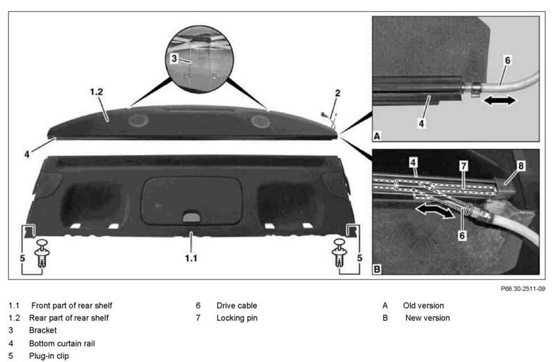

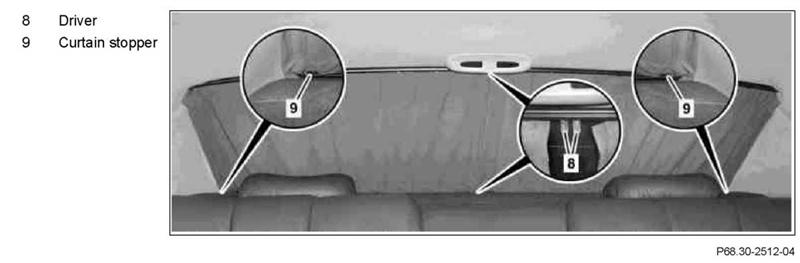

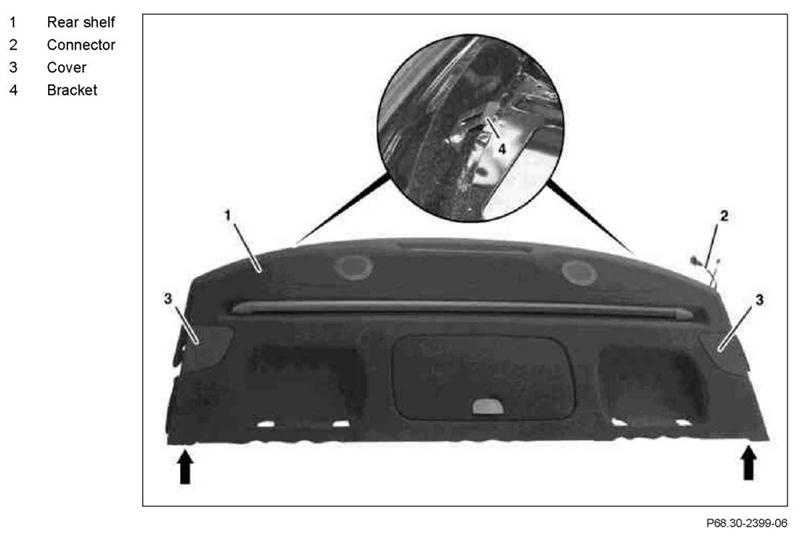

I am looking at the manual but it's not making much sense to me... I am at work now, so I'll have to check out the shelf when I get home, but I don't remember it being that easy to take apart...

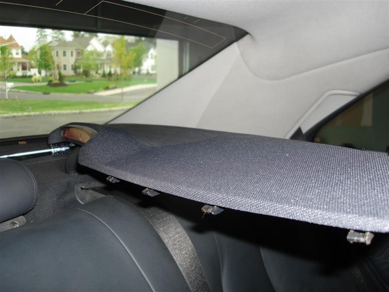

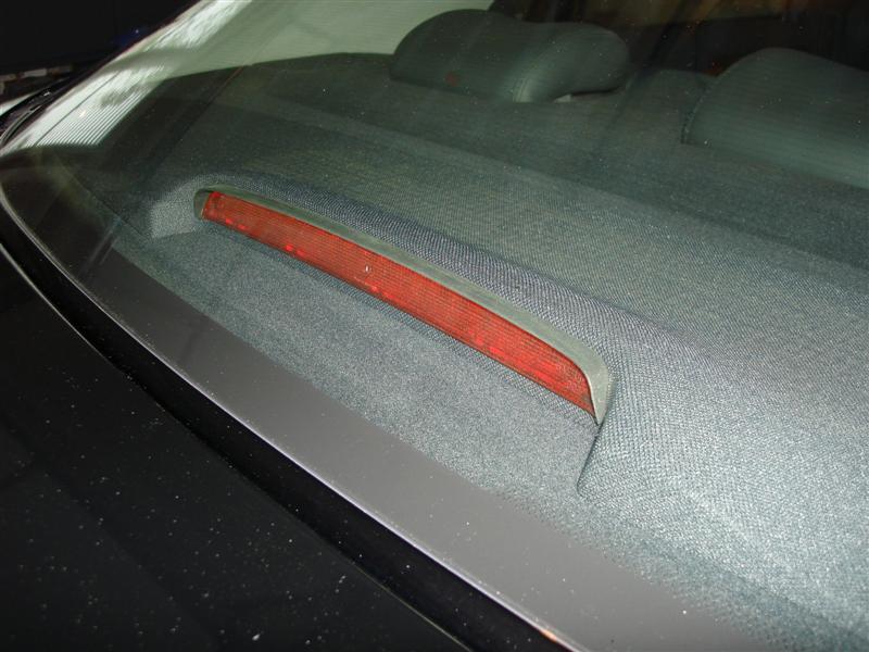

Got it... just put a flat head under it snaps right out... look at how clean it is now...

Good Job!! Where did you put the flat head to pop it out?

Just put it between the rear shelf and that thing with the tail light in it. You probably dont even need a screw driver, you can pull it up with your fingers from the edges.
