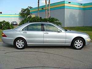

Quick question, I am taking a road trip to New York and I will be switching to the stock OEM 16 wheels what is the correct lug bolt size for these wheels? MY 20's take a much shorter bolt that dont work. Please advise thanks.
