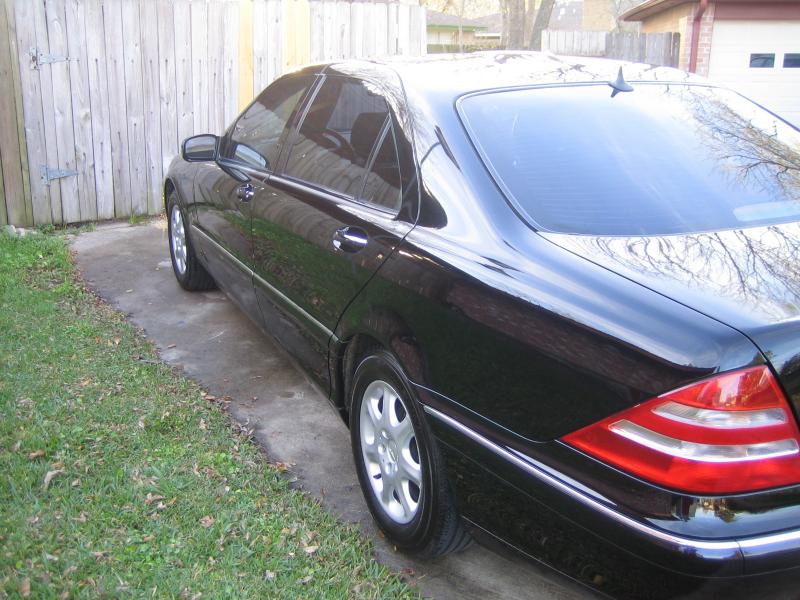

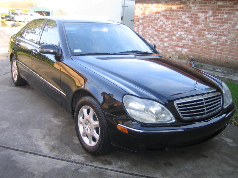

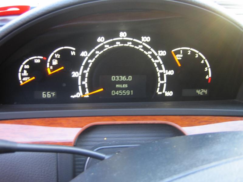

Update
Hey guys, I have an update. I had my gauge cluster go out on the ride. I took it into Alex Rodriguez Mercedes in South Houston and they replaced it free of charge. They also replaced 4 other recalled items all free of charge!
- trunk battery static insulation
- harmonic balance
- blower motor harness
- door seal strips
my next task is installing a ipod kit or going with an after market head unit. I'm also looking into getting some rims.
Here are some pics of the car. I bought it back in November for 6.5k. I just rolled 50k.

Each of the item was a "program" or a recall, except for the instrument cluster (which is on a 10 year extended warranty, from date of initial service). If you, or prior owners did not get them taken care of when they first came out, you should be able the have the items inspected and if necessary, replaced free.
It's one of the advantages of having your car serviced at an authorized dealer; they know to look for such things.
