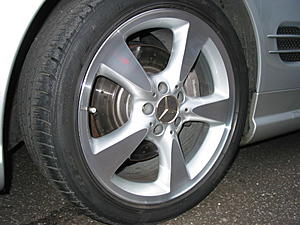

Thats exactly wht you do. I had the same issue..
sand the rust a little apply primer, then pain whatever color you want. I had a can of ceramic Red open at the time as I was doing my calipers so mine got red.FWIW black of gray/silver is better.
mine looked the same as your after a few weeks I couldn't stand it anymore. but its much cheaper to paint them yourself than to order precoated. I did my rears also.

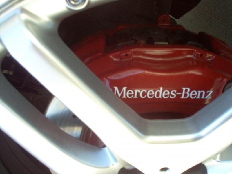

do not know what paints you have over there but we have one called Hammerite, and you can paint it on rust,, the other way is to lightly sand the rotor clean and use an exhaust high temp paint.. Do not go near it with WD40
The one in the pic is high temp paint been on 2 years now, when you spray it you can wipe it off the rotor face with petrol / thinners
